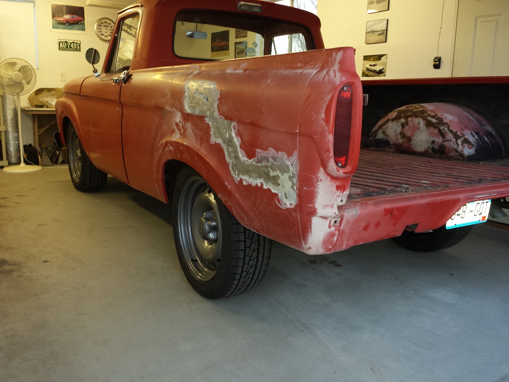

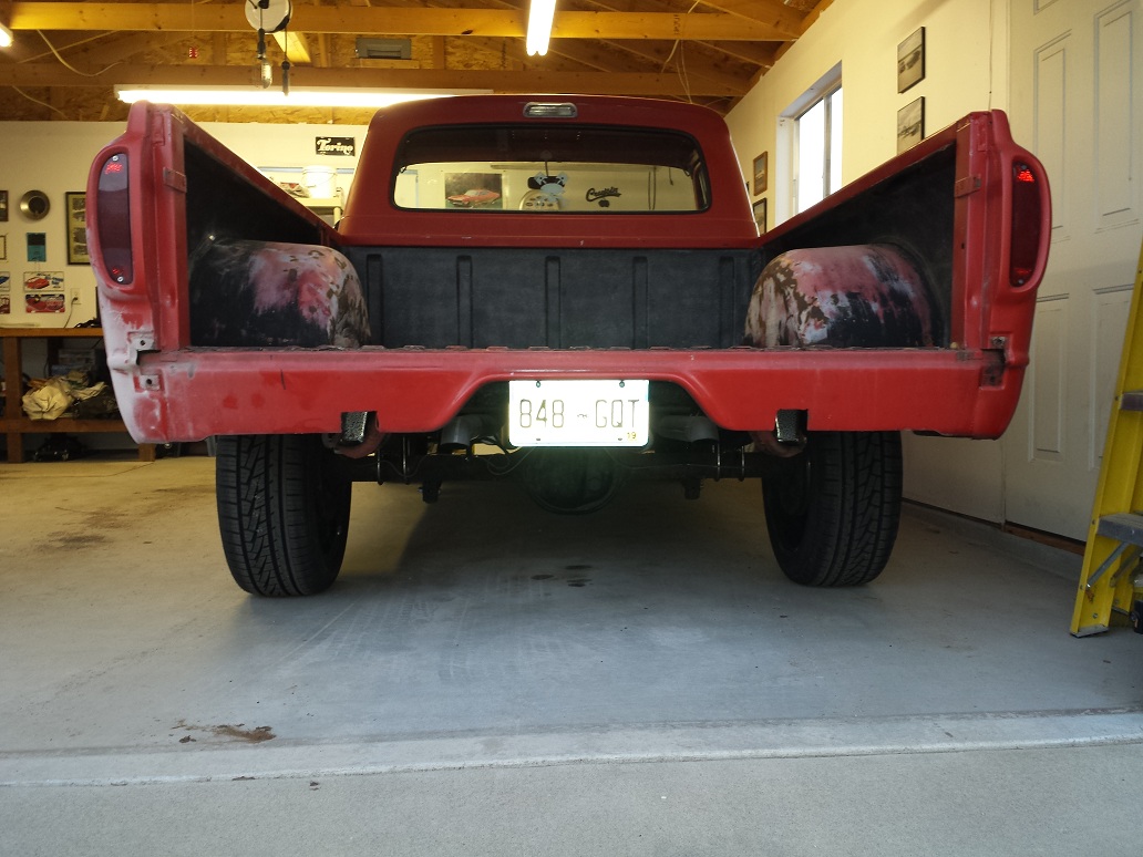

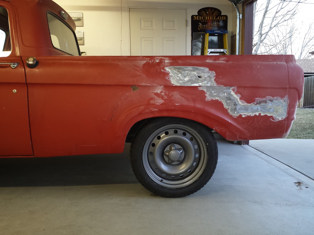

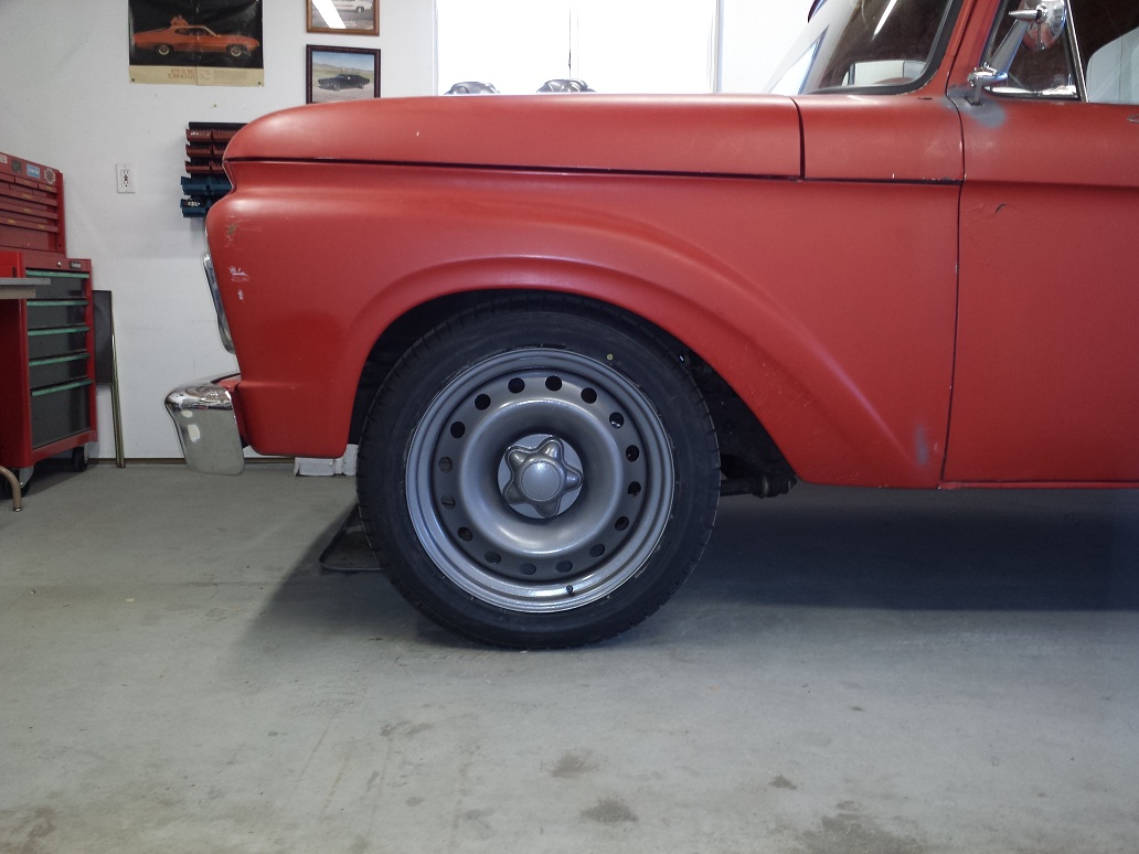

Hello all,
I have been seeing a lot of information being posted on a lot of different websites concerning the use of 20" dodge Ram 1500 spares on other trucks. The question asked most is...will they fit. Well I just completed installing a set of four on my 62 uni, I must say for the money it takes for the conversion is less than half of what the Taiwan 20" blings cost. Here is a breakdown of what I used and the associated costs.
OEM Dodge steel wheels, 20x8" (4) .....................................320.00
Tires Falken 245/50/20 (4)..................................................623.00
2" Billet spacers (rear)........................................................65.00
1/4" Dorman spacers (front).................................................18.00
Dorman Cap retaining lugs, 1/2 20 3/4" hex (20).....................17.00
Ford F-100 1997-2003 Center caps (4)...................................30.00
Paint................................................................................10.00
The wheels were purchased from Harris Used Truck Parts in Colorado Springs Colorado, as of a couple of months ago he had several sets of the OEM wheels.
Tires from Discount.
The spacers as well as the cap retaining lugs I bought off of ebay, cant remember the vendor.
Center caps I bought off Craigslist locally.
Modifications:
2" rear spacers have to be used to center the wheel in the well so it wont rub on the leafs.
1/4" spacers have to be run up front because the bore on the dodge is 77.8mm and the hub on the 62 is 87mm.
The later model lugs with the cap retaining ring have to be used so the cap will have something to snap to. If you go with these caps you will have to grind off the plasic jug guides and bend the metal tabs open a little more.
So as you can see the whole project can be done for a little over 1k.
I plan on lowering the rear about an inch and the front about 3 inches to get the look im after.
Thanks

Any rubbing issues once you mounted the rear spacers? How about a pic from the rear showing how the sit in the fender wells? Thanks again.

No rubbing issues at all, the 2" spacer centered the wheel in the well perfectly.
