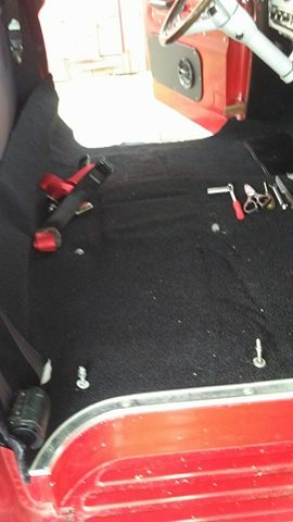

Carpet installation.
Removed seats, center console, seat-belts, etc. and vacuumed thoroughly...
Set the new carpet in and lined everything up
Blurry Image...but looks good
Got the passenger side trimmed, seat bolts lined up and the chrome edge strip in place
I had removed the gas tank to under the bed; here's what I did behind my seats, a piece of 1/8" plywood covered with Walmart black vinyl and I used the gas tank bolts to hold it in place.
I set the passenger seat in and tightened it down...ran out of time today....

Looks great Steve, we are thinking about buying carpet like you did for the '65 (from the same people), the price is really good but I'm curious about the carpet does it have jute on the underside like some carpet does? I'd be interested in hearing what you think about the quality after you get it installed.
Jon
Jon
Jon, the carpet is high quality, there is some backing across the middle of the carpet, but it does not cover the entire back. I don't know if it is jute, but it is thick and gray colored. The fit is like a glove, I was really impressed with how well it fit and there was several inches of extra carpet all of the way around. I was able to tuck it way up under the dash and had about 4-5 inches extra at the sides and back that needed trimming. I am going to finish the installation sometime today as it is already 60 degrees here this a.m.
Thanks Steve....carpet ordered, I like the fact that it fits the entire floor and doesn't just stop at the seat, the excess will make for a nice custom install.

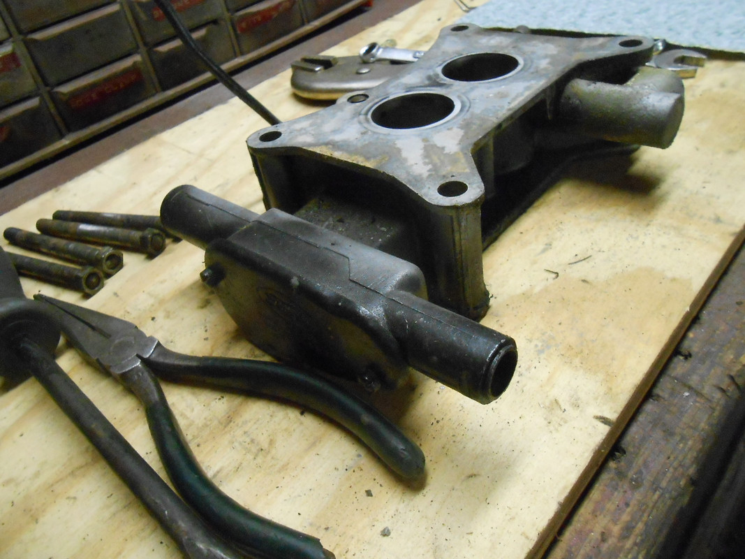

Rebuilt the carb. Discovered from the tag on the carburetor that it is a '66 carb. It had an inch and a half thick, weird looking, aluminum spacer under the carburetor. Below is a picture of it (I'm surprised that I could post a pic!)....anyway, removed the weird spacer and it turned out to be a velocity governor. They installed these on 'medium duty' trucks in the '60's, as I understand. Someone at sometime undoubtedly needed to replace the carb and put this on the truck. I do not think that it was original to the truck...as per the little aluminum identification tag. So, I tossed the velocity governor and fabricated a 3/4" spacer, rebuilt the carb and it runs like a top. I have been disappointed with the performance of the 292 in my truck. I now believe that this governor device was robbing me of power and the gas mileage was horrendous (10-12 mpg). I've only had opportunity to drive it about 5 miles so far....so we'll see.
Interesting, I never ran across one of these. Found the following on another board when I searched, easy to see why a 50 year old governor could be hurting performance.
Ford used three different style governors on their truck engines, velocity, vacuum and mechanical. It sounds like you have a velocity governor, that's probably the most common one.
Here's what Ford's shop manual says about the velocity governor:
"The velocity governor is a single unit mounted between the carburetor and intake manifold. There is no provision for repair of this governor. It should be replaced when damaged.
The governor is operated by a combination of manifold vacuum and air flow past the governor valves. The governor throttle valves are offset in throttle bores so that the combined force of the manifold vacuum and the fuel/airflow through the bores has a greater effect on the larger, upstream area of the valves. This forces the throttle valves to move toward the closed position restricting the fuel/air flow. The closing action of the throttle valves is opposed by the control spring. The control spring is attached to the throttle shaft cam. The cam provides a balance between the closing action of the throttle valves and the action of the control spring at all engine speeds.
Under operating conditions, the governor throttle valves do not close, but remain open enough to allow the required quantity of fuel-air mixture to flow into the intake manifold to maintain the governed engine speed.
To maintain the proper vacuum to the distributor, the governor has two interconnected vacuum transfer ports and a vacuum transfer plunger. When the governor throttle valves are forced towards the closed position, vacuum from the lower port is supplied to the distributor to maintain sufficient spark advance. When the governor throttle valves are open wide enough, the plunger shuts off the bottom port and the top port supplies vacuum to the carburetor distributor vacuum passage for sufficient vacuum to the distributor."
It then goes on to give the speed adjustment procedure.
So, bottom line is, air flow velocity through the carb is the signal for the governor.

Turns out that I overtightened the carburetor bolts. One of the mounting ears on the base of the carb had broken off. Drove 45 minutes today to get a free (used) carb from the guy that towed me home. Turned out to be an unuseable carb also...

Update....it's been two weeks today...since my truck quit running. Comedy of errors...and perhaps a lack of maintenance on my part. The carburetor base that was made of MDF warped and broke the ear off of my carb. Ordered another carb off of ebay...rechecked points, replaced the AdvanceAuto Chinese condenser, distributor cap and rotor button. Then new plugs...would not crank or stay running. Replaced the coil and bingo...it started! Ran okay, but still having problems getting the idle correct and it floods easy. I did drive it down the road and back...clenching the whole way waiting for it to break down on me again. It ran great! Had so much more power...but, the carb is not right. Soooo....I did what I should have done at the beginning...bought a brand new carburetor today. It will be here Tuesday and we will see. I have exhaust welded up and ready to install on the truck and some other things I want to do...

New carburetor installed late this afternoon. Initial thoughts...it's great! Fantastic! My 292 has new life...and lots more power. I had no idea that the velocity governor was choking the power from the engine. Lesson learned. Tomorrow I will install new Accel #4040 8mm ignition wires and give it an oil change. If time allows, I will also adjust the valves. I have a nice set of 2 1/2" pipes with tips welded up to add to the exhaust which will then exit right in front of the rear tires. Maintenance, maintenance, maintenance....it's always been important to me. I let myself get to busy last year with other things and didn't take the needed time for my old truck. I've also "staked" off my backyard for a new 24x24 garage...construction to begin in the next week or so...
