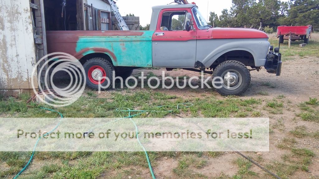

its on
its staying on
truck cab corners took a little beating getting it on, but they can t ever be seen
pretty level, no bolts just some punches and screwdrivers aligning the holes
now for the big fun of welding bodywork and completing this
oh i got the trailer too

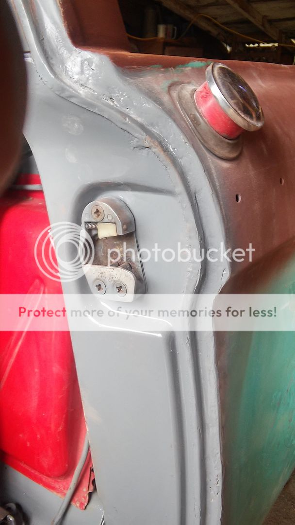

Your truck is looking great Brian. I have a question. How did you attach the rear cab corners(the whole cab corner of your regular cab) to your uni bed? The uni just has a small square of metal as an attachment to the rocker panel where the regular cab had the entire corner. Did they directly fit against each other or did you have to remove some metal first? I am still trying to get mine done as well and might install my big window in it later. Glad to see that you are getting yours finished. Lewis
Re: the seriousness of slickitis, uni conversion new pics 6
Lewis
the uni corner is square so the regular curved corner is inside, if you looked in the gas tank hole you can see the rounded corner
underneath the cab corner tails hang down, but im thinking of removing them and using a 4" wide plate over the bottom where they join up just to keep water and anything else getting between the 2 layers of metal ( the back of cab and front of bed)

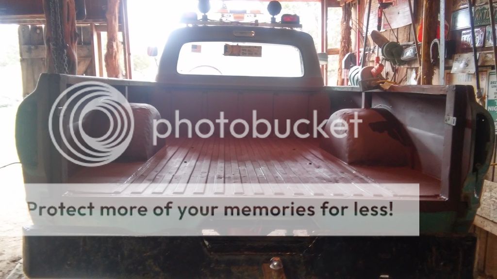

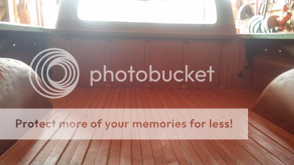

today the inside of the bed got a nice coat of rustoleum rusty metal primer
now i can really see all the dents from the po throwing steel in it for 25 years :cussing:
not too worried the other bed had them too though not nearly as many
not going to spend all year doing bodywork on it, for now as long as its not rusting im good

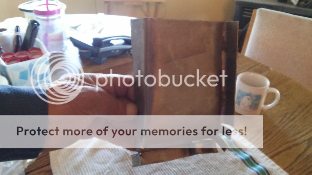

this part took a while
still need some cleanup around the edges but i had the paint out from painting behind the tank

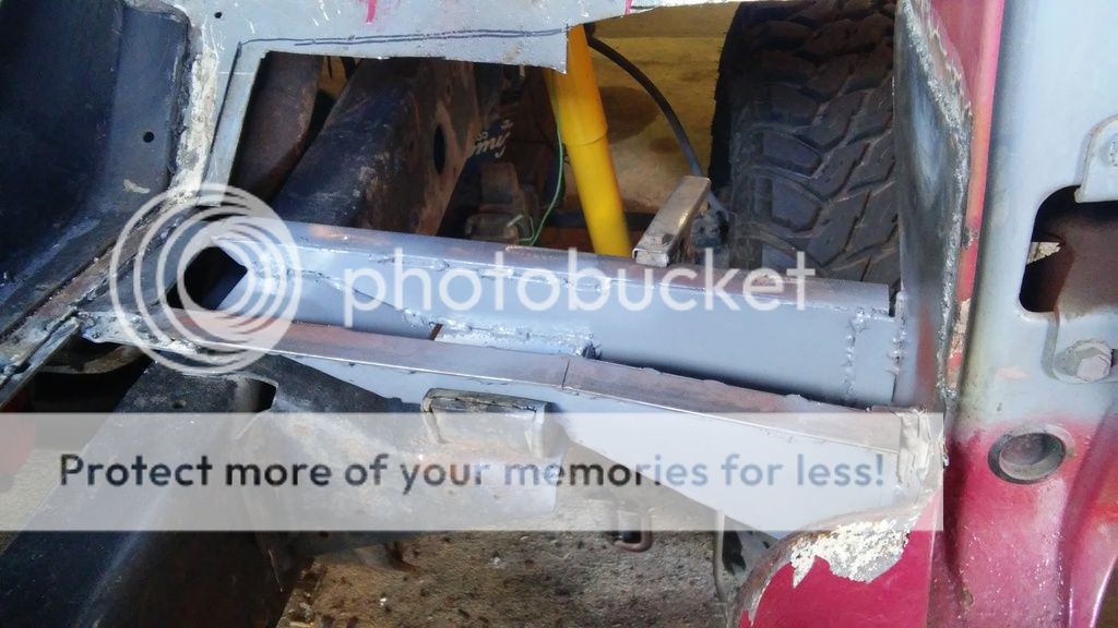

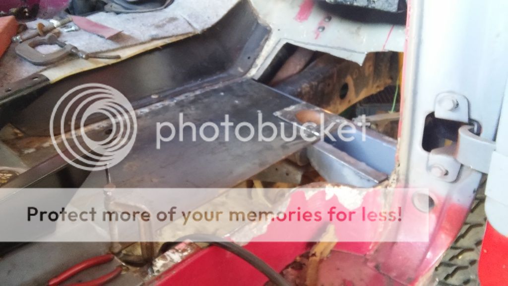

so building new cab mounts and floor with 1\8" plate and fixing the other holes with standard thicness
couple views of the cab mount
one with the 1st floor piece in place
probably going to be several weeks on this

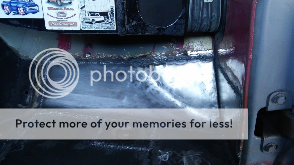

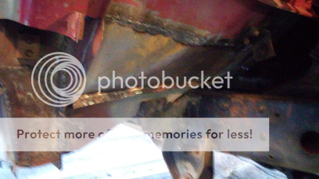

Re: the seriousness of slickitis, uni conversion new pics 9
1\8" plate floor, standard thickness on the firewall
pic is blurry, have to have a word with the photographer i think :lol:

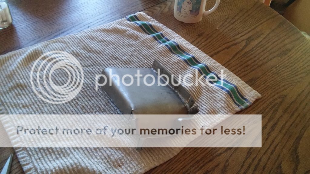

piece i made for the cowl drain area,
