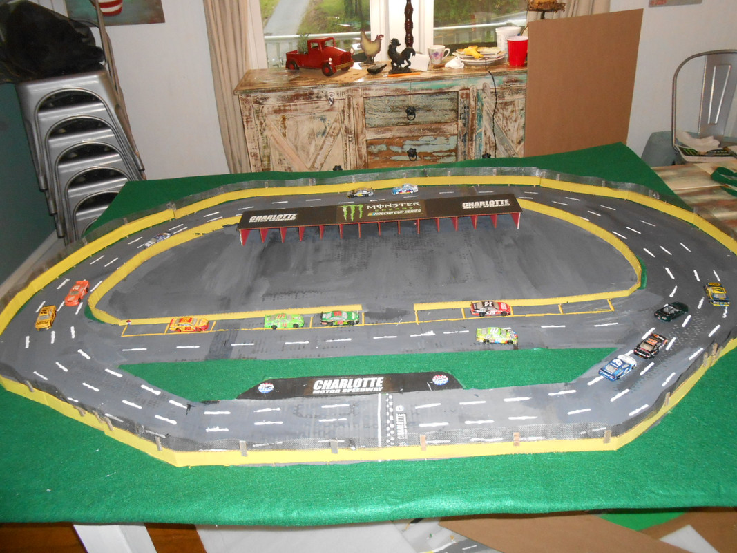

This is what my 15 year old grandson, Zack, (and I) have been working on this week....a replica of Charlotte Motor Speedway. From cardboard....
He also did a "stop motion" video of the cars racing around the track...

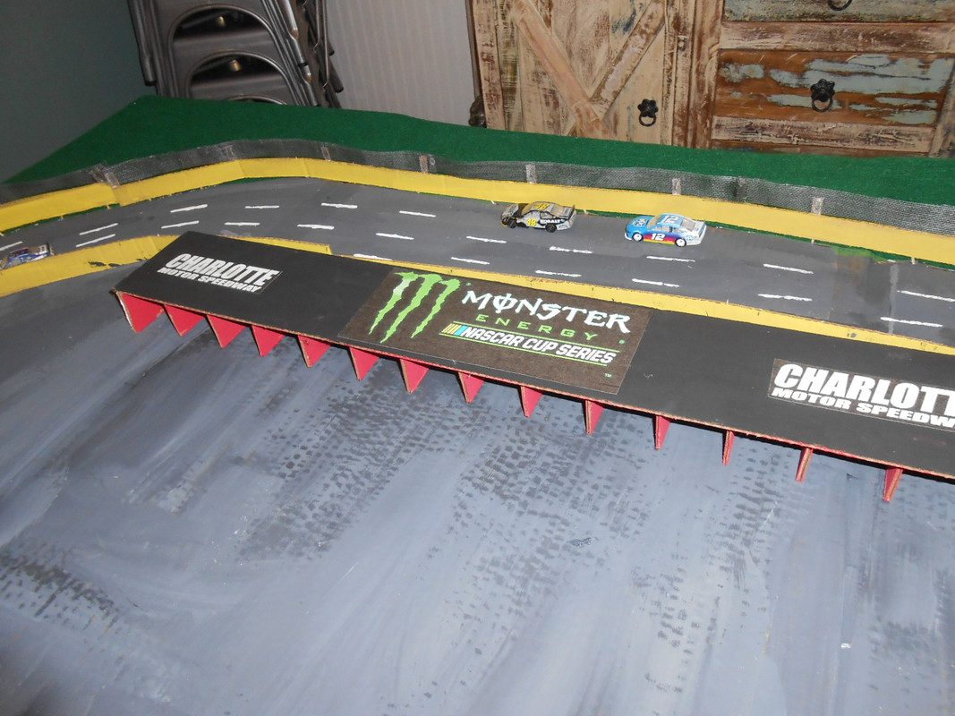

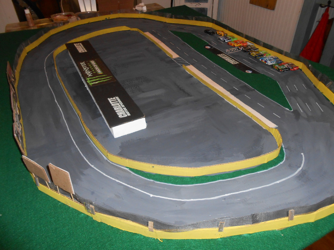

We redid some stuff on the Nascar track...
We straightened some lines...added grass....and some signage on the backstretch....

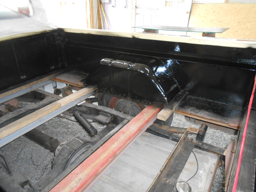

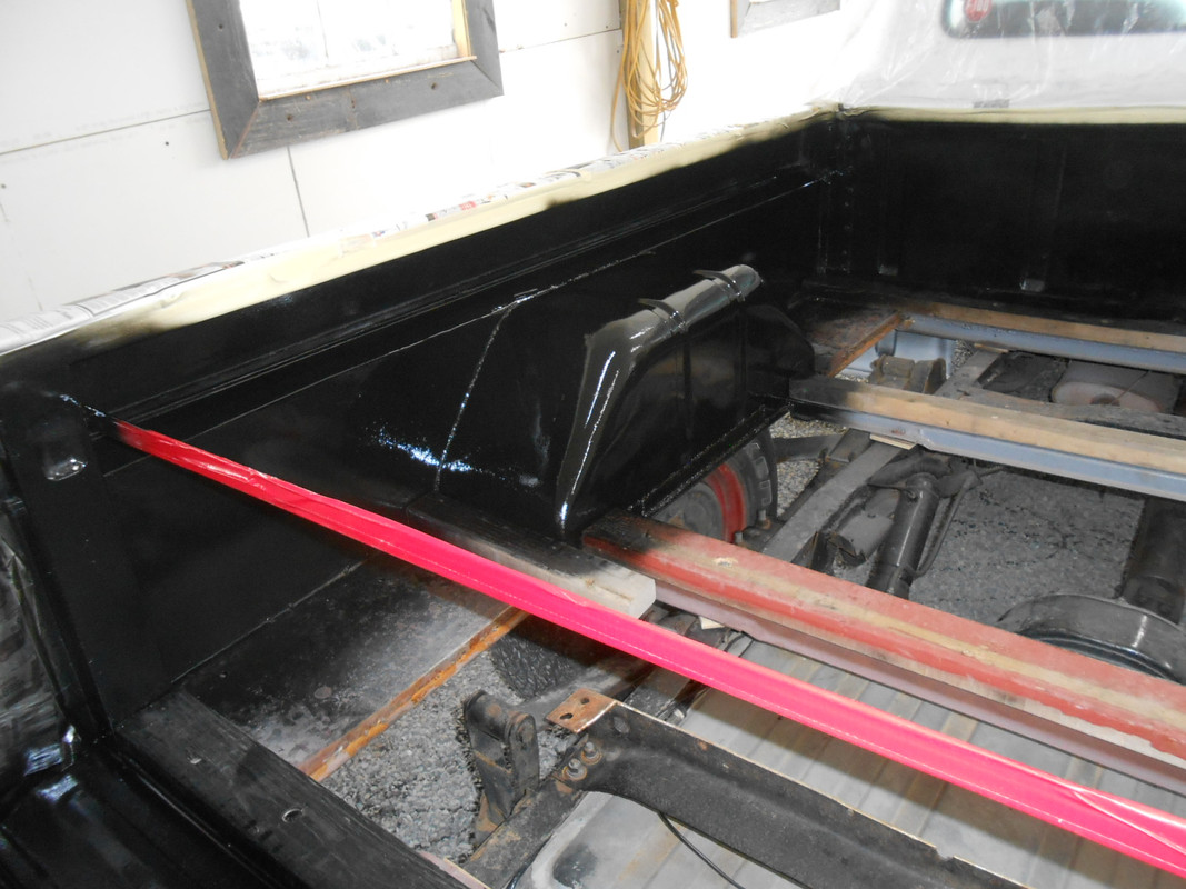

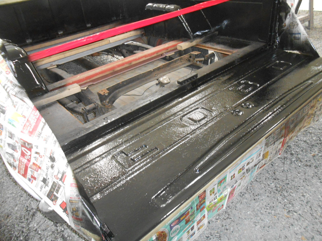

I got busy yesterday evening and today. Shot some black on the inner bedsides and inner tailgate. I purchased some items to make a tonneau cover for the bed. I'll post on that as I build it if anyone is interested. The cost is coming in at less than $100. I spent $70 at Lowes today for aluminum channel and and a hinge and some OSB. I have to pick up some heavy vinyl to cover it with...

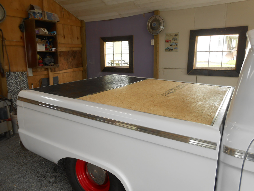

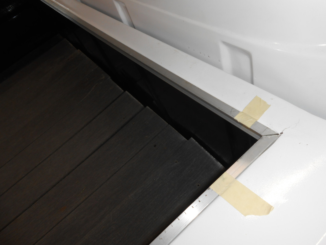

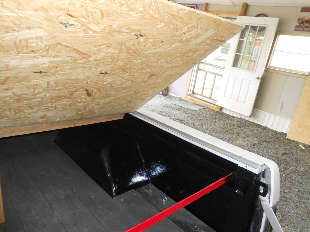

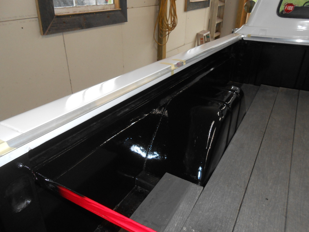

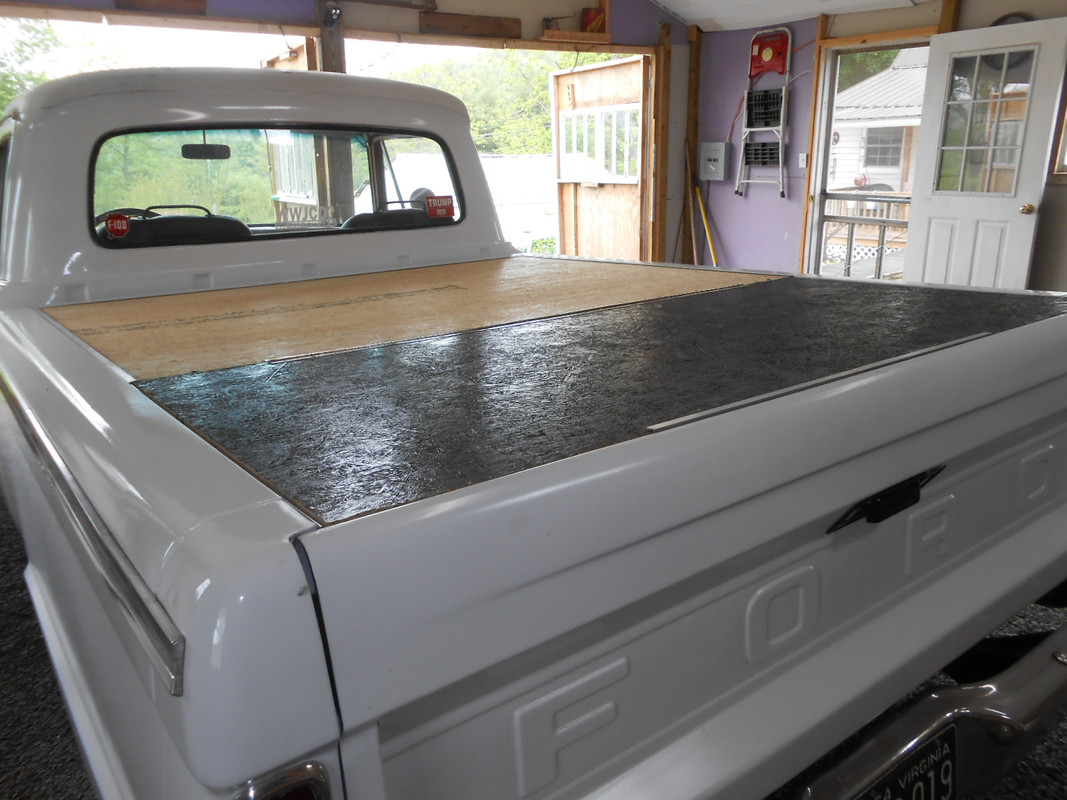

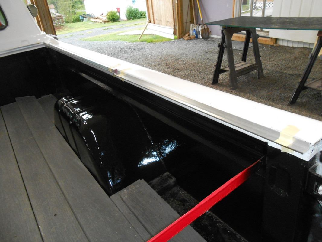

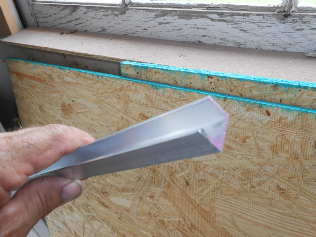

Good Idea! I shot some black paint on the OSB to see how it would look....which I already knew, lol. Not good. Anyway, here's pics of the aluminum "frame" for the cover. I am going to slide the piece at the front of the bed into the channel and it will be fixed and held in place by the channel. The back 1/3 of the cover will be hinged and will lay on the L shaped aluminum. I will use 'barrel slide locks' to hold the back part closed. The cover will be flush with the top edge of the bed for a sleeker look. Here's the pics...

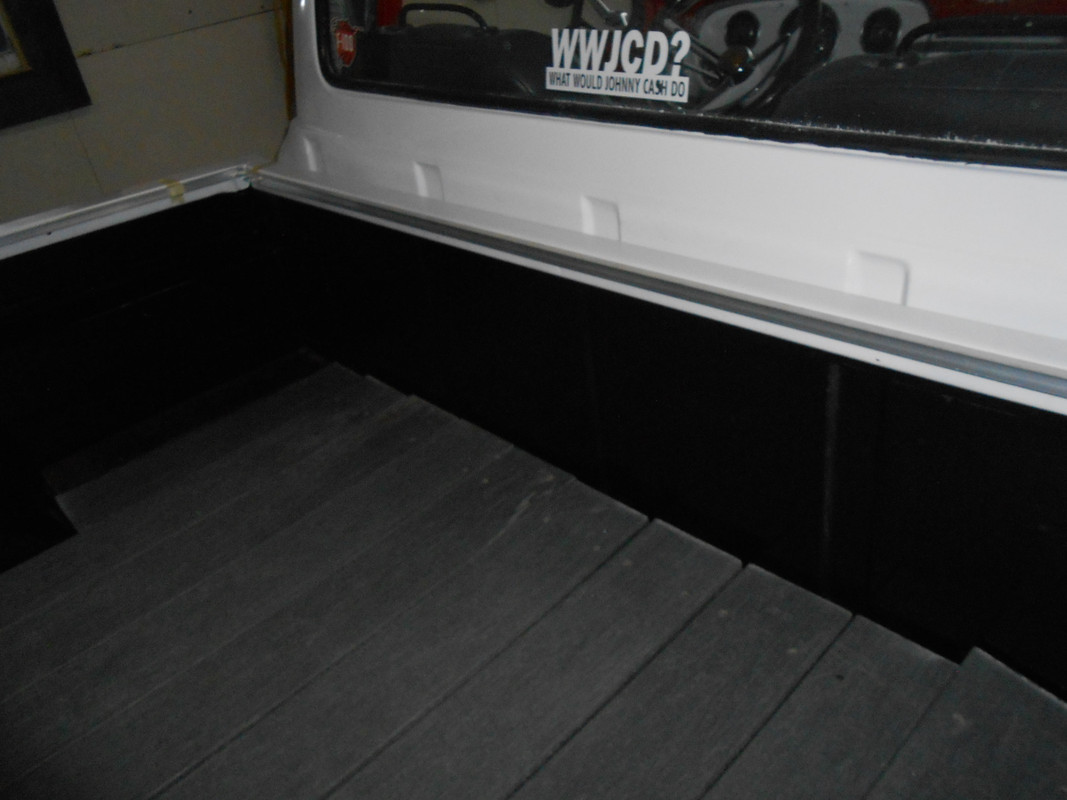

I'm letting the paint dry inside the bed and then tomorrow I will screw the decking boards down and start building the cover.
Stay tuned.....

I think you will need something to stiffen the plywood across the center or it will sag.
04sd wrote:I think you will need something to stiffen the plywood across the center or it will sag.
Yep....already thought of that....have a "plan"

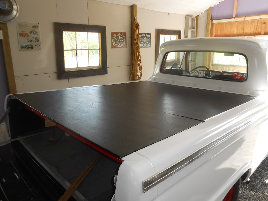

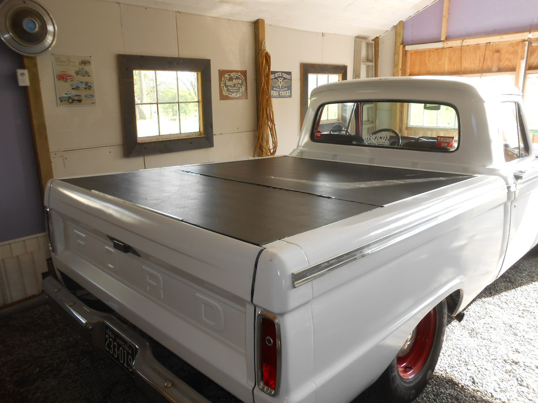

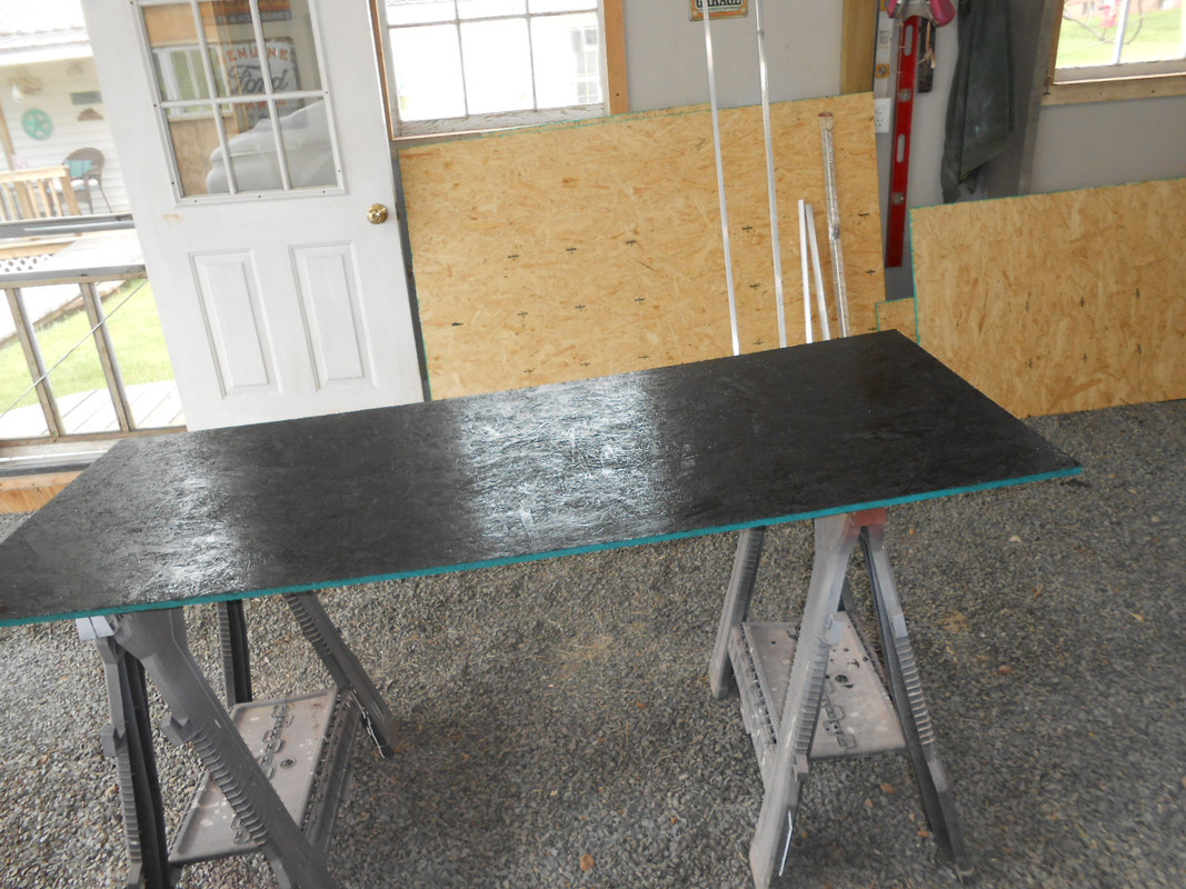

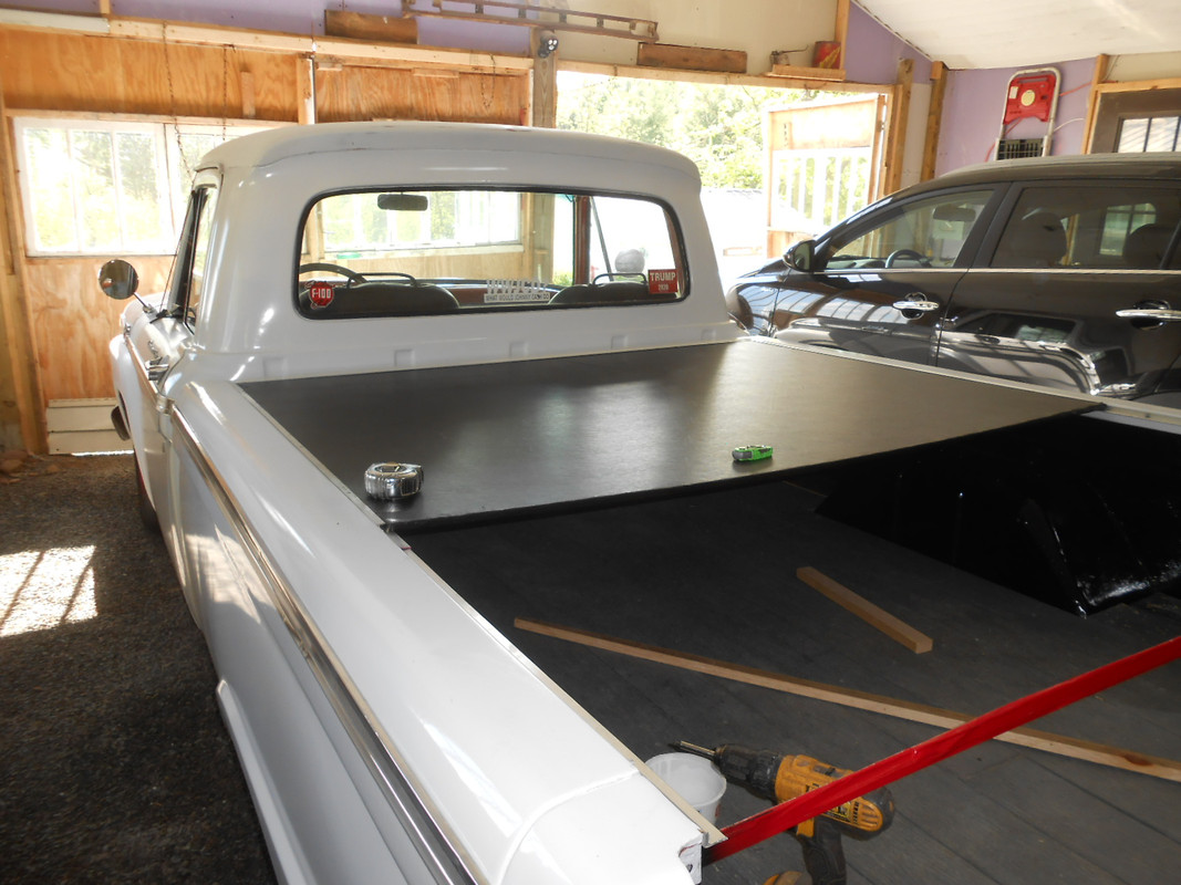

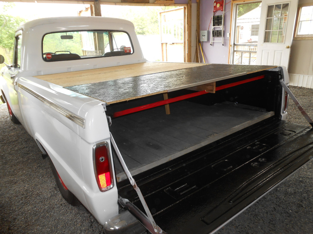

Tonneau Cover build...I'll just post pics....
It is NOT finished. I still need to acquire some aluminum channel for trim. I am also needing to cover it with vinyl. I painted the back part black just to get an idea of how it would look.
Stay tuned....

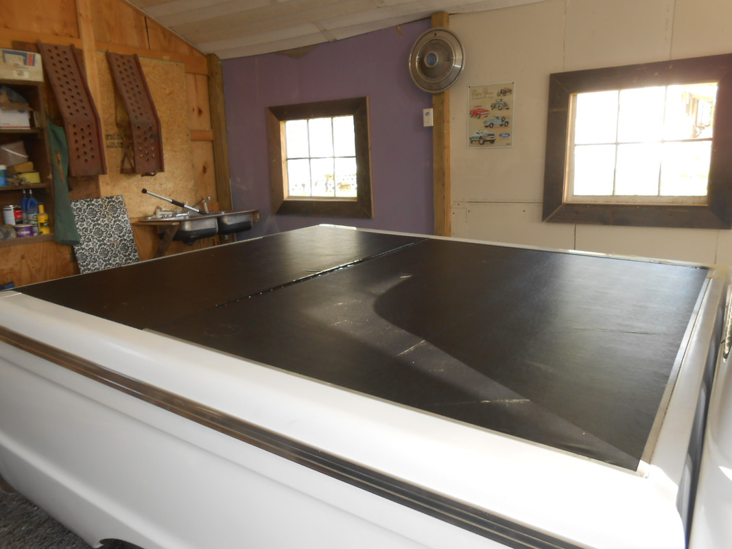

Thanks! It was fairly easy to construct...the only problem was that my bed was not perfectly square (go figure) so I has to trim the board a "tad" to get it to fit like I wanted. I'm hoping to purchase some black vinyl today to cover it. I also thought about covering the wood part with some thin (maybe 22 gauge) metal. Then I can paint it....

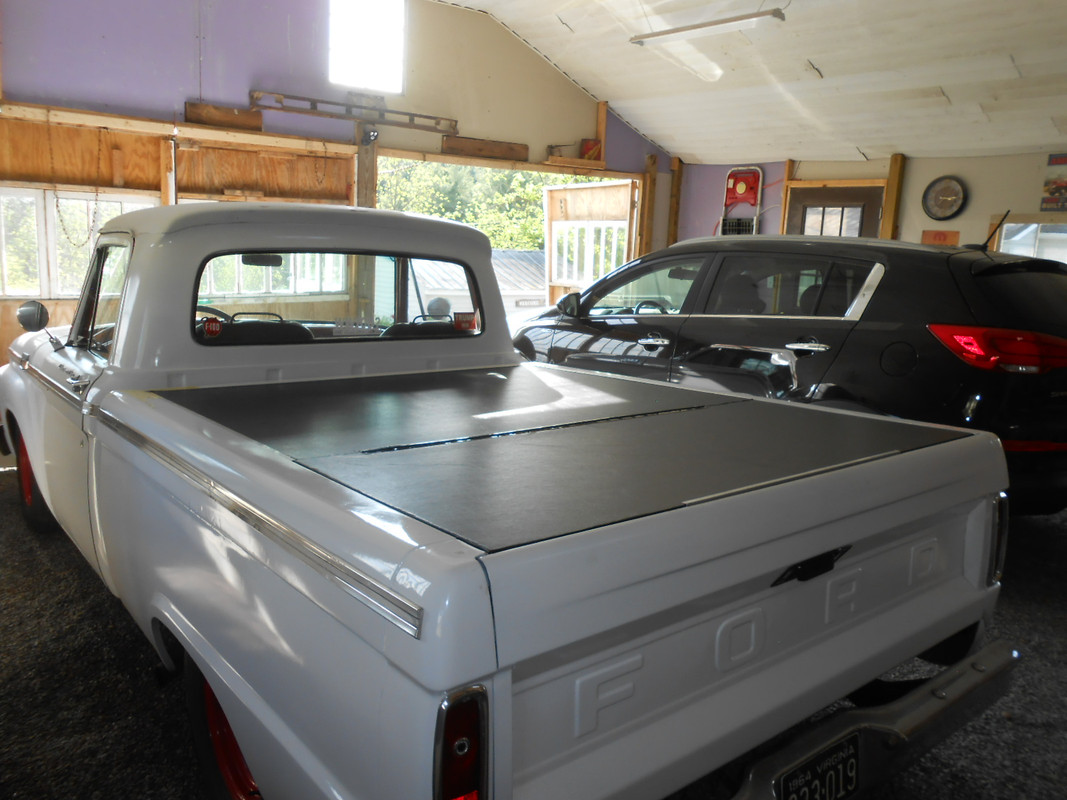

Here's the process...cover the large front piece in vinyl:
Install on the truck....
Cover the smaller back piece....forgot to take pic of this part...(but you get the idea, lol) Then set it on the truck...
Then paint the silver hinge....black rattle can...
Screw the hinge down...along with the "anti-sag" hardware that you can't see...
Stand back and enjoy....
I am going to buy a piece of c-channel for the back edge at the tailgate. I had a short piece left over that I stuck on there for the time being.
Stay tuned....

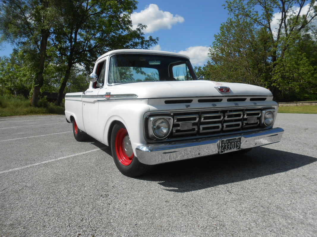

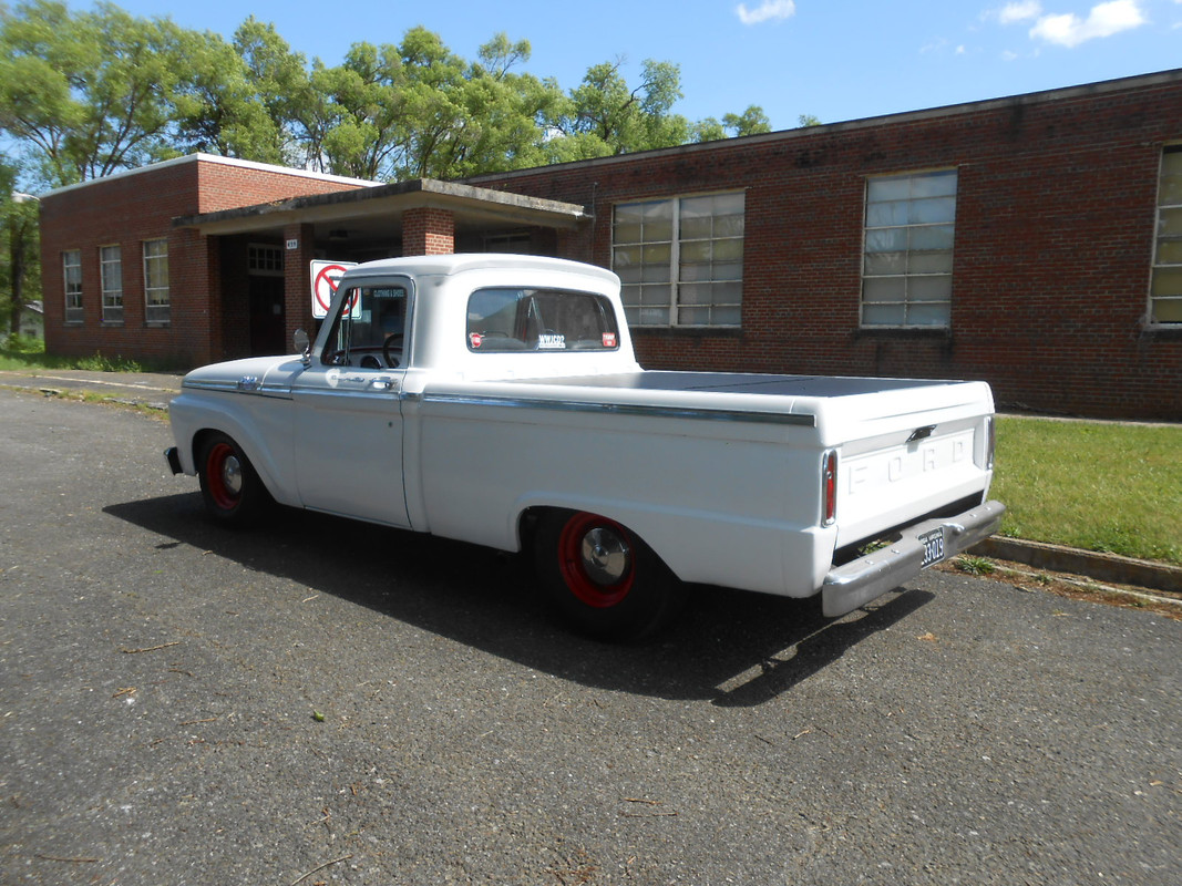

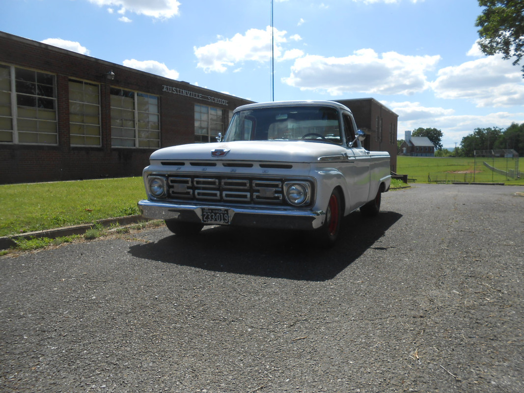

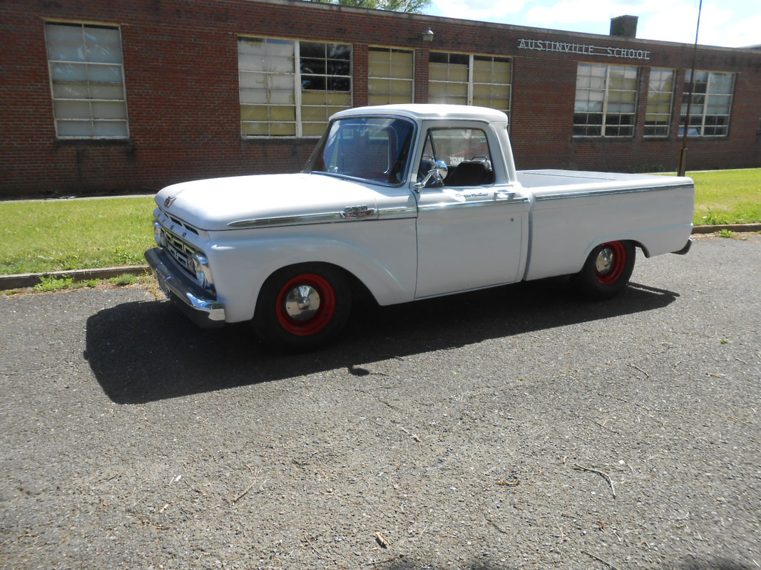

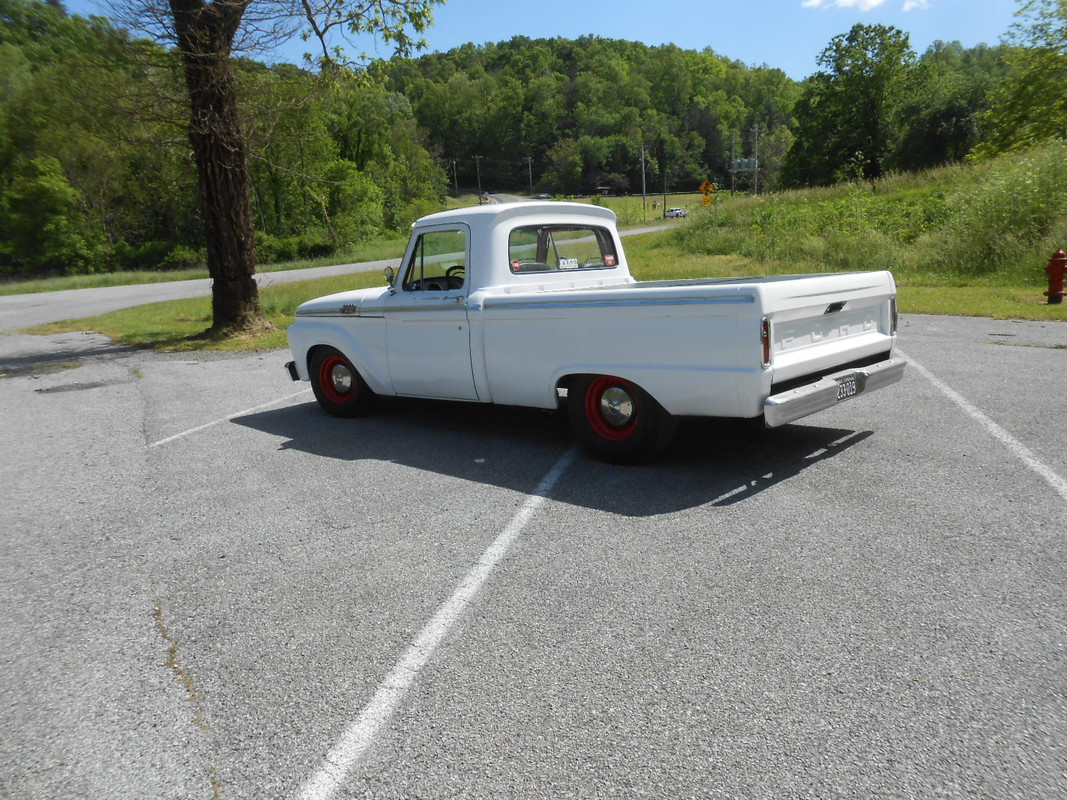

Masked and painted the truck this morning. I am happy with how it turned out. Took it out for a drive this afternoon....
It was a good day...
