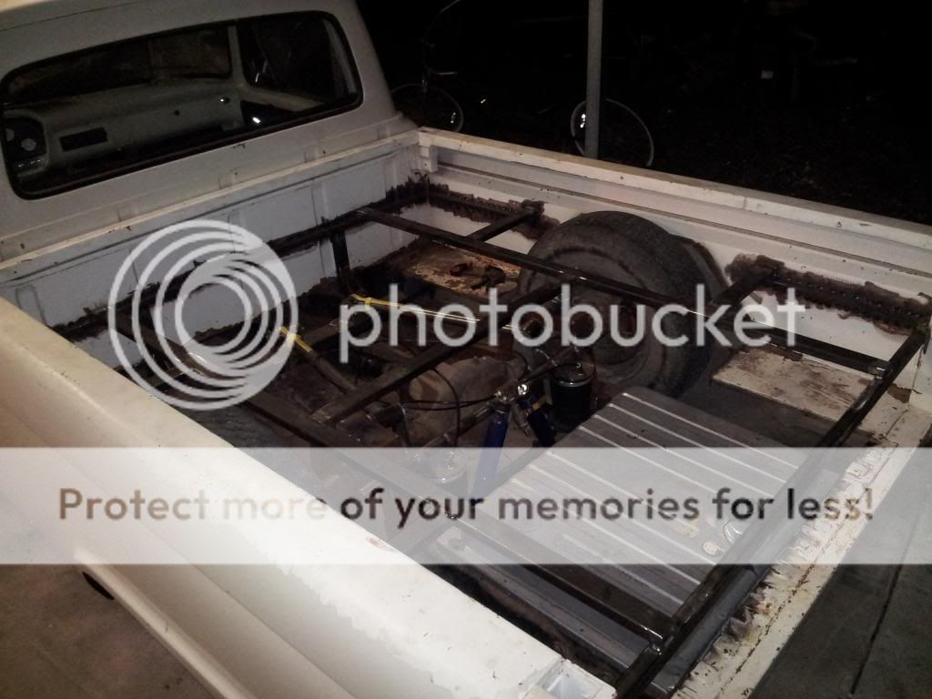

This has been a pretty productive day. I tacked in the tubing around the perimeter 2" up from the bottom lip. Then I cut pieces for the front and rear tubs. The frame rails measure 19 1/4 " in from the side so I put forward and rear braces in with that in mind offsetting them so not to be directly over the mount location. When the tubs are welded in I will cut pieces along them. I failed to mention that the tubing is schedule 40 square stock.
Finished welding the tube bottoms and stitch welded some of the side panels too .
