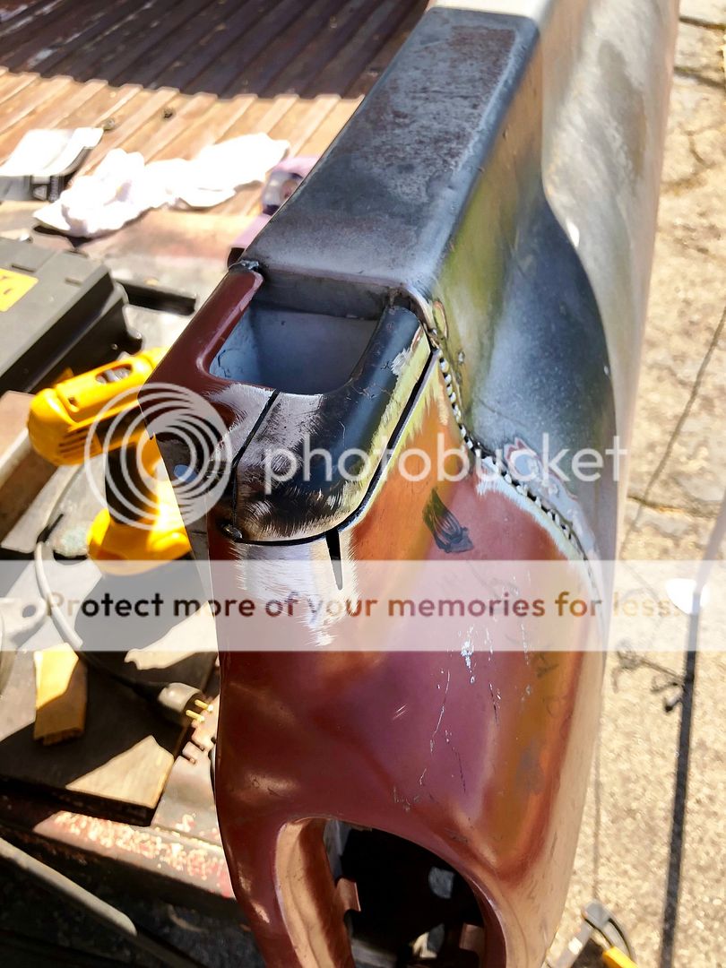

I cut the spot welds and removed the damaged bed corner.
The factory replacement corner doesn't fit exactly right so I'm going to modify it and see if I can get it to fit a little better.

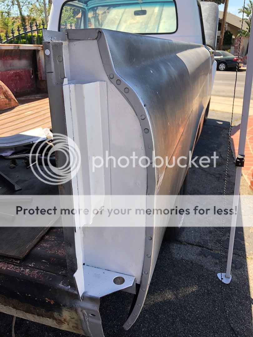

I got the area behind the bed corner cleaned and sealed. I used weld-through primer on the mating surfaces.
The replacement part didn't fit in a few places so I had to cut it and massage it a bit. I used part of the top outer edge of the old bed corner. I've got a bit of grinding to do. Got rid of the stake hole.

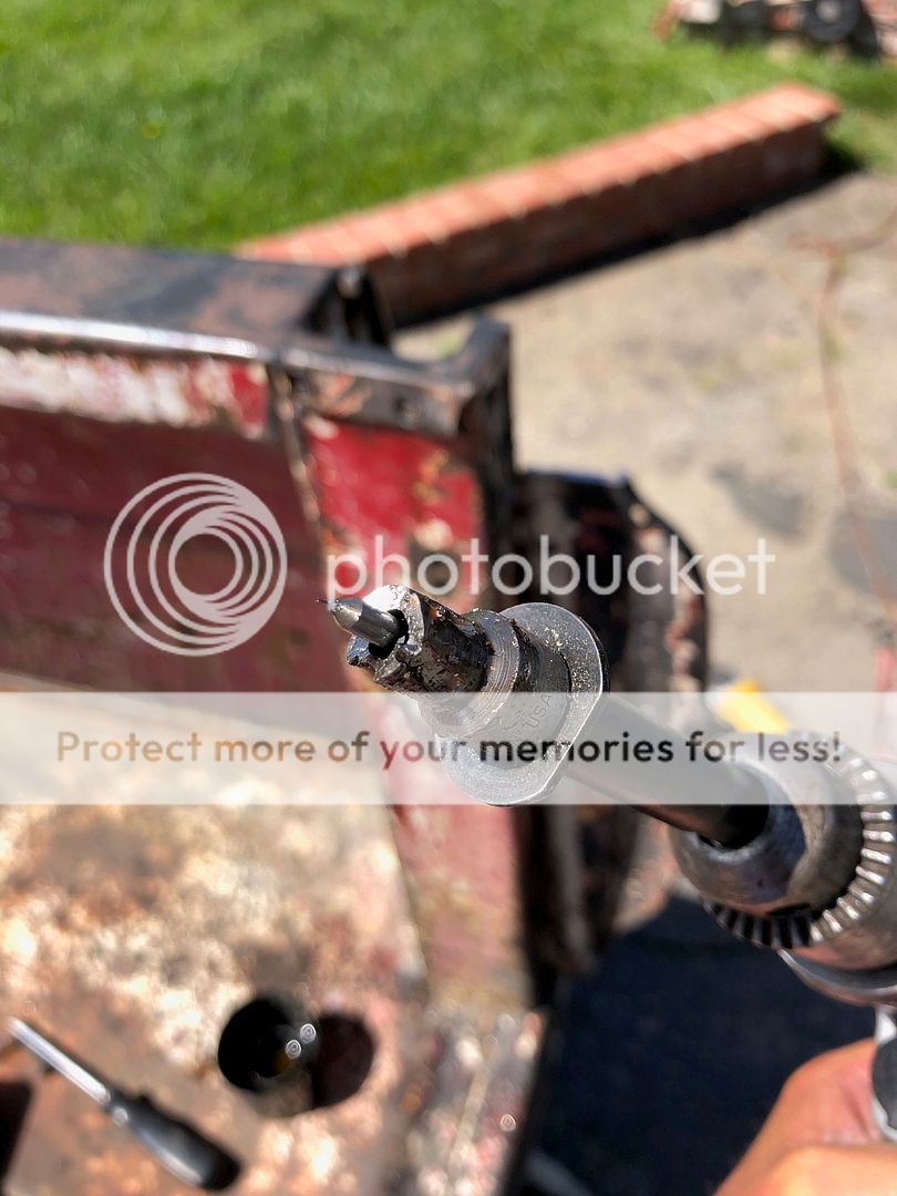

What brand spot weld cutter are you using? Look like a rota broach but never seen one with a center drill in it.

claybreaker 144 wrote:What brand spot weld cutter are you using? Look like a rota broach but never seen one with a center drill in it.
It’s not a drill, is a spring loaded centering pin. You first center punch the spot weld and then use the pin to guide the cutter. It’s Blue-Point. I like it, just gotta remember to use a little oil to save the cutter.

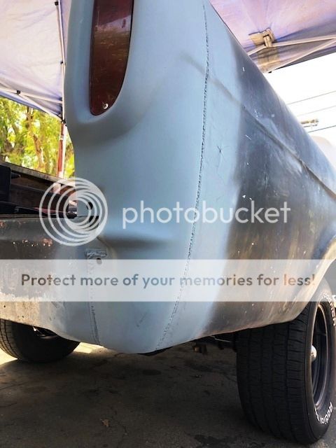

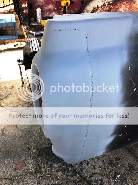

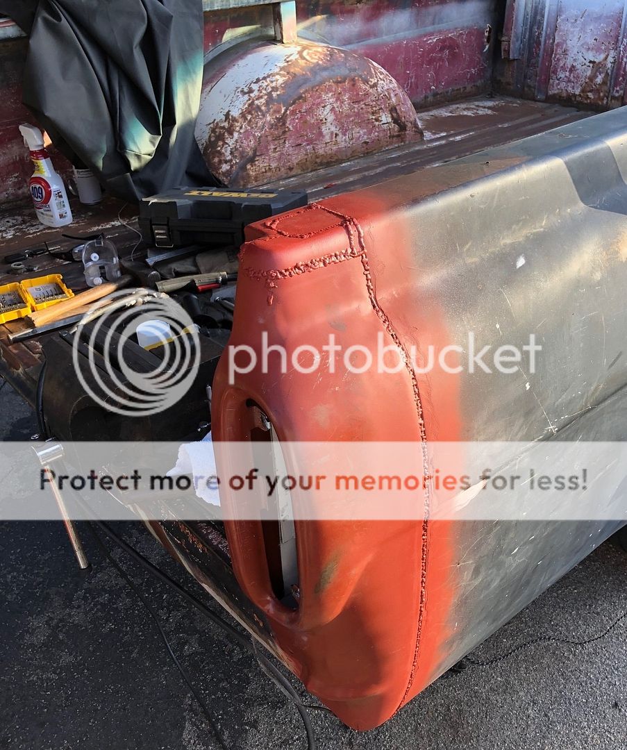

Did some grinding today. Got a little more grinding to go. It's at least closer to being able to be body worked. I welded in the other stake pockets, too.

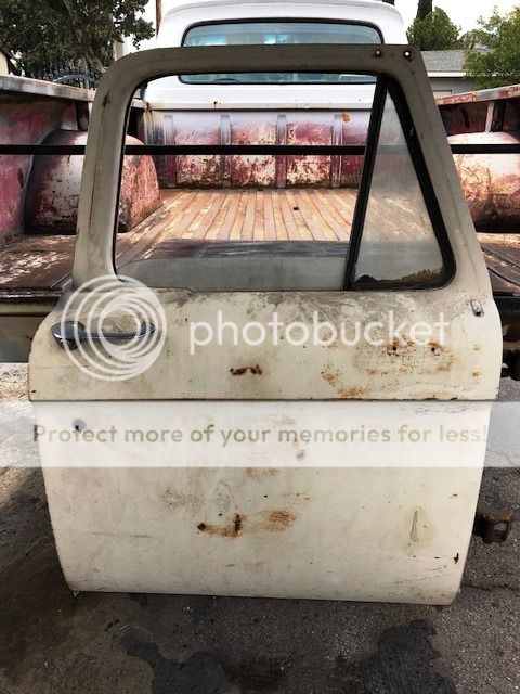

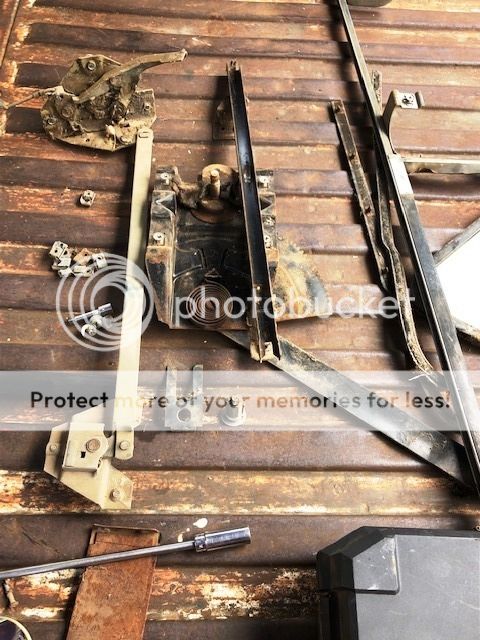

Someone cut speaker holes in my current doors so I have a nice set of straight, rust free replacement doors. Disassembled the right door today so I can weld up the mirror holes and send it off to the blaster. Meanwhile, I'll disassemble and service the window regulator and get the latch assembly cleaned up and lubed. I already have all of the weatherstrips and window liners (some of it NOS.) I think I have some NOS door handles, too.
