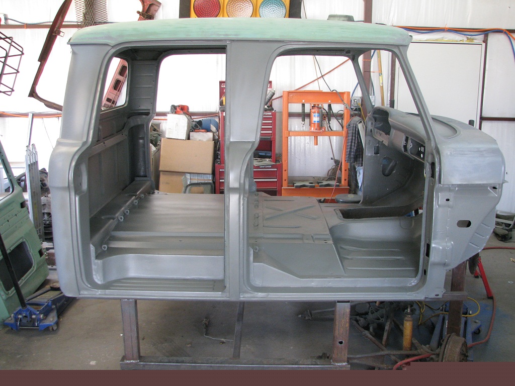

The first thing I needed to do was give her a bath. She had been sitting outside some but mostly stored inside. There was tree sap and just plain dirty after that long trip. So I used the starter to move it in and out of the shop. The 352 engine needed the carb rebuilt in order to run and I just didn’t even try to fire it up plus no radiator. I had to put both my trucks side be side and get some pics...
She cleaned up decent and now it was time to start taking it apart. After all I am taking it back down to bare metal.
First I wanted to see what color I wanted so I painted a test patch. “Bright Atlantic blue” is what I had around and I like that color.
Next I started stripping paint there sure is a lot of surface area to this truck. Of course I removed the glass and front clip before stripping the paint just to make it easier.
One side at a time I took my time and shook my head every time I would see the small rust fly with the sander. The good thing is it didn’t hurt the metal and was just surface rust, but it could have been worse in a couple years.

Next I removed the rest of the stuff from the dash lots of little parts and of course removed the old tired wire harness that had been hacked to death. Removed the pedal assembly and even the wiper motor, sanding under the dash was not fun but it two got done. I have pictures up for some of the removal but that’s where they stop for now. I need to update the web page to show how it looked inside the cab floor before and after.
My current status as of July 22 2009 is all but the very top and bottom of the cab is in epoxy primer. I still need to find the 351 FI engine that I will run in the truck so I can get it mocked up on the frame and get the frame down to the powder coaters. I also need to fix the back part of the frame and build it’s bumper. The frame had a small amount of damage because of the bumper, looks like they backed into something and it just bent some of the metal but nothing I can’t fix.
I will end this section with the following picture. This is the current picture on the truck. Look for more updates as I make progress. My plan is to drive this Crew Cab to Slick Stock 4….. August 2010…
