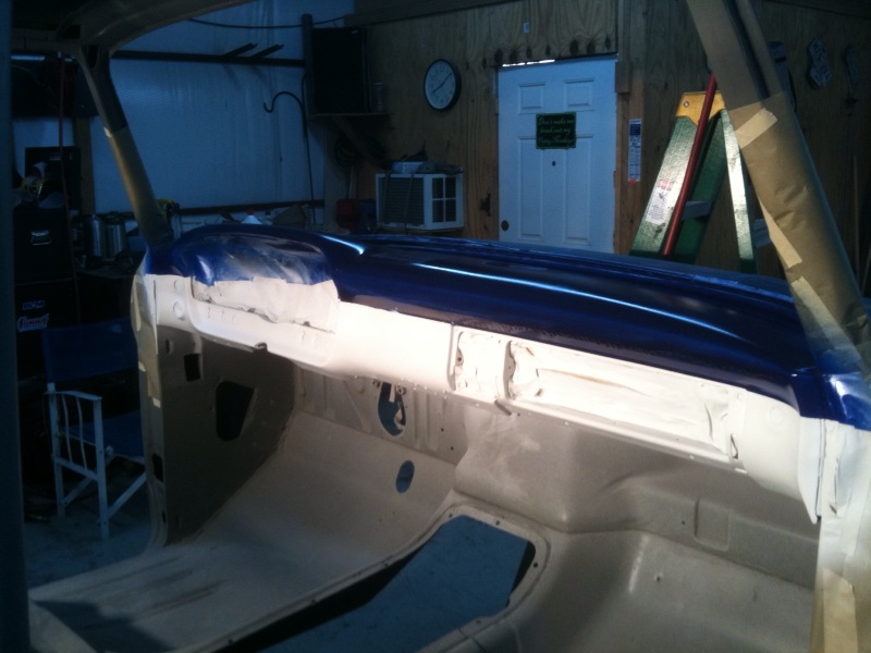

ezernut9mm - I actually sparyed some color last night, I didn't have the gun set correctly so I have just a few runs . Oh well that is why they invented sandpaper (At least that my story).. I was mostly a color test to see if this blue and white works. I'm thinking the blue is to dark for me but I will wait a week or so and see what I think. Of course this pic is the one from my Phone but I will get the better ones posted hopefully this week sometime.

Blue and white
Chris, I am betting that color is a lot lighter in the sunlight compared to what it appears like in the shade of the shop. I saw that place you shot just for fun a while back and it looked lighter. Unless you tricked me and bought some darker stuff, it ought to really pop in the sun. TR

Re: Blue and white
Truckrat wrote:Chris, I am betting that color is a lot lighter in the sunlight compared to what it appears like in the shade of the shop. I saw that place you shot just for fun a while back and it looked lighter. Unless you tricked me and bought some darker stuff, it ought to really pop in the sun. TR
Yea that spot I had painted early on was a lot lighter and a totaly different blue. I have since found that paint again and I did a test last night on the lasercut crew and it is night/day different.
I hope to get some sanding then repaint tonight on the dash. I will get a new pic up before the weekend Hopefully. I want to at least have that picture for smithville along with the lasercut....
Sorry to those who like this dark blue but it is not for me. Even in the sunlight it didn't lighten up it actually almost looks purple in direct sunlight.. Good thing I only bought a Pint of this color I guess I could use it else where you never know when you need paint....
Oh and yes this is that old test patch you were thinking about TR...

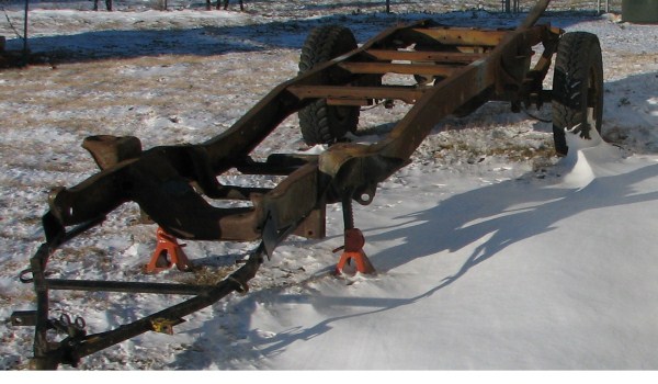

It has been a while since I updated my progress. I have done more work on the crew and not on the computer. Got 212 or less days now. So a short update for now.
The last few weekends I have been preping the frame for powder coating. Trying to make sure all is ready.
This was the first weekend of blasting. A very good friend Brian T came out and lended a hand. He just loved sifting the play sand (used that in addtion to. Not worth all that sifting lol)

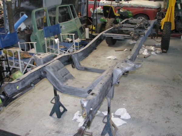

The finished product after this weekend blasting fun. I didn't have help this weekend sure wish I did but with Brian not having finger prints I guess he was out doing something

ICEMAN6166 wrote:whats that stuff that looks like green hair on the ground?
That's just good old winter weeds growing. It's been about 60-70 outside for a week or so and they just decied to pop up..

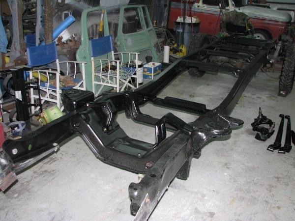

The Frame is back from being powder coated.
Now to get it back under the cab. Hopefully the cab mounts will come in today or tomorrow.
Before
After Blasting
Powder coated (a little dirty from drive howe)

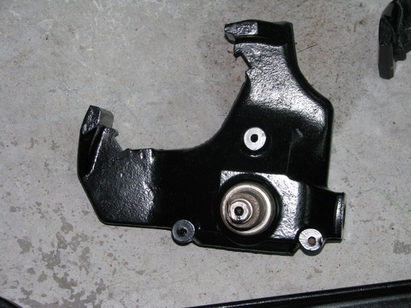

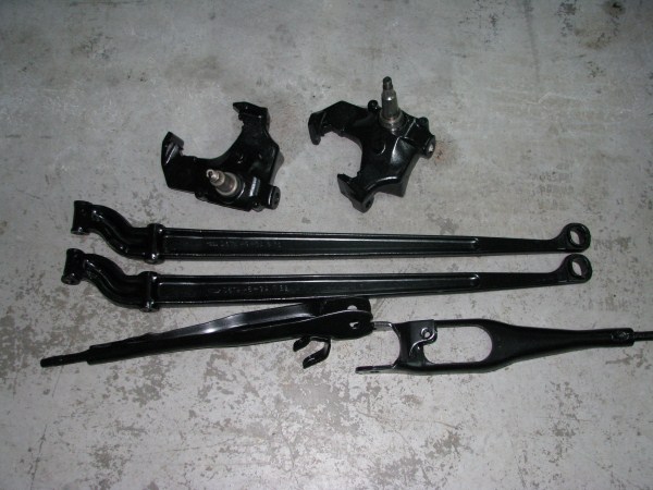

Front Suspenion parts
Spindles
Now to get this front stuff down to King Pin shop.

- Alan Mclennan
- Posts: 9324
Looking good Chris, don't be in too much of a hurry to put the cab back on, get all the lines and rear wiring done first, it`s easier to bend over the frame than to crawl under it!!!
