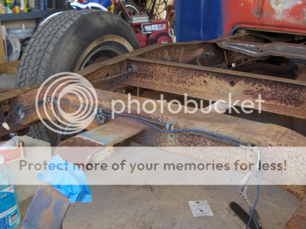

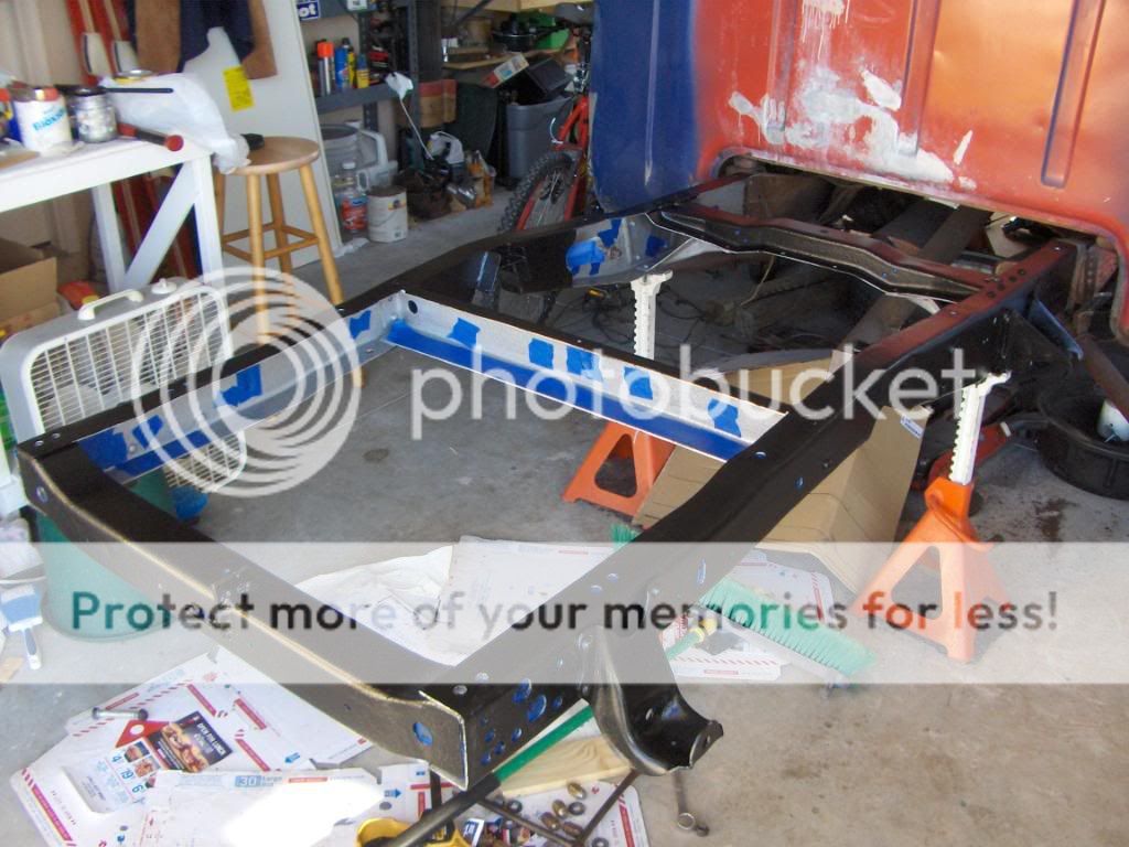

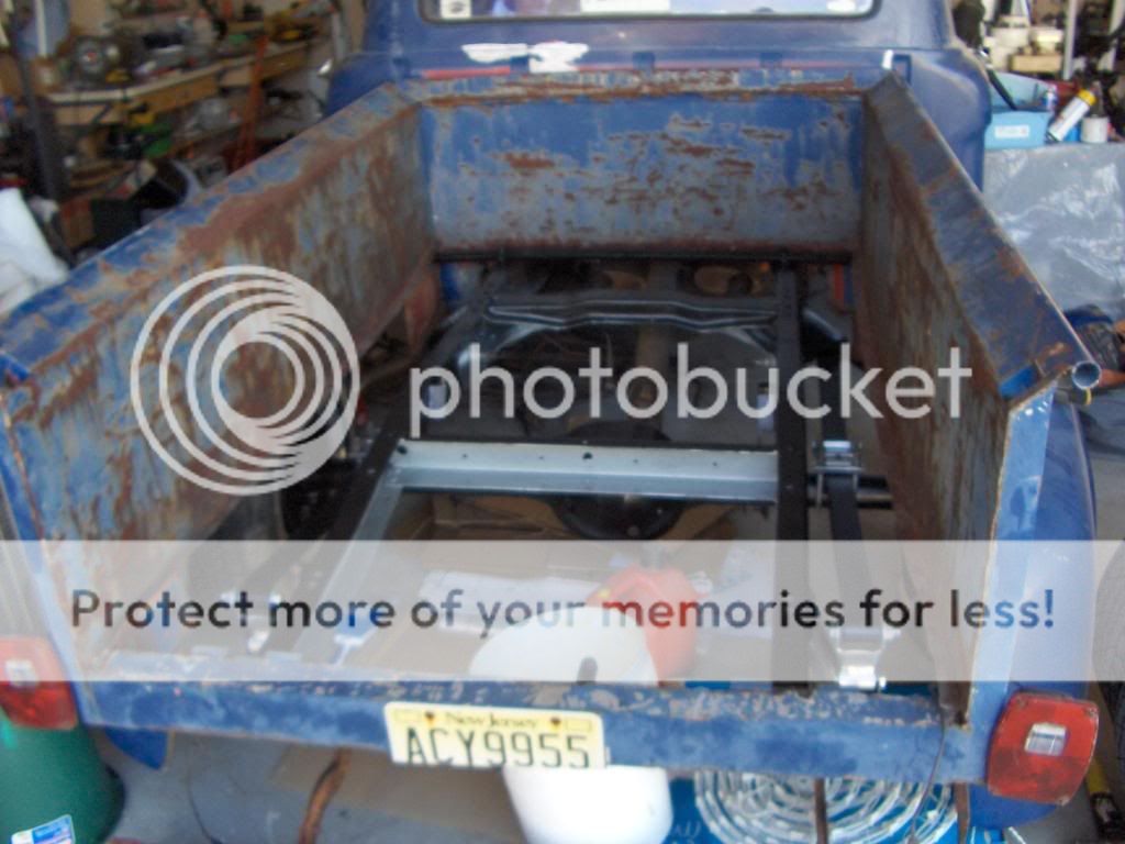

I started in the rear - because it was the cheaper end & also, in my mind, a safer place to learn to weld! I got a set of drop mono leafs & went to town. Pulled the bed, puled the rear, swapped the springs & reinstalled for a test fit. Yup - I needed c-notches so pulled it apart, became one with the wire wheeler, cleaned it all, boxed the frame, cut & welded in the notches & bump stops, then prepped it for POR15 & chassis black. Threw it all together, then spun her around to get to work on the nose.

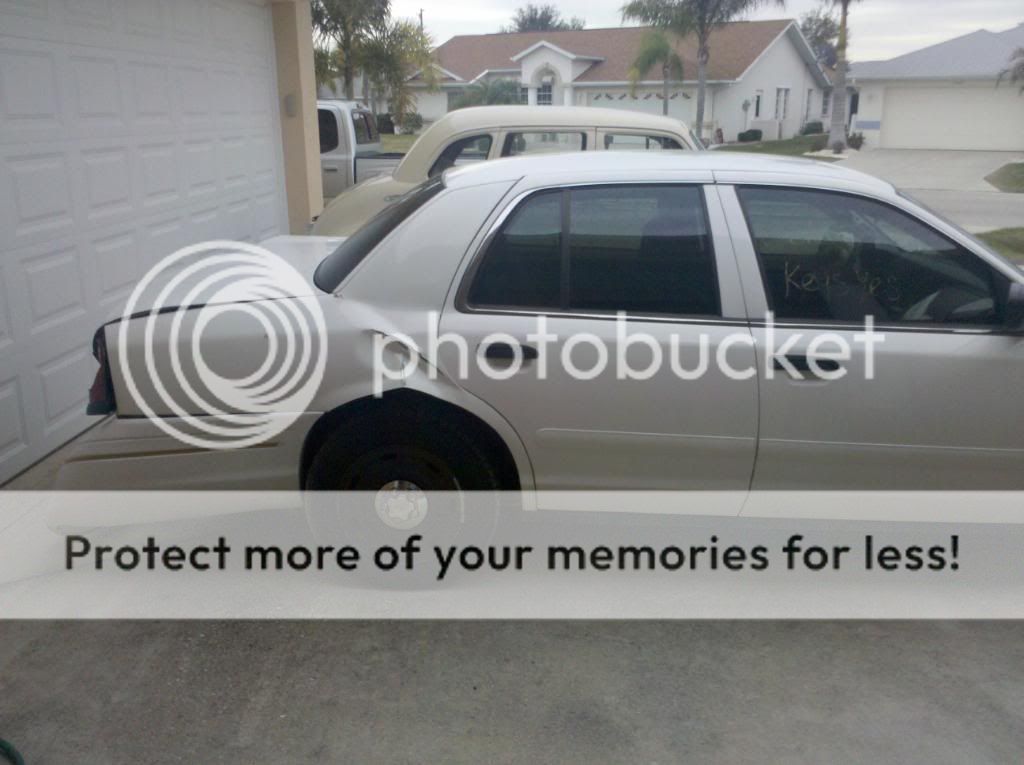

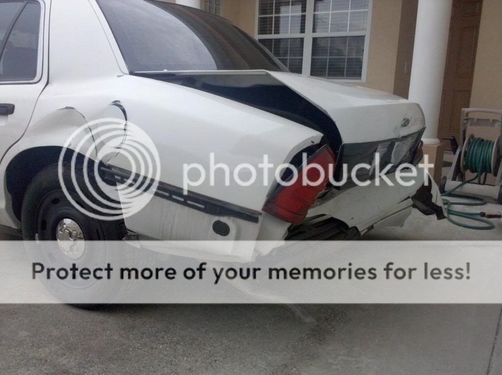

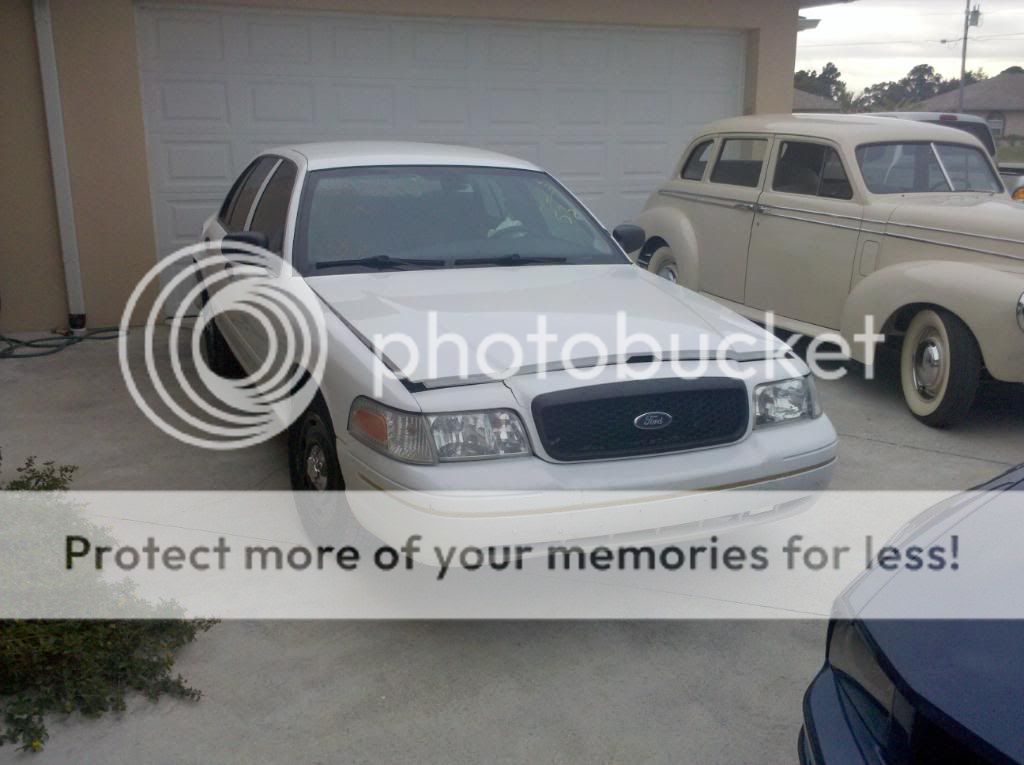

I know you won't all agree with me or the choices I'm making, but here it goes. After much reading & research, I've decided to go with a Crown Vic swap. I got my donor last night. 2004 CV Police Interceptor. Rear ended pretty hard, but it starts & drives fine. I plan to harvest the front suspension, rear end (I know it's too wide but since I've got a rusty flare side, I figure I can easily widen it!), radiator, most of the AC, engine, trans, driveshaft, ecu/harness, booster & master cylinder, and hopefully even the anti-lock brakes. I hope to part out the carcass - front clip, doors, possibly the interior - to help offset my expenses & then scrap the hulk at the end.
If you're curious, the 41 Studebaker Commander is Pop's - he was out of town so I took delivery of it here for him... the day before my CV got dropped off. Needless to say, my wife, and deed-restricted-community neighbors are loving me right now!

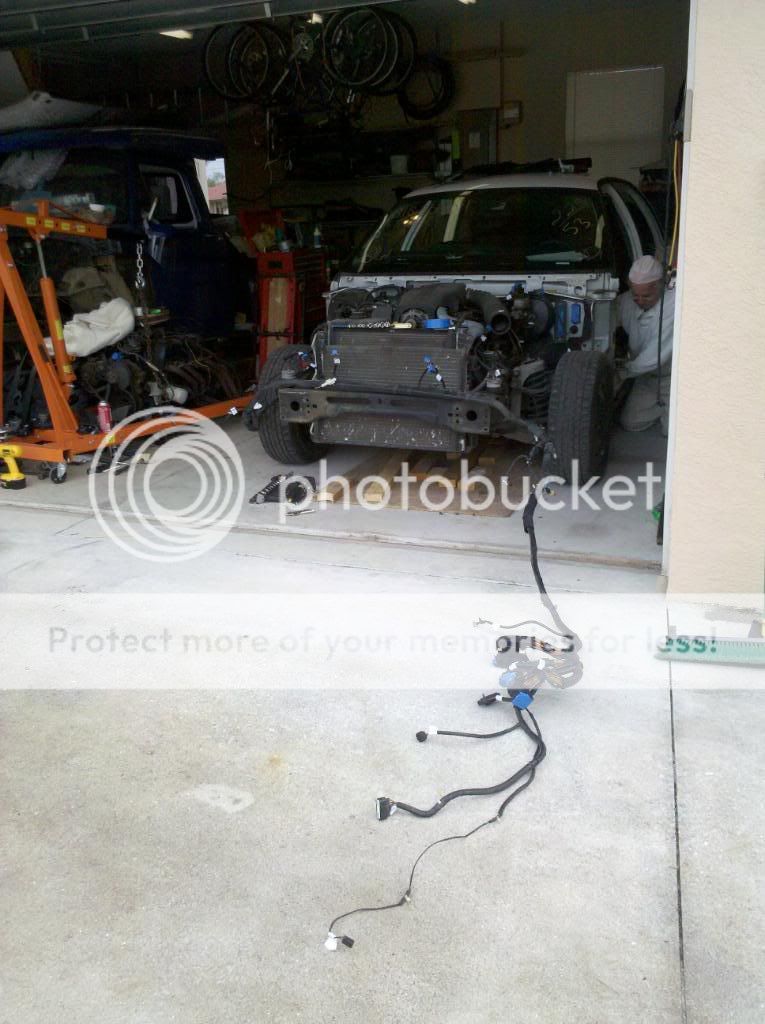

The snake is longer! Figured out the antilock unit's clip. Surprisingly simple when you figure out you're looking at the wrong end!
So dad & I spent the afternoon chasing more wires, trying to tear the dash apart, and draining the coolant/ pulling coolant hoses (you actually have to remove the heater core lines in order to remove a clip on the heating/cooling system - fun!).

No doubt! A bigger space would be nice, but... so the last two days have been fairly productive... got the whole harness off the front end, drained the fluids (why don't tranny pans have %$#&* drain plugs??? LOL), got the dash out (what a beech!), pulled the steering column, ecu, dash harness (why is it integral with the harness that runs down the door sill on both sides??), the ebrake setup (think that's getting transplanted too), and also unbolted the brake pedal/booster/mc & gas pedal. Whew.
Hey does anyone know anything about ABS? I'm wondering if I should bleed the system dry before I start braking fittings loose, or if the ABS brain/pump needs to keep fluid in it. I can just see me bleeding it dry & then finding they're near impossible to bleed the air out of. LOL

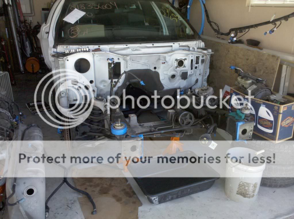

Nothing exciting for pictures, but got the brakes bled out, pulled the pedal/booster/master cylinder & broke the lines loose to get off the antilock setup, the gas pedal & cable, steering column, radiator, ps/trans cooler, and driveshaft... waiting on my buddy Chris (he's an AC guy) to come & evacuate the refrigerant from the AC system so we can get that out too. (My inner tree-hugger won't let me crack the fittings & let that stuff fly).
Need to get another 15mm deep socket to get off the exhaust (don't you hate it when sockets go missing?!?)...

Ok, so we got the AC taken care of, and got the condenser out of the way, also got the exhaust off, anti-lock controller thing, rubber floor mat, a/c box on the firewall, disconnected all the brake lines and antilock sensors, and pulled the rest of the harness out. The darned harness fills two boxes and has to weigh over 25 lbs! Yeah - it'll be fun putting that on a diet! Since the tail of the car was so crushed, I couldn't get to the evap can (??? I'm guessing here) and wire harness plug (assuming for the fuel pump) from underneath the car (the hitch was bent up & under the cover plate). So I emptied the truck & used an air saw to ginsu the trunk floor & pried it back like opening a can of sardines. Got the plug undone & pried & tweaked to get the can & pan dropped, then hammered the trunk flaps back down so all the scrap steel won't fall out when we fill it back up! I think even more fun that that was unplugging the fuel gauge sender - the wire drops under the package tray & onto a crossmember over the gas tank. So you have to reach your finger thru a little cutout in the crossmember & release the connector with crap falling in your face. Fun! But it's done & that's the key.
My brother-in-law (Galloway Ford Parts Department Director) ordered me up a set of tools to undo the fuel & ac lines, and is trying to find the lift brackets for the engine so we can get it out. Unless anyone else has an idea where it's safe to lift this thing w/o breaking the heads, valve covers, sensors, engine wire harness, etc.... LOL
Yeah, I think we just need to disconnect the power steering lines from the pump to the rack, get the engine out, then the front suspension, then the rear end, fuel & brake lines (I hope to re-bend & re-use as much as possible - waste not want not!) & then cut out whatever patch metal we can and we can get rid of the carcass.

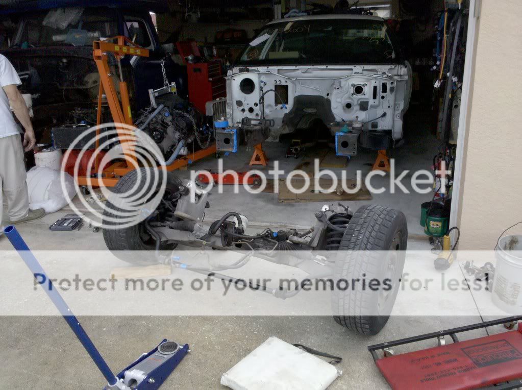

Ok, so we started today by pulling the body mount bolts & putting the tires back on. Rolled it outside to clean out the garage a bit, then rolled it back in & got the fuel lines & brake lines out of the way by jacking the body off the frame & sliding them sideways.

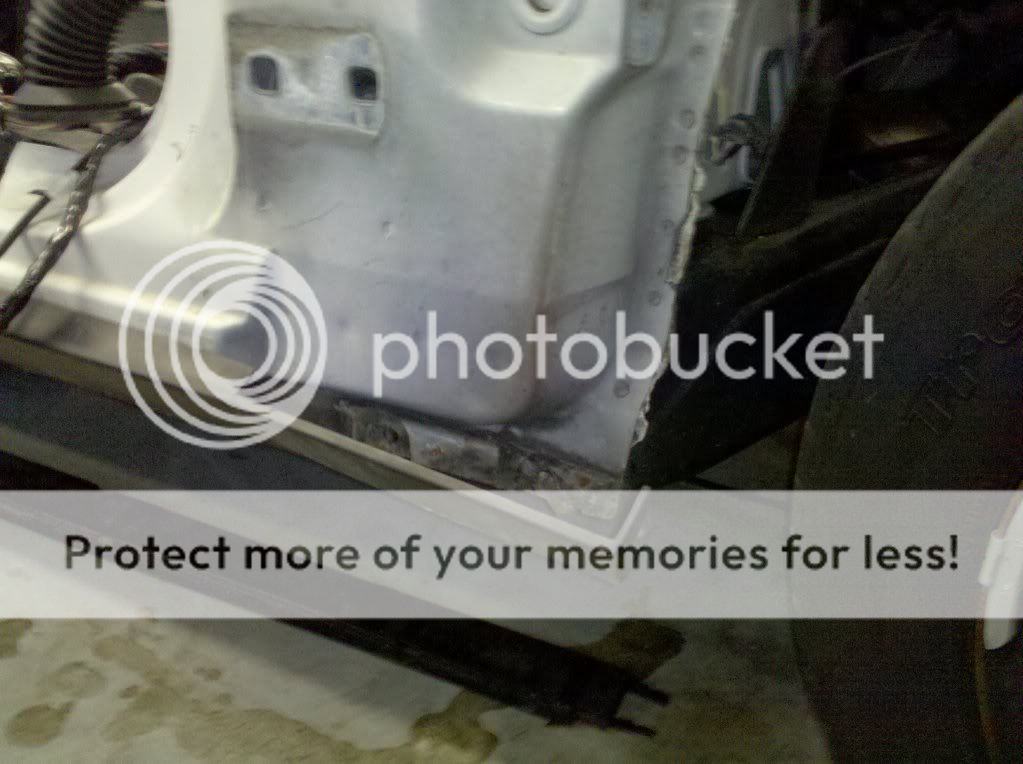

Then we dropped the front suspension and rolled it out, & then cut off the frame rails just behind the trans crossmember mounts - the rails are roughly the size of 2x4's here and it made for a nice & simple place to cut.
Got loads of room to work around the rear end now...
