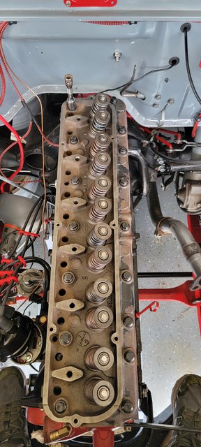

Took the head to the machine shop to recheck all my valve guides.

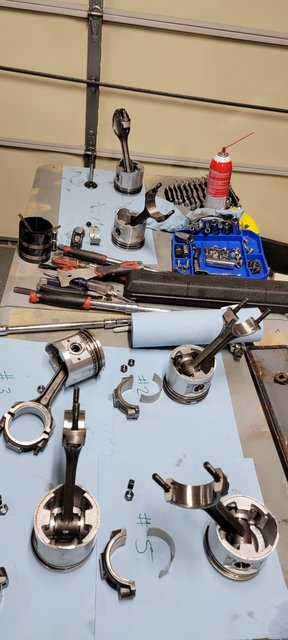

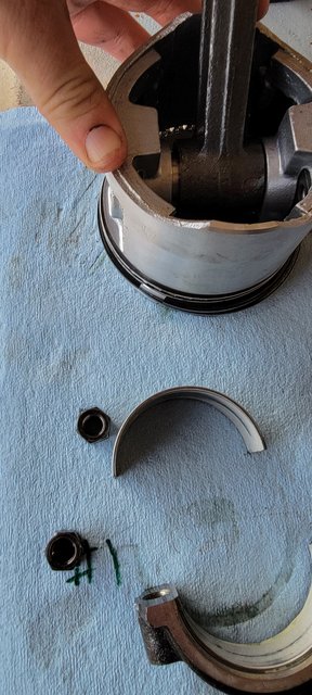

All pistons out. they all look great. Intended to gap the pistons one more time and check everything.
All pistons floated nicely on their wrist pin.... but #1. It wont move but a hair.
I suspect when the piston crown took a kiss from that exhaust valve back when- it crunched down on the bushing.
Off to the machine shop with that one!

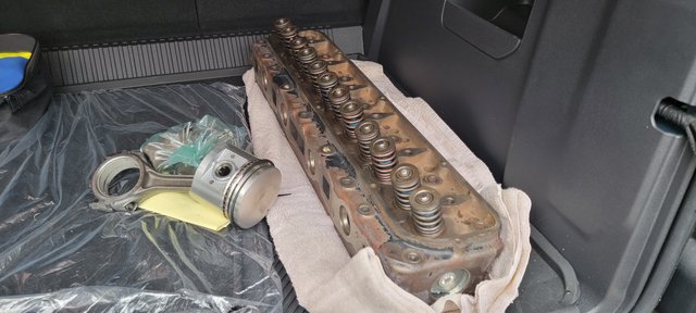

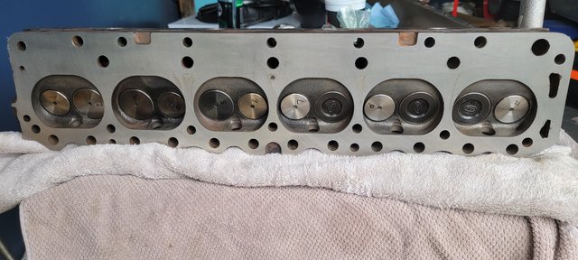

Got my cylinder head back.
They changed 3 exhaust valves.

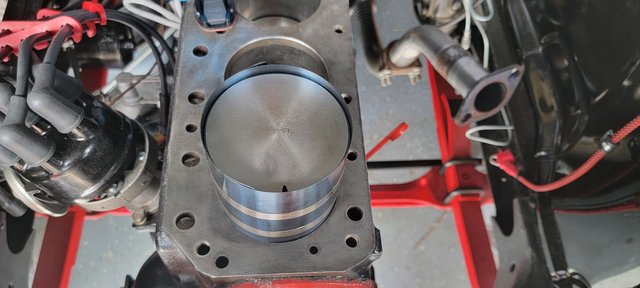

Piston back as well, wrist pin bushing replaced.

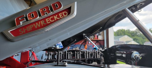

Piston installed
Consulting the manuals.

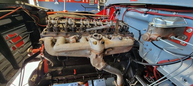

Valve bridge back in. Next to check valve lash.
Have a weekend or two left before deployment

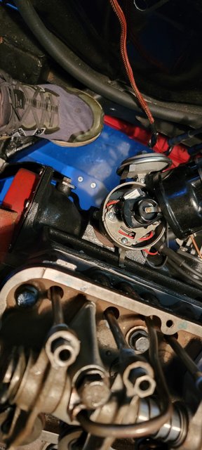

I was doing valve lash and standing on my little ladder to reach #5 and #6, I slipped cause it started raining. I came crashing down with just below my ribcage on to the core support. Ouch. It did leave a mark.
I have valve lash set. Will put the rest of the intake, exhaust and find a way to route a better fuel line to my carb. I hate how I have a temp one set up now.

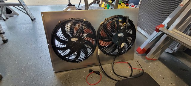

Dual electric fan set up about ready to go in.
Also, mechanical fuel pump struggles.

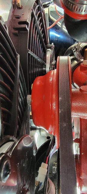

I spent a little time trying to seal my oil pan. The oil is escaping at the timing chain cover where the oil pan meats. And appeared to be the rear main seal too, but after putting rtv on the oil pan, and started the engine after putting oil in, there is a slight leak on the pushrod cover.
In between the rtv setting and me running it, I decided to install the dual electric fan set up I bought a long time ago from Champion Radiator (where I got the radiator from as well)..
It had a hair clearance between the pullg bolt heads and the electric fan. I loose Ed the radiator, pushed toward the driver side best I could and tightened. Gave a second hair width clearance.
This system has a relay which I spent too much time trying to find a good place for. I settled on the forward passenger fender by the core support.
I have to get the wire to the ignition switch, which is harder than it should be. It's a tight fit, and I will get to it later.
I aired up the tires. They were at 20psi, needed 35. I took the rear wheels of the dollies and I will take the front off tomorrow.

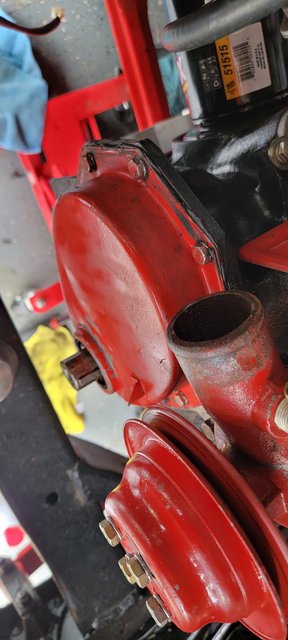

Took today and got to the bottom of my timing chain cover leak.
Drained coolant
Removed radiator
Lifted engine (transmission jack was the lifesaver)
Removed alternator and bracket
Removed front engine bracket
Removed balancer
Could see daylight between mating surfaces of the front engine block and timing chain cover.
Pulled it, rtv makeover and put it all back together in reverse.

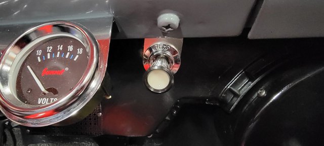

Little tinkering today. I found my oil filter assembly leaks- tattle tale showed me it was leaking there, not the front timing chain cover. I slightly remember installing that assembly like 6 years ago. I had to get it from inside the block. It's not so bad I want to tackle it this week.
I got the truck timed, I had to add more turns to the accelerator pump screw because I could just not get the carb dialed in with the idle mixture alone. I put a few turns on the accelerator screw, then started it up. Super rich- so I backed it off a little and it settled. Holds 19hg vacuum.
Was trying to get my electric fans to work. I am going to try one more thing tomorrow night. I am going to rewire to the sensor from the relay. It just isn't gonna make it the way it is. I double checked everything else and had good connection, good temp rise that should have triggered it to turn on. I jumped the switch and the fans both work.
Tested the heater. Sure as heck works!
I installed a temp control from an early bronco. I need a little section of throttle cable to finish this off. I can mate the short wire that is on this controller with the other section and attaching it to a fender mounted valve.
