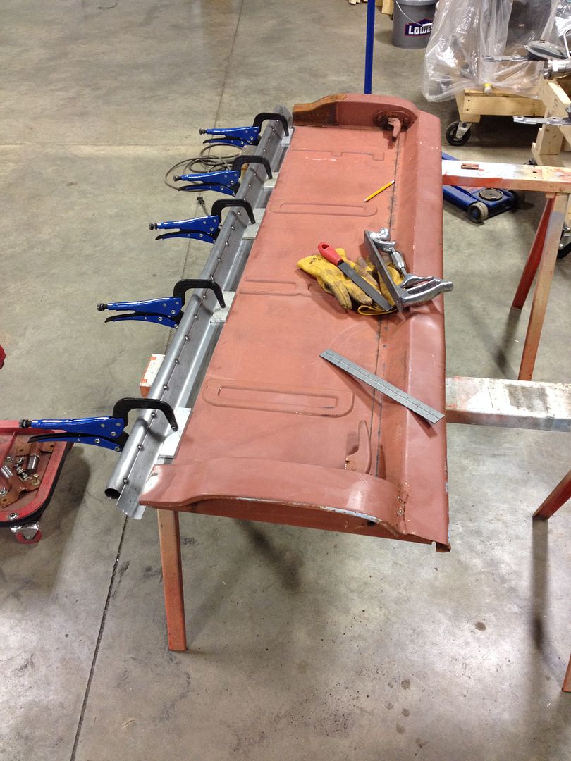

The bottom of the tailgate was rotted away, and the previous owner had cut it off. I fabricated the last couple inches and tacked it in, but I haven't had a chance to finish the sides yet.
