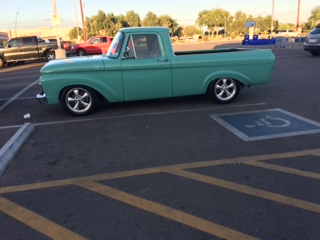

Sheriff Truck--61 Uni on 08 CVPI
Re: Sheriff Truck--61 Uni on 08 CVPI
Truck looks awesome!
