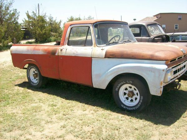

I'm building a 1962 Unibody shortbed for my wife. I've been working on it for three years. It has an Industrial Chassis Dakota kit that I've just installed. I've also moved the gas tank to under the bed, replaced the floors and other metal work. Here is a photo from when I bought it. More to come.

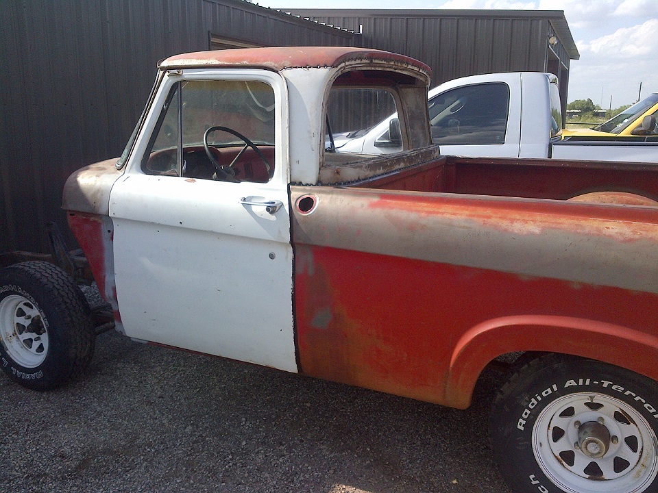

Post by 6265 »

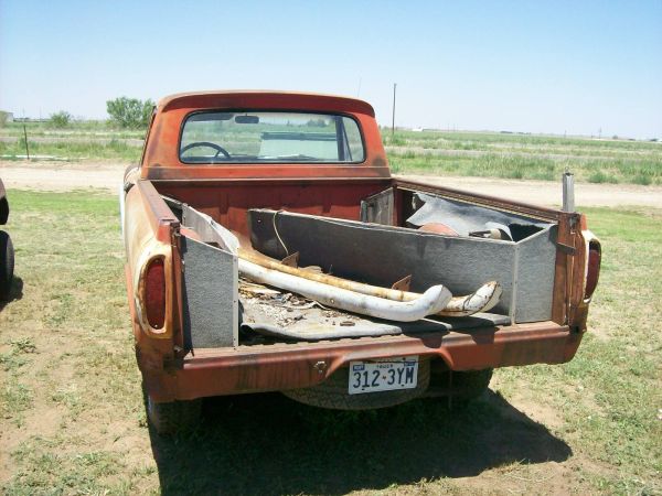

Truck came with previous owners junk.

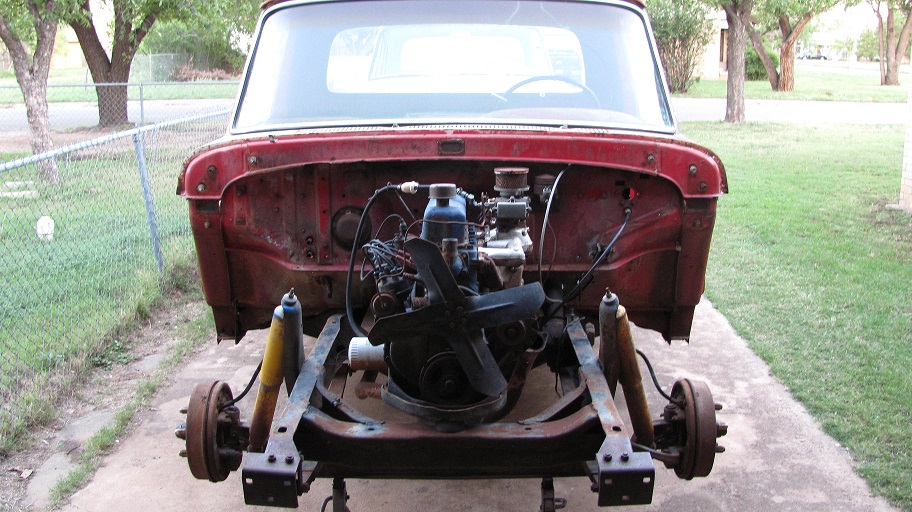

Post by 6265 »
Beginning tear down

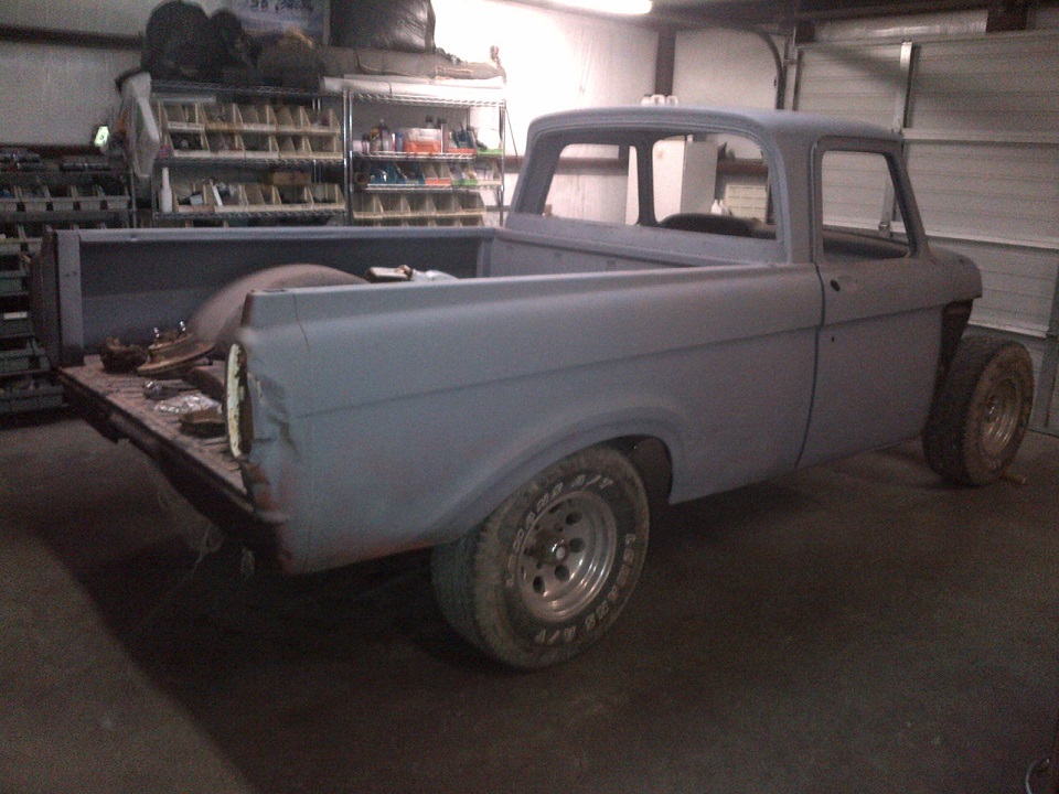

Post by 6265 »

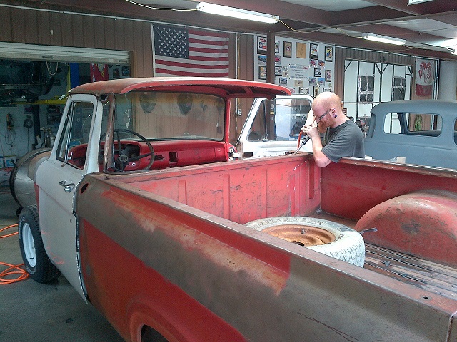

I located another 62 unibody longbed that donated it's big rear window frame and glass along with it's doors and tail gate hardware. I also got a decent used tailgate from the Pate Swapmeet that year. This is after welding in the windows and swapping out the doors.

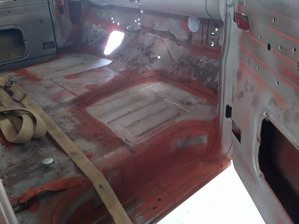

Post by 6265 »
after blasting the cab, replacing both floors and seam sealing all the joints. still needing to replace the steps

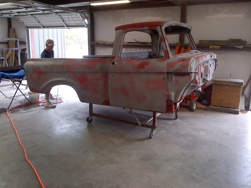

Post by 6265 »
cab is blasted

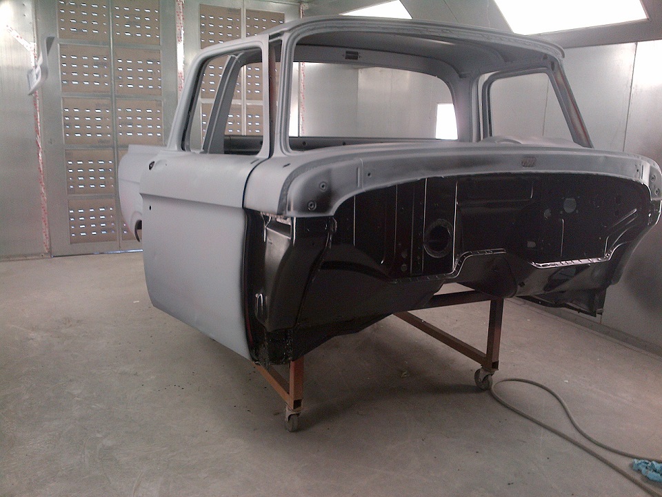

body now has sealer on it and PPG AEU on it's underside. time to go back on the chassis

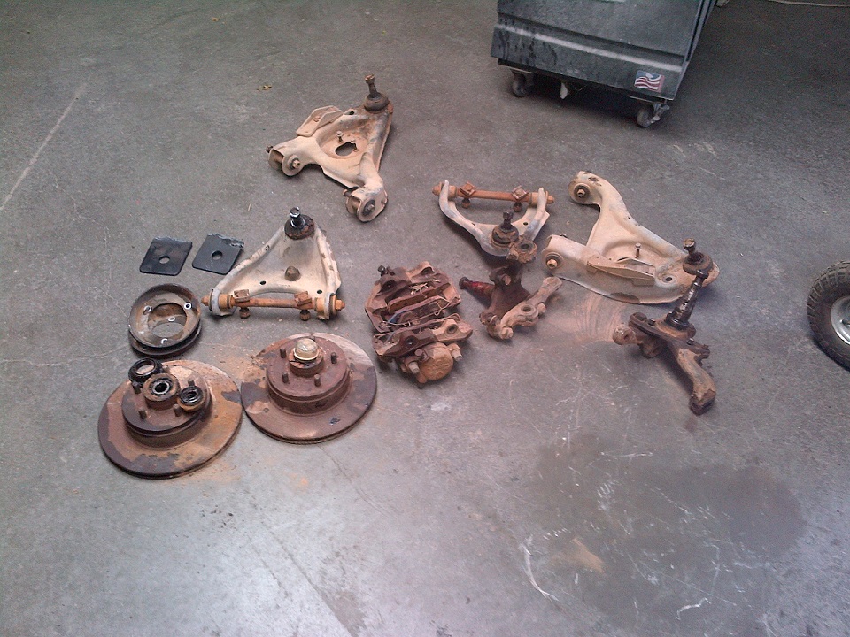

found a complete 87 Dakota at the local wrecking yard
1965 F-100
1962 F-100 Unibody
1975 Chevy Vega drag car
1967 Mustang Coupe Vintage SCCA Race car
6265
Posts: 54
Joined: March 28, 2015, 7:06 pm
Re: 1962 Unibody build
Post by 6265 »

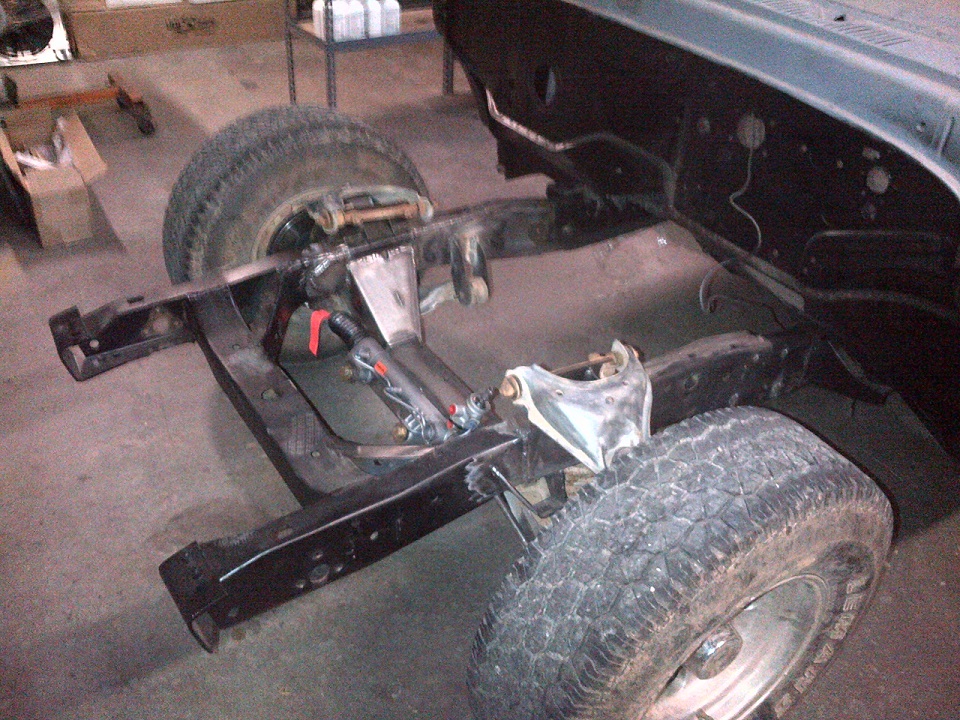

I upgraded to the Dodge D150 rotors and will be using the Willwood calipers
1965 F-100
1962 F-100 Unibody
6265
Posts: 54

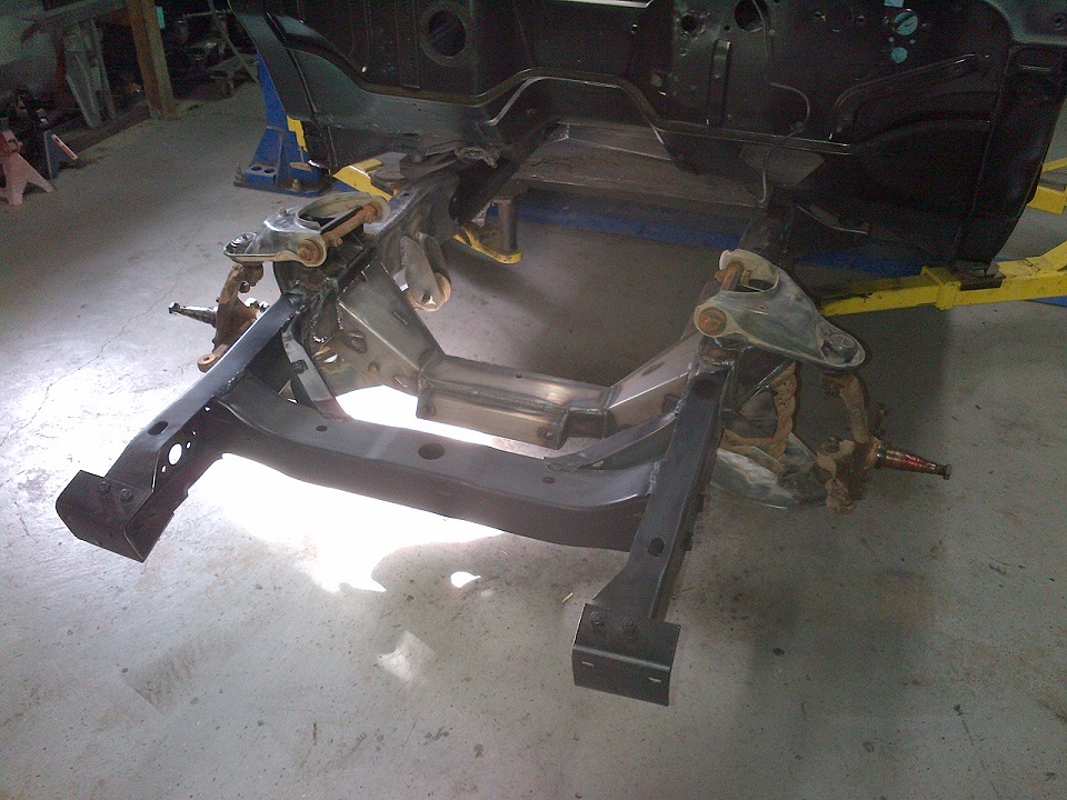

Post by 6265 »
installed the rack and pinion and new rotors. finally have a rolling chassis again.
