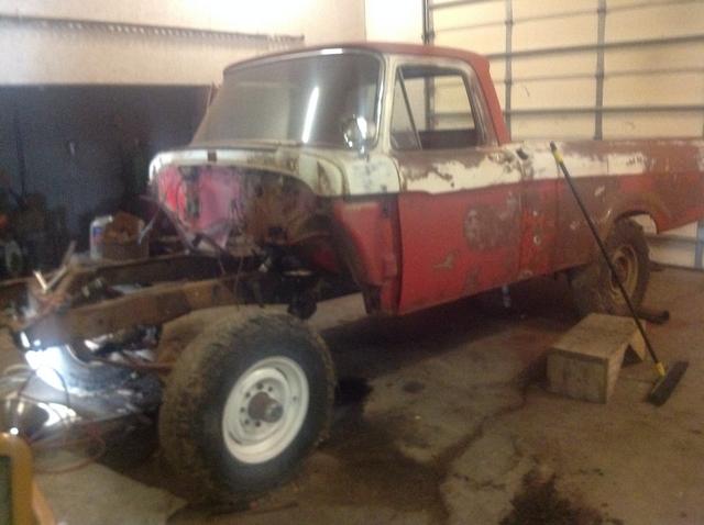

Pulled it into the shop the first of the year
It's rough with a lot of rust...
It's just gonna be a farm truck
Sticking a 300 i6 with intake & headers c6 auto in it
Already got the front & rear axles swapped out
Just about got the transfer case under it
Plans are to paint also..... not fancy.. just a smidgen better than rustoleum

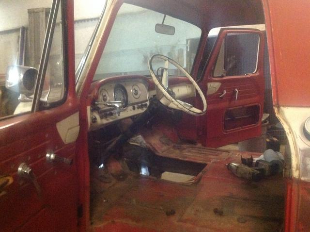

A reupholstered seat & mat will make the interior look decent
Radio & possible AC might sneak in there eventually
I think I have a repairable headliner somewhere
And a rednek steering wheel repair (wrap it with tape) job

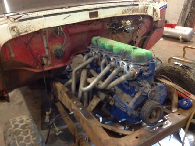

Engine , Transmission , Transfer-case all bolted in tight
Motor probably sits a little More forward & higher than some
But the c6 with divorced t-case gets cramped
Had to tweak the headers just a smidgen
Will get the intake bolted on & throttle linkage figured out soon

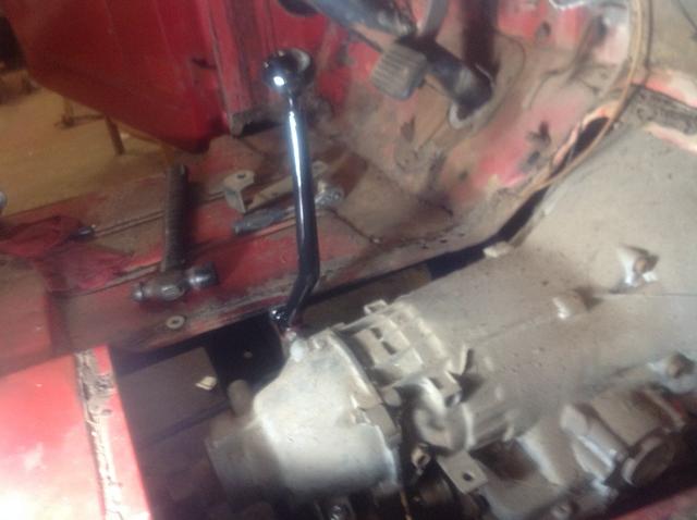

I would have never Guessed the 1961 transfer-case handle was a direct
Bolt on to a C6 automatic trans .....
IF.... you weld a 5/8 bolt head to head with a 9/16 bolt :mrgreen:

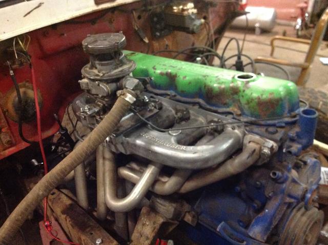

Finally got to hear the engine rumble !
It's been sleeping for a good 7-8 years
I have no idea how long it's been since the truck shook
The propane setup has been sitting a long time
Bolted on & hooked up to a BBQ bottle of gas
Engine idles & revs like it was tuned for the 300

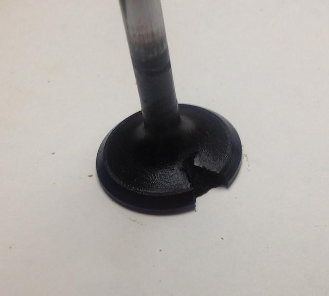

Had a miss on number 5 I couldn't get rid of
Did a compression test ... crap !
Thought maybe I left water in it & froze & cracked something
Pulled head & found this ...
no damage any where else

At least it wasn't in the bottom end.
Re: The UNI-KORN
04sd wrote:At least it wasn't in the bottom end.
Very very true .... this just set me back a little
Come to find out it's board .060 over , new pistons
The head looks wonderful.. this is a fresh engine
The auto stores couldn't locate a valve
Its stock, but the stem is .015 oversized
The engine shop I went to found a set of 6
He said that break was probably caused by open headers
Or bad seal between headers & head
Will put in all 6 new valves & give it a run time

Tell us more about the carb and propane setup.
Is that offenhauser intake a dual plane or single?
Can the engine run on both gasoline and propane, in other words can you use a shut off valve and cutoff gasoline and turn on propane, then switch the other way?
I like what you are putting together.
Bradshaw
Re: The UNI-KORN
I'll be 100% honest and will tell you I'm definitly no expert on this
But from what I have learned from the internet & talking to guys
The intake is a 4bbl dual plane
The impco propane is a 425 model
What is equivalent to a very large 2 bbl gas carb (460 cfm)
I am strictly on propane only (I have a 47 gallon tank im installing)
The 300 i6 has been known to run lean on the outside ( 1 & 6 )
The intake & propane should eliminate that completly (my thoughts)
