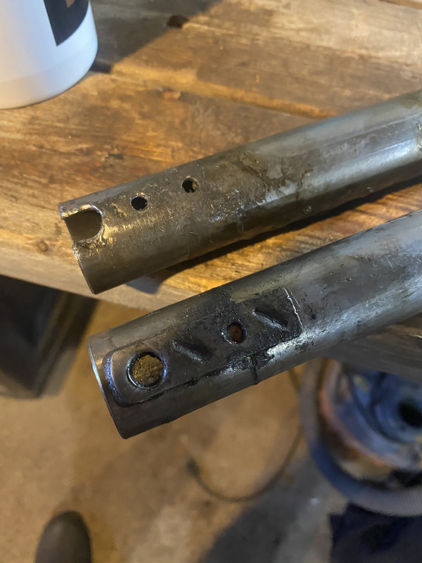

I pulled the column and it needed a rebuild bad. The shift tube was missing a tab for the shift lever to go into and the lower column bearing was not even in the column. It also did not have the bearing cup that seats the bearing. Luckily I had a 65 column to compare and attempt to pull parts off of. I know its different but I was having trouble finding 63 only info so I'm attempting to make my lower bearing setup look like the 65's.

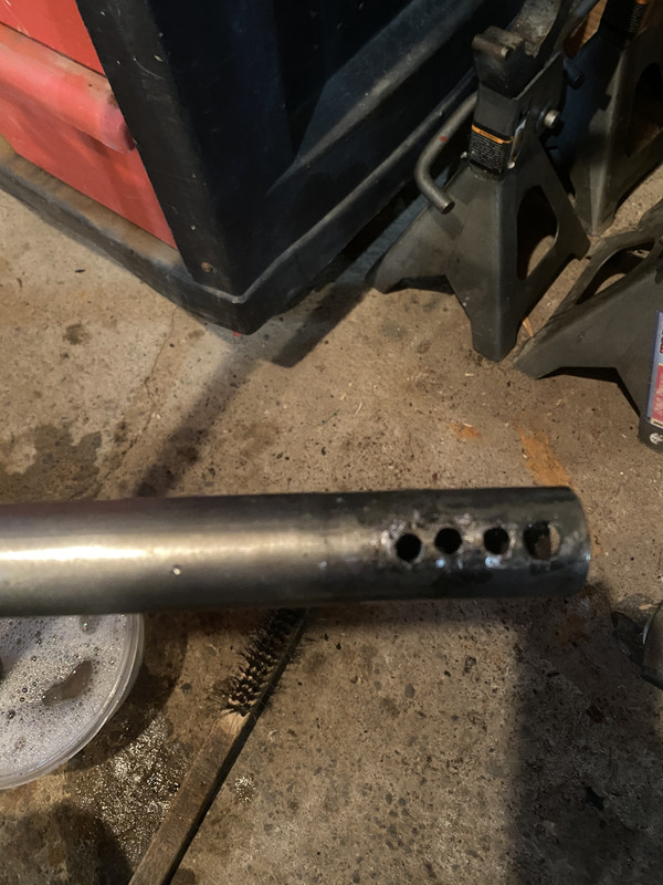

I drilled out the spot welds on the 65 shift tube to pull the tab. I'm going to clean up my shift tube and the tab and then tig weld it on really well as per old smiley's guidance.

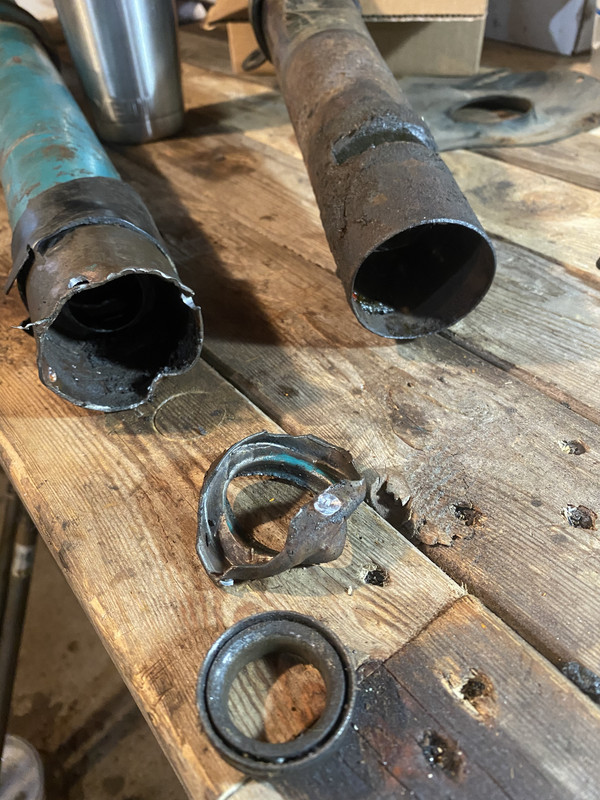

I attempted to reuse the bearing cup from the '65 column by drilling out the spot welds and pulling it. I deformed it attempting to pull it out...so then I ripped it out. I had decided it was coming out so it did lol. My '63 column is on the right. You can see it has no bearing cup. No wonder my column was so wiggly...

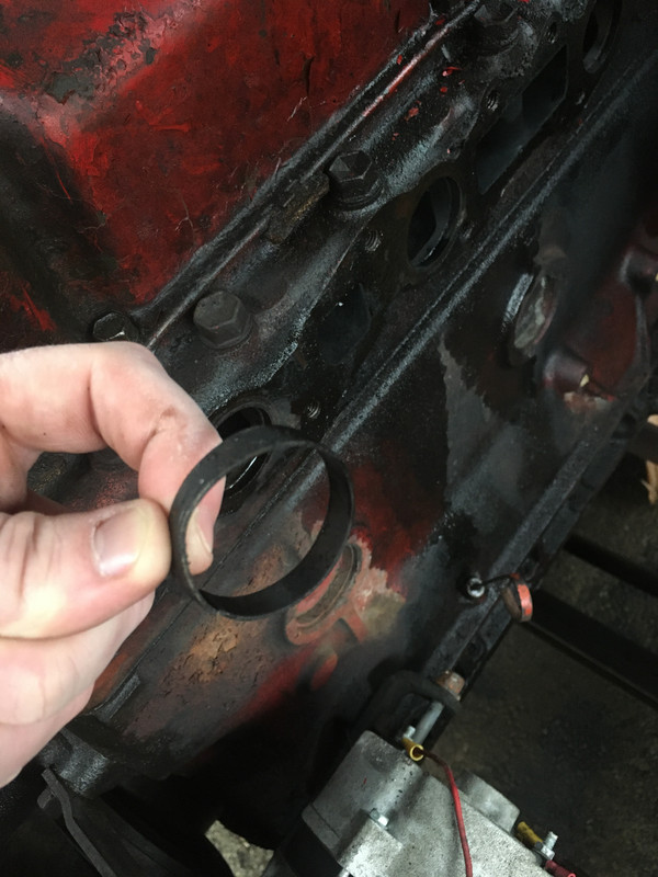

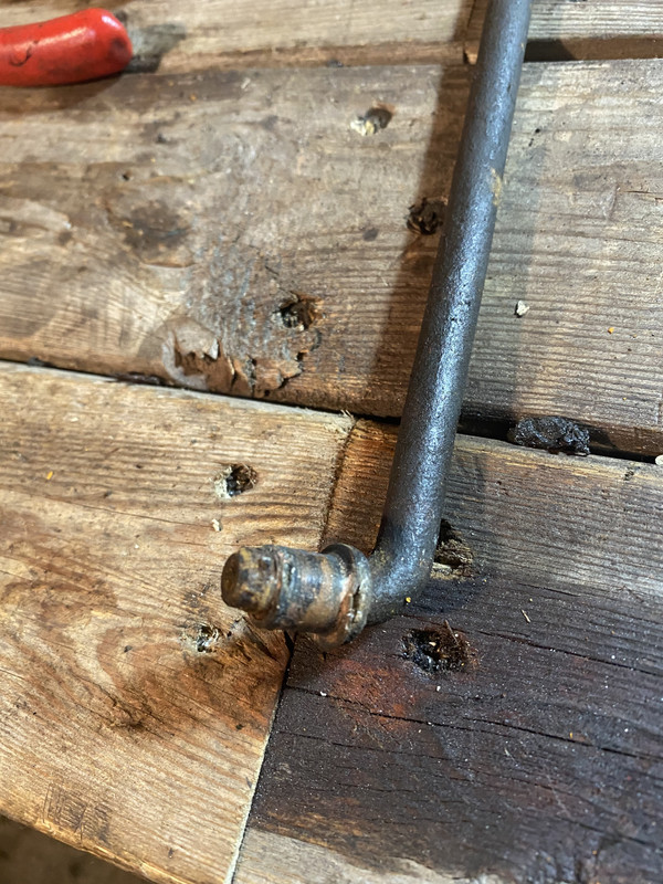

I also grabbed a bushing kit to rebuild the shift linkage. I noticed the bushings fit the linkage fine on the transmission side of the linkage, but on the column side the bushings need to be reamed out a little bit to fit the linkage through them.

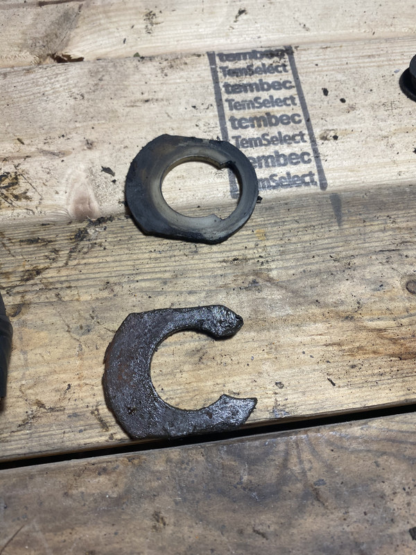

Bonus pic just for curiosity's sake. The spacers between the column shifter arms are different between 63 and 65. 63 is open and 65 is closed off. The 63's was metal and the 65's plastic. The space of the opening is the same so I doubt it matters but I thought I'd throw this out there for posterity.
