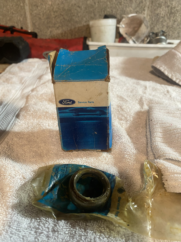

I ordered a steering column bearing from Mac's and was extremely disappointed. The "new" bearing from Mac's had way more play in it than the worn out original bearing! What a waste. I had decided to just keep using the old bearing but now I'll be putting this in the column.

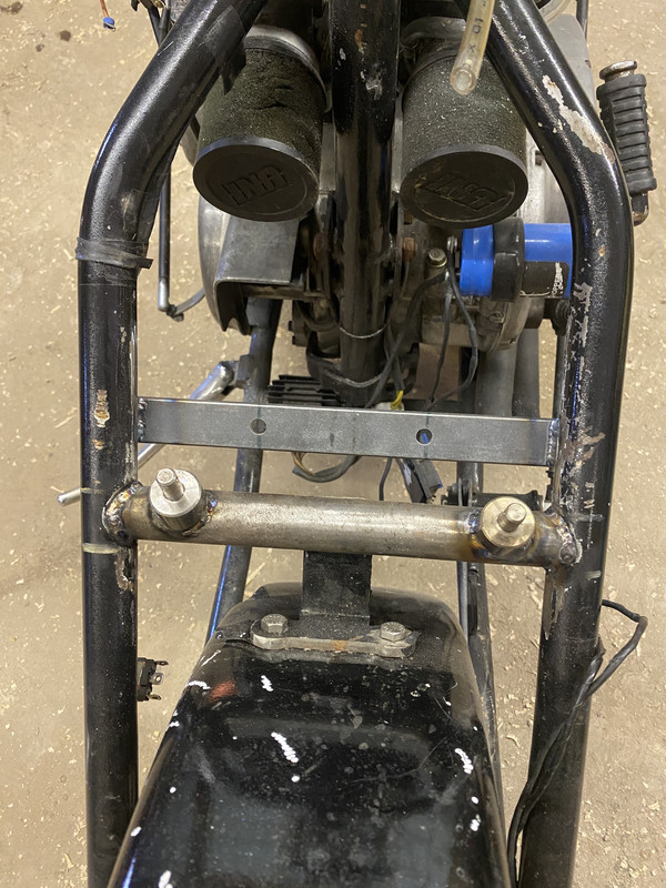

Not truck related but I did get some welding done this weekend on my buddy's bike. We're working on his '74 Harley XS chopper. He had me weld up the seat/rear fender support and a bracket for a fake oil can that will house his electronics. It was good to dust off the welding skills and start getting them ready for when I turn the torch on the '63 :lol:

Sorry for the late reply but in regards to the seal at the end of your steering column, 64-68 Mustang uses the same seal and its reproduced so shouldn't be hard to find. Some early 60's Galaxies used this seal too. Been enjoying your progress on your truck, hopefully I'll get some posts in on my 63. Keep up the great thread!

Thanks for the tip nightmare! I did some googling and found a place that reproduces them.

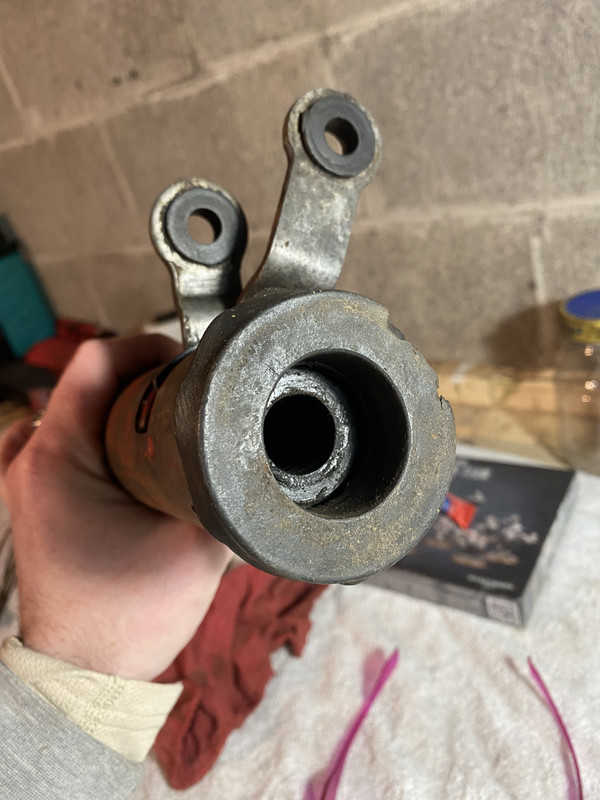

My steering column came in today. The exterior rubber piece I was missing (which has been ordered) and there is an interior rubber piece which I am missing. I’ll do some googling on that (maybe the mustang place has them?). Anyone have a part # for it?

Got the column all put together. No wiggle, play, and the gap between the shift collar and steering wheel is gone :thumright:
Unfortunately I may have to take part of it apart again because when I put the left turn signal on I blow the signal fuse. I think I may have pinched a wire in the column. Also my 1 amp radio fuse is blowing, not that I have a radio, but it bothers me.

Got some free time I wasn’t planning on. Found a pinched wire in the steering collar that was grounding out my front left turn signal. It’s all fixed and working great now.

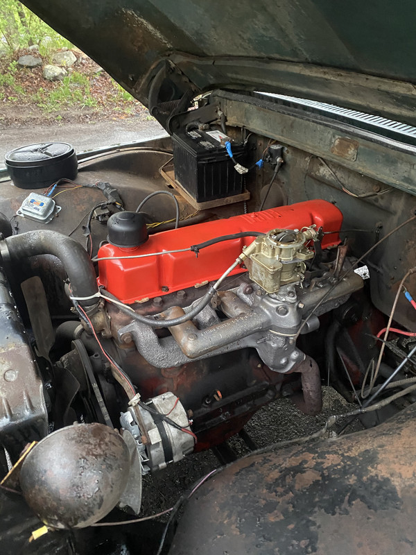

Well I'm getting pieces in place to convert my engine over to a carter YF and either DSII or just a conventional points dizzy. The rebuilt autolite I put on about 2.5 years ago is already starting to get leakage out of the accelerator shaft. I know that's a common problem but I thought I would've gotten more time out of it. I have a carter I'm rebuilding, but the dizzy is a different issue. I found a new '64 223 oil pump in my extra parts bin which would be easier for a dizzy swap than machining up a new oil pump drive shaft.
Is it possible to drop the oil pan with the engine in the truck?

I got all the pieces now for the swap. Made some time this weekend and got the old dizzy out, removed the drive gears from both dizzys, dropped the oil pan (came off no problem with engine in truck), and removed the oil pump. Next up I have to ream the old dizzy gear out to 17/32. I only had a 1/2 inch bit so I gotta run into town tm and pick one up. After that it should be straightforward, just put everything back together.
Before I pulled everything apart I rebuilt the Carter YF and put it on. Just wanted to see how it ran at idle. Fired the truck up and it ran so much smoother. With the Autolite I had a persistant erratic pop I could never seem to get rid of at idle. I always thought it was a rocker out of adjustment or maybe a vacuum leak. The pop was gone with the Carter.

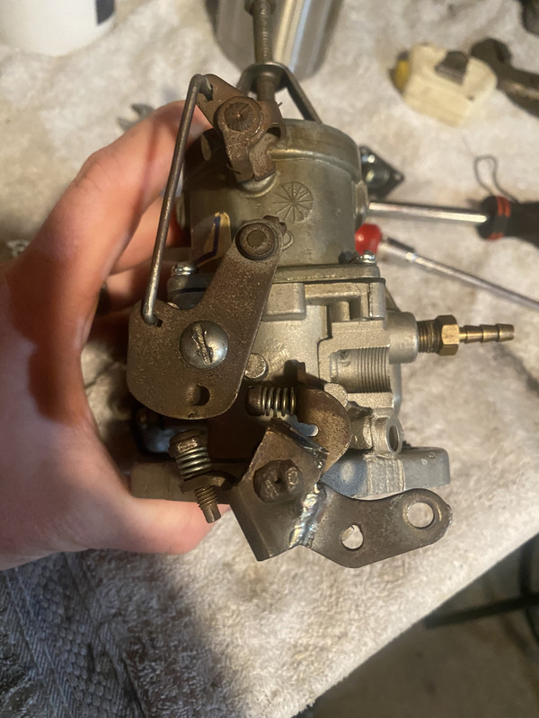

Biggest hurdle I have now is the linkage to the carter. I'm not quite sure how I'm going to rig up the gas pedal to it because the throttle on the carter travels differently than on the autolite. I do have another autolite that is not load-o-matic that I may use until I can figure out the linkage issue.

Got the DSII all wired in and installed this evening. Wow. What a difference. Just idling and driving around the yard. So much smoother. Can’t wait to take this thing down the road once I sort out the throttle linkage :steering:

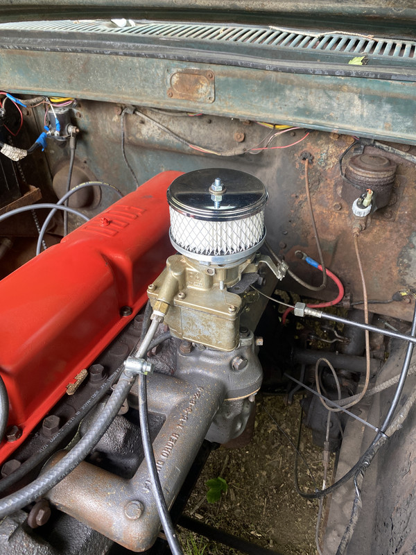

Scratching my head trying to come up with a temporary throttle linkage until I can get a 65+ pedal assembly together. Had a couple beers while cleaning out some boxes when I came across an old speedometer cable. Then my inner redneck came out :lol:

Picked up a tiny air filter to hold me over. Seems to work fine. Also rigged up the choke assembly. Next up is to fab up a better return spring assembly :steering:

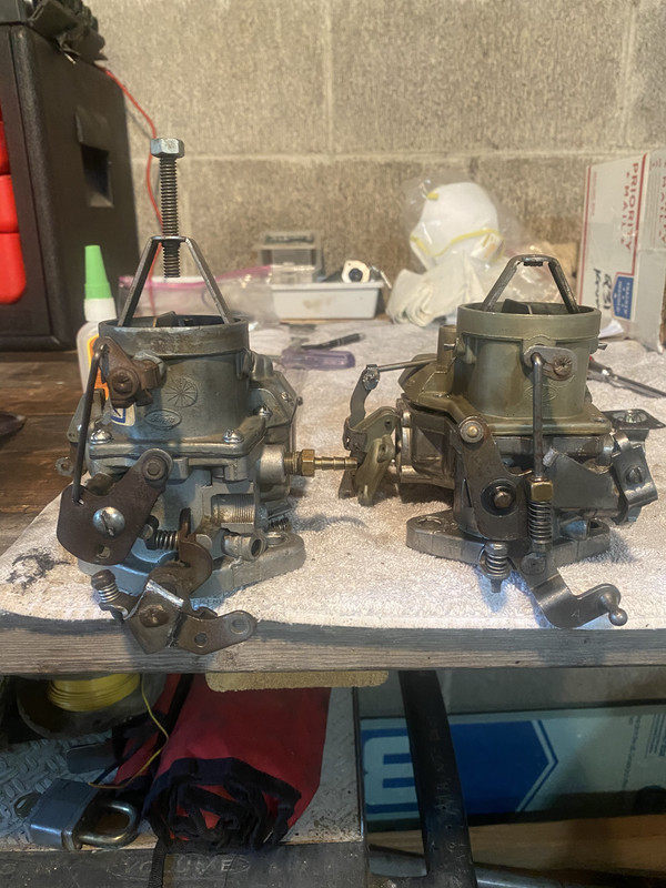

Haven't figured out a better way to rig up the carter yet, my makeshift cable was good for yard driving but that's about it. I have an extra autolite that doesn't have a SCV, but the throttle shaft linkage is in a different spot than the stock autolite with a SCV. So I cut it and welded it to match as close as I could to the original carb. Now I can use the original throttle linkage and at least drive the truck :steering:
Unfortunately the carb's throttle shafts are a tad worn. I get a little bit of popping at idle. I'm going to order some throttle shaft bushings and give that a shot at some point.
