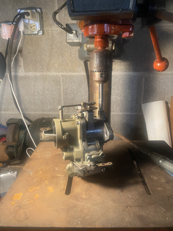

I also got around to replacing my worn throttle shaft bushings. I picked up a set with a reamer. Throttle linkage side worked well in the drill press, but I couldn't get to the other side. Ended up having to connect it to a hand drill and pull the reamer through. Luckily it ended up working out....

Man you are getting serious. Replacing throttle shaft bushings are a pain in the rump!!

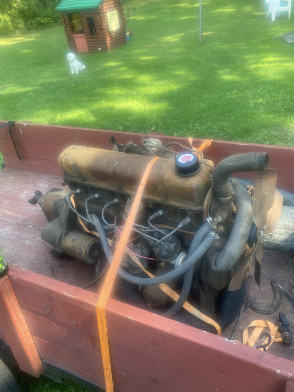

Well after a lot of carb tweaking and switching, adjusting the engine with the vac gauge, and then an oil pump issue, I finally have the truck running well! Went on a few dump runs and got my NYS inspection with zero issues. Going to start to adventure out more with it now that I'm a bit more confident.
I scored an extra engine and transmission out of a 1960 F100 for cheap today. Engine is froze from sitting. It looks like it's been inactive a while, still has Champion 860 plugs in it
best part is it has the carb linkage I was missing! Good bye metal wire.

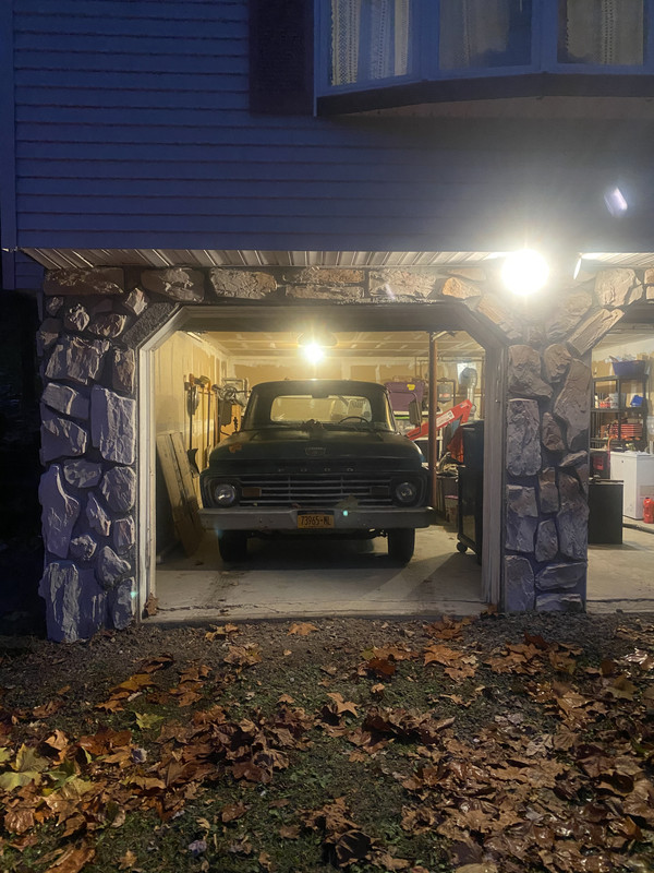

Well I adjusted my brakes today for the first time since I got the truck. Surprisingly everything was still pretty good. The wife and I are closing on a house next month and the truck has to be ready to go because it’s gunna get loaded down. New house has a two car garage so I’ll be able to comfortably start tearing into the truck
Re: Straight Sixin' '63
ThinLizzy13 wrote:Well I adjusted my brakes today for the first time since I got the truck. Surprisingly everything was still pretty good. The wife and I are closing on a house next month and the truck has to be ready to go because it’s gunna get loaded down. New house has a two car garage so I’ll be able to comfortably start tearing into the truck
Be very careful.....do you know how EASY it is to overload a 2 car garage? Then the truck won't fit into it.....
So that it will definitely fit I’ll make sure I park the truck in one of the bays, then cover it with stuff!

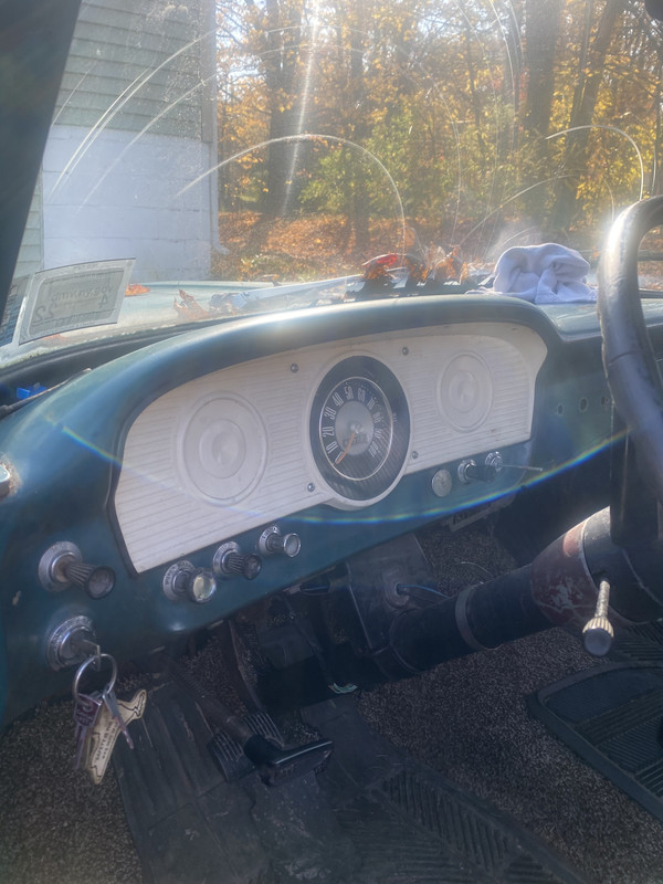

Shout out to Shipwrecked for the new dash. Got it installed and not only does it look better, but I no longer have a bouncing needle! Now that my Speedo is good it is reading high so I will have to get a new driven gear.

Looks good! Glad it worked out.

Well, 2 garages do fill up fast, but I managed to squeeze the truck in! The green toad made the trip all loaded down on a 25 degree day. The heater decided not to work and I lost all gauges and lights 1 mile into the trip but it’s all tucked away for the winter lol.

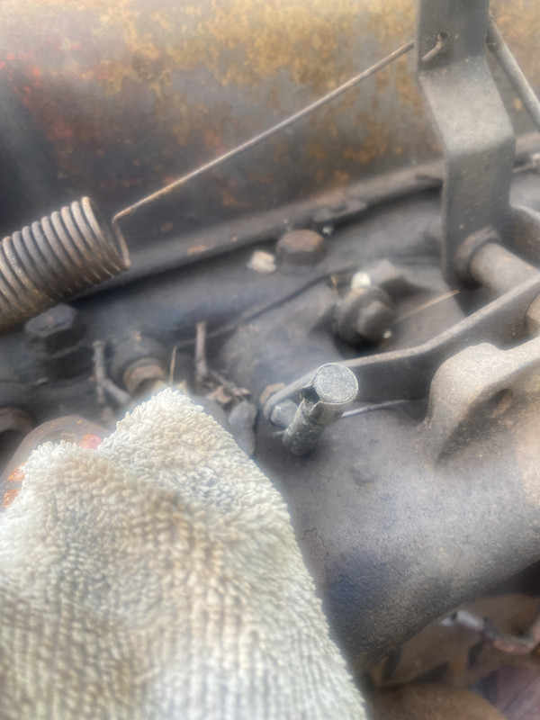

Unfortunately the unobtanium throttle connector I scored off my extra engine is about 1/8” too tall so it’s back to wire as a throttle connector. Truck is dialed in and purring along. Will have to get some miles on it here soon and see if those rocker nuts come out of adjustment again....

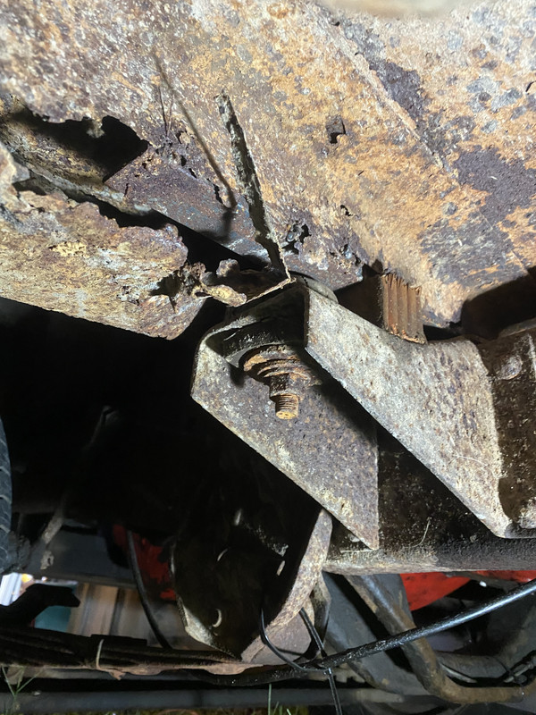

Finally got my new clutch in. Put in new motor mounts while I was at it. Probably gunna tear the rad support out and weld in up next and fab up a cab mount for the driver side….

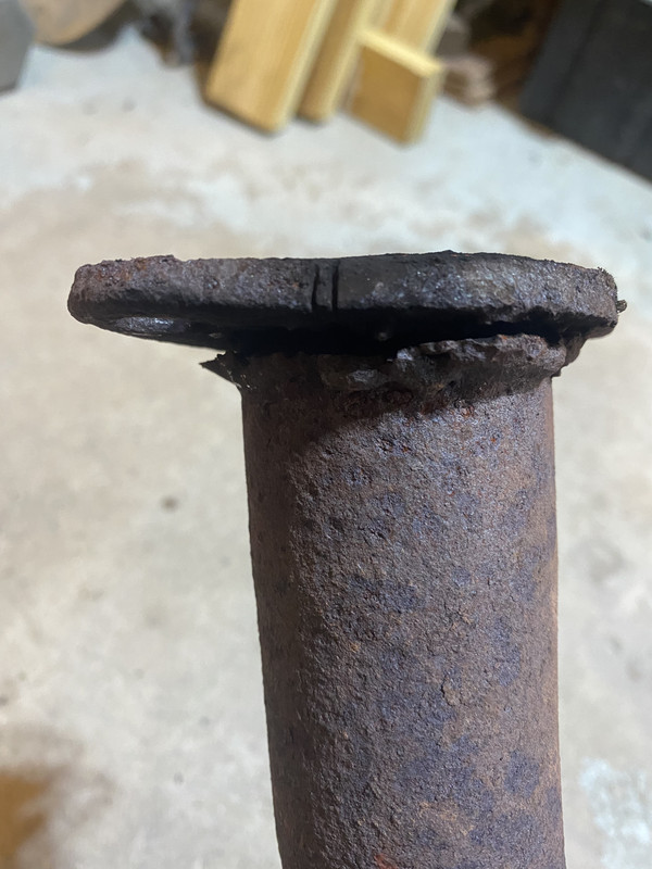

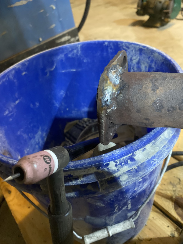

After years of saying I was going to, I finally got my welder hooked up. Bought a new muffler to replace the beat to hell old one and ended up breaking the flange weld at the manifold trying to install it. Looks like the original weld didn’t penetrate very well and wasn’t complete (probably part of my exhaust leak I could never get rid of). Anyway I cleaned it up a bit and managed to tig through the rust. Should be good and will finally have a quiet truck. Next up is the driver’s side cab mount

Nice work on the exhaust leak fix!!! Those things drive me nuts.
That picture of your cab mount sure brings back memories. Best wishes on that project. I used the reproductions from Carolina Classics and was/am happy with how it all turned out. It was scary for me to get into that because the step risers were very rusty, the "floor" wasn't much of a floor, and the kick panels were missing several inches. Hard to take any measurements before you start cutting but it all came back together. The doors shut and the fenders line up so I guess I could pass Ford's quality control from 1963.
Keep us posted on the progress please!
