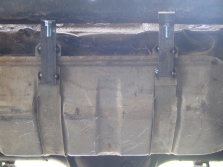

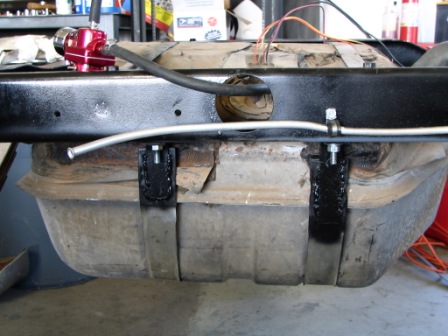

Mounts are easy for the Brono tank. Grabe the orginal straps and take some 1" wide X 1/8 thick flat stock and weld it to the strap. Put a 90 bend at top with holes for the bolt to go and there you go..
