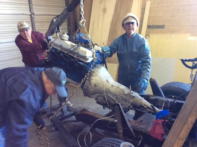

Some friends came over and we yanked motor and transmission. Thats my dad in the back
With the clip off, was not a major ordeal, with some help. Getting the engine on the stand off of the cherry picker was different story. I bought havy duty 2000lb engine stand, and the legs splayed out and would not fit in between legs of cherry picker.

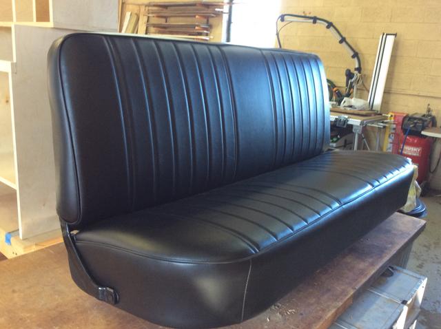

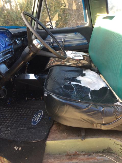

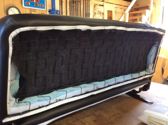

Seat guy finished up with seat and what a transformation. Found a guy in SC, Perry Ashley, his wife stiches and he does frame repair, foam etc.
Perry took frame down to metal, repaired sagging frame on drivers side, cleaned up and painted frame, new foam etc. really nice job for reasonable cost.
Before seat
After seat
Rear view
My grandson Riley will be pleased, he told me i needed to fix that before he could drive. He is 4.

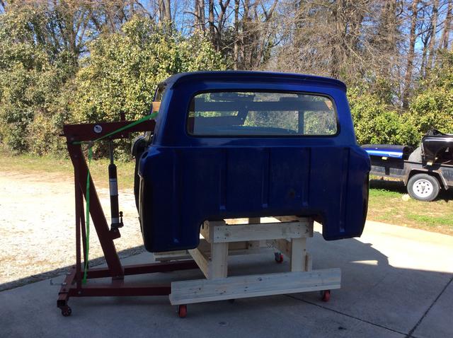

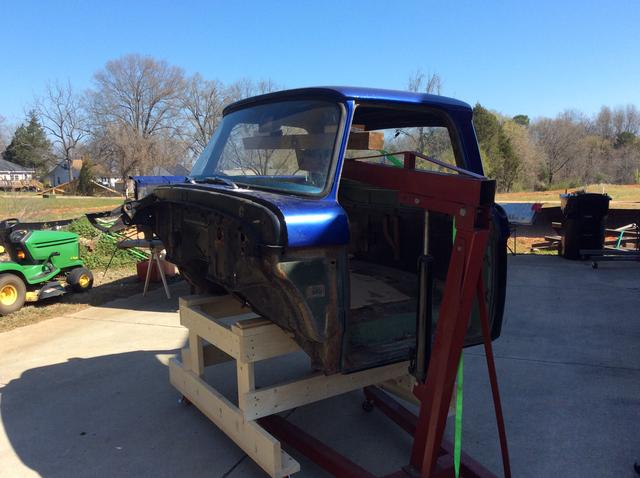

Finally get to work on something i know, woodworking . Built frame for cab dolly, cab is coming off this weekend.
I made it basically same width as frame rails 34”, with wheel outriggers for stability, and 4’ long. It sits up about 32” and has clearance under the side for cherry picker.
Local member of forum hooked me up with a boom to mount to top of cherry picker, so i should be good to go.
I got engine stripped and my engine guy stopped by and we got it loaded up on his truck, off for full rebuild, transmission going to local guy for rebuild as well. These are the major elements of my budget, so better get those done while i have the money squirreled away.
Hopefully, get cab pulled this weekend and take frame to blaster guy right down the street for blasting. Havent decided if i just prime and paint, or go with the por 15 stuff.

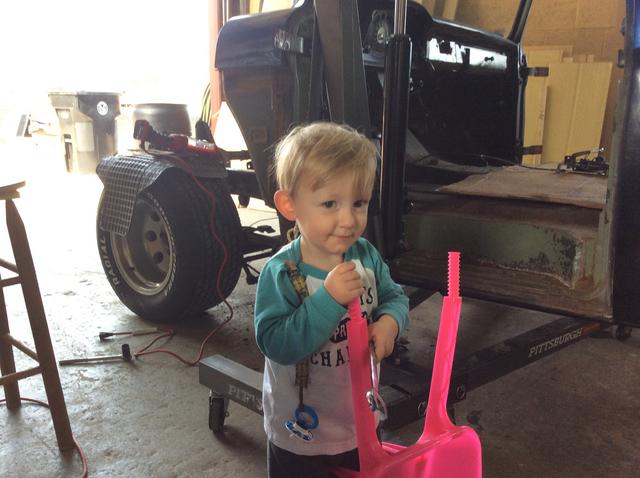

Ok pretty good weekend. My grandson spent the night lastnight and son Chris came over this morning to give me a hand and we made great progress.
Anderson loves trucks.

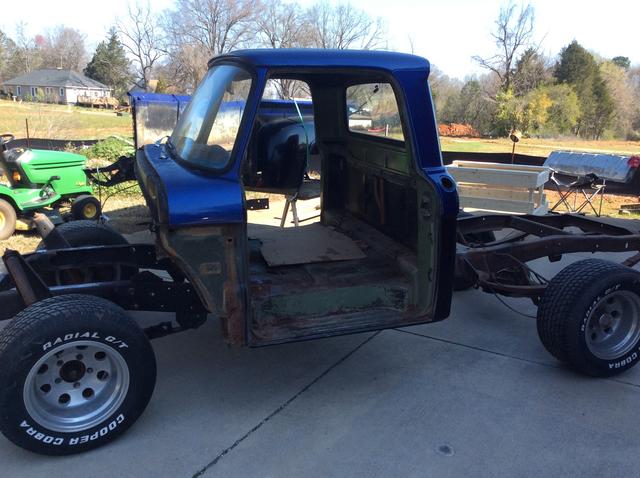

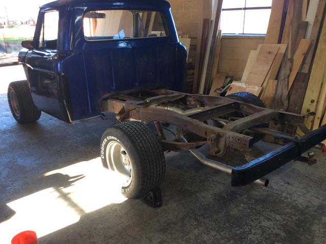

On Saturday, dad and I pulled doors, gas tank, Heater, steering column to get cab ready to pull.
On Sunday, Started with cab ready to pull off of frame.
Chris and I Used cherry picker and rig that local member let me borrow, and worked like a charm.
And set down on the bed dolly i made.
Broke out the pressure washer and frame got a bath, turned out pretty good.
Washed cab and shop while im at it.

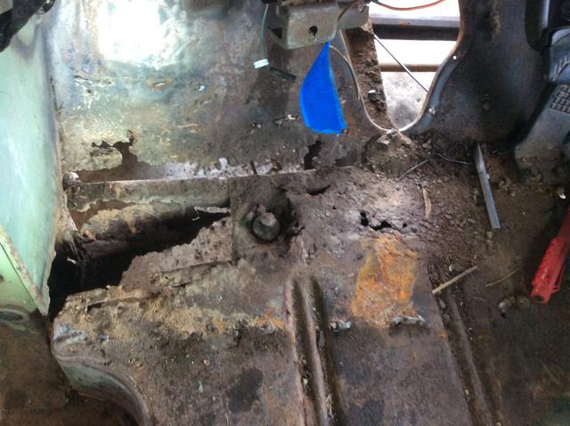

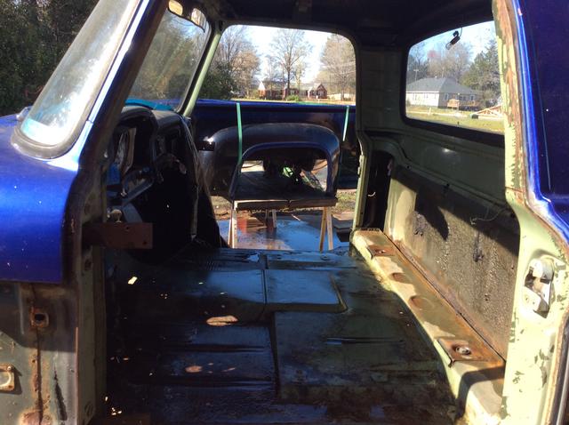

I knew i had floor panel rust and the drivers side front cab mount is gone, but there was a piece of diamond plate sortof welded over to cover, removed that and can see the extent of floor damage.
Really appreciate all of the advice on the site and special thanks to local member who really helped me out with the loaner cherry picker rig and advice. Could not have gotten this done this weekend without it.

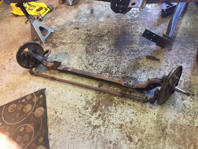

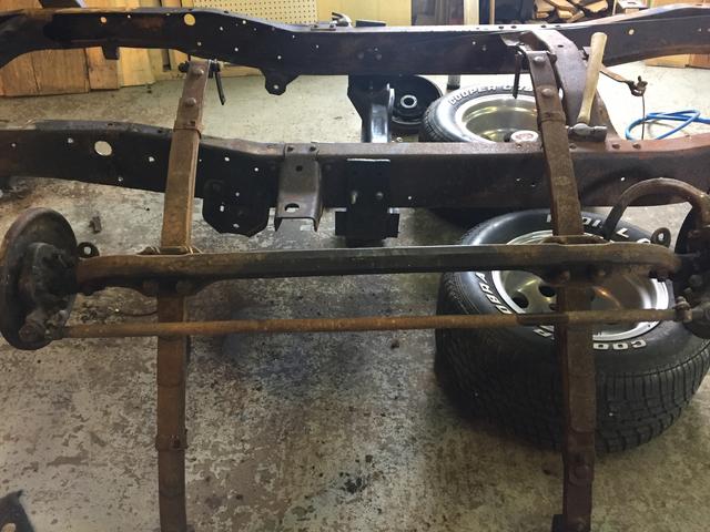

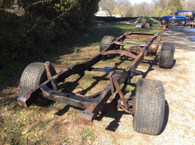

Got frame and suspension disassembled this weekend. Dad came over saturday And helped. My logic is that i have to replace the leaf spring bushings, king pins brakes etc., so i may as well break it down prior to sandblasting.
Seperated springs from frame and axles.
Obviously never been off, was a little stubborn coming off. Lots of PB blaster and a big hammer. I cant go any further, i sure hope it goes back together easier. I have all new spring bushings and bolts, so will break down leafs and press out old bushings before taking to blaster.
My plan is to sandblast and then prime and paint the leaf springs. I have seen what looks like rubber sheets that go between the springs. Should I use them? I have also seen a bracket extension for rear springs to drop the rear end a couple of inches. Anyone have experience or source for those? I have seen them for 65 and 66 , but not specifically for 61-64. Are they different?
Ready to stop tearing apart and start reassembly.

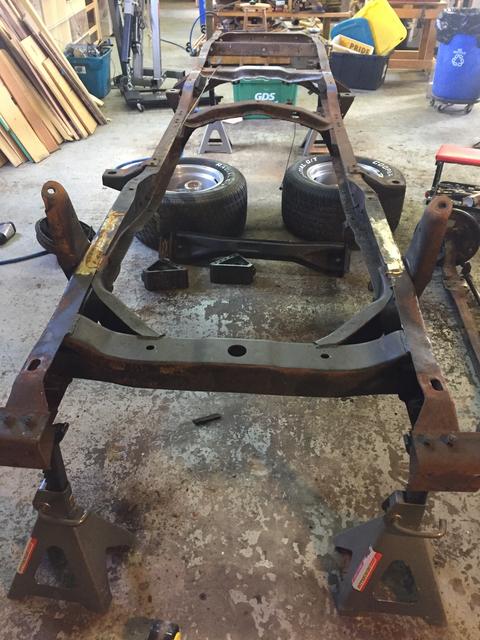

Ok, been a bit since i have gotten any work done. Sent frame, leaf springs , axles to sandblaster and got back last weel. Set up redneck paint booth and sprayed frame and parts. First time using the china freight purple gun, and struggled a bit getting the setup right. Finally i was able to get spray if i closed the fan setting down all the way. So was like painting with a rattle can, in any case, i was able to get a few coats on and seems to be OK.
I was spraying PPG ALK-200, chassis paint ( sandblaster dude recommended) , but i may not have thinned enough. Gun sprays fine with just mineral spirits thru, but cant seem to get enough paint to flow. Still have some parts to paint, so i will have to experiment a little more.
Before
After
Leaf Springs and such
Ready to start reassembly process. I ordered new ubolts, have pressed in all new leaf spring and chassis rubber bushings. So hopefully, i have all of the pieces to put it back together. I still need the little clips that hold leaf springs together, old ones tore apart getting off.

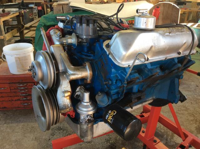

I have the chassis reassembled, new bushings, ubolts, shocks, kingpins. Staying with drum brakes, so had rear turned, but had to buy new front drums, and had to un-swage the drums from rotors and had my machine shop buddy lightly turn and press in new bearing chases. Replacing all og the guts of the brakes including cylinders, lines etc.
Motor and trans back from rebuilt and reassembled, so set them into chassis to check fit, clearances etc.
I removed the frankenmounts that previous owner had used, and went with trans-dapt motor mount kit. Good news is that it sits the motor down in the truck, much nicer, bad news is now headers dont fit so, having to put stock exaust manifolds on to clear new mount and frame.
