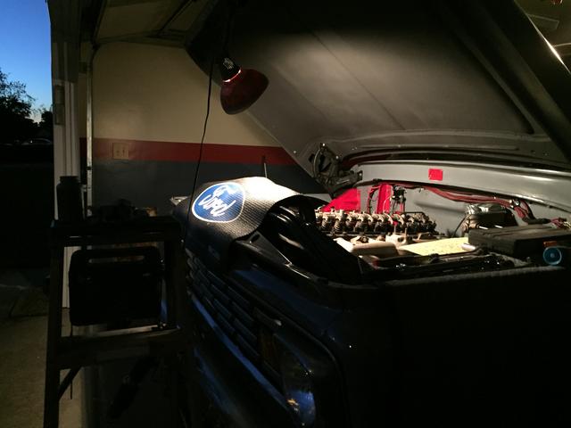

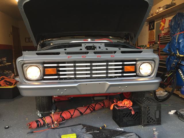

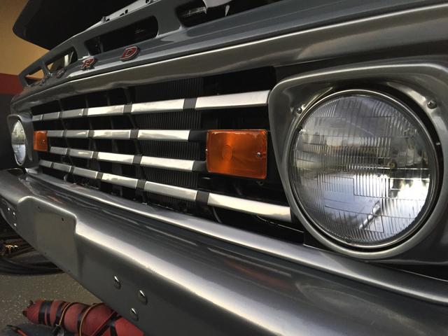

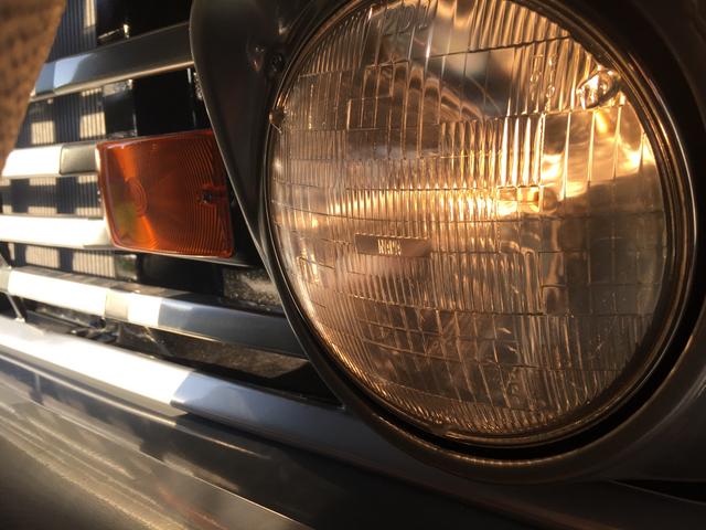

Installed my front grill for first time in over three years. Wired up and tested using a jumper at the light switch.
I drilled thru the holes in bottom of the core support to allow long bolts to be used instead of captive nuts. I had originally installed the captive nut when I painted the core support.
It was mid afternoon when I took this one. Had to put a shade over the lights to see them. Low beam success.
High beam.
Parking lights tested.

Success! I was able to get the rear tail lights, all park lights, hit beam, low beam and turn signal to act right thru the fuse panel from the battery. That took me all weekend!

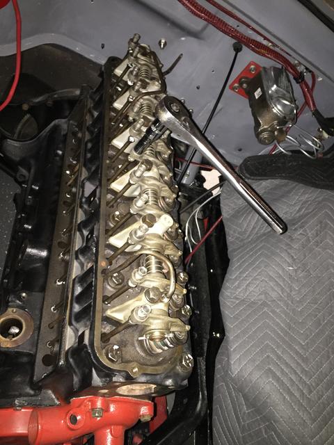

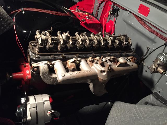

Decided to take a look inside the engine cause I just didn’t want to chance it the way my flywheel had rusted. 8 took the head off, As it was not torqued down fully to spec in the move. Cylinders look great . And since I could see the pistons travel, I marked my damper at TDc for the cylinders. 1&6, 2&5, 3&4. Obviously one is on compression while the other is on exhaust. I marked it so I wasn’t guessing when each was coming up. Remember to read your shop manual regarding your engine! We had a fun talk about timing marks on FB last night when I posted this photo.
Did have question.... the shop manual said to put a sealer on the head gasket. In all the years I’ve done engine work in the CG (gigantic Diesel engines) we never put a sealer in there’s. The weight of the heads never called for it,

April, regarding the head gasket sealer, that may have been required for a plain steel shim type in the past. I use copper spray gasket adhesive for plain steel shim head gaskets. Modern head gaskets are either graphite coated or MLS (Multi Layered Steel) and neither require a sealer. What type of gasket are you using? I would go by the manufacturer recommended procedure of the head gasket. Everything is looking good!

Hey! Yeah this is multi layered steel. 8m just gonna torque it and try. Need a thermostat housing for my 223... I can’t find mine! :x moving with a project is a terrible idea.

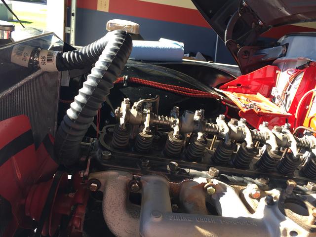

I’ve been working on various things but mostly the engine. Realized I couldn’t find my feeler gages, I had to buy some this morning.
Was able to do the cold preliminary valve lash first this this morning. All valves set to 0.19 as per manual.
Got dark out and I want some snuggles from the pups... I fed them chicken for dinner so they’d love me.
Issue I’m facing tonight was the fan bolts that attach to the water pump don’t work right. Like the threads on the flange of the pump shaft are wrong. Pain in the but since it’s already in the truck and sealed.

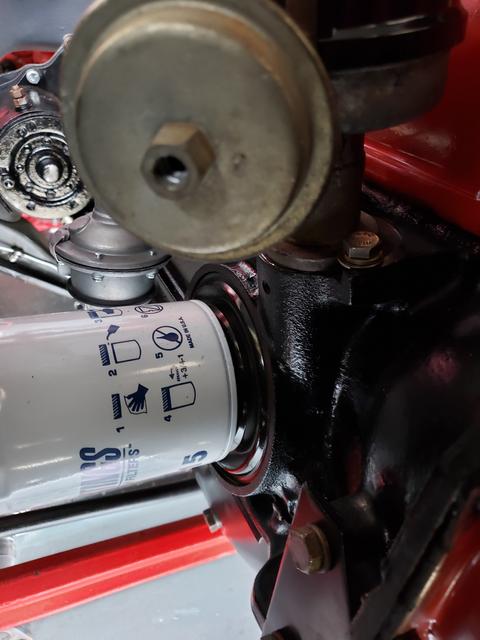

I put the stater in place, oil filter (spin on), coil, alternator, found my distributor and just slid it in the spot. Attached the heater hoses to the heater core at the forewall. Put 4 qts oil in the sump and if reads 1/2 on the dipstick :D once it’s primed up the upper gallery I will add a little more. Using straight 30wt shell rotella found in the diesel truck section of my local pep boys.

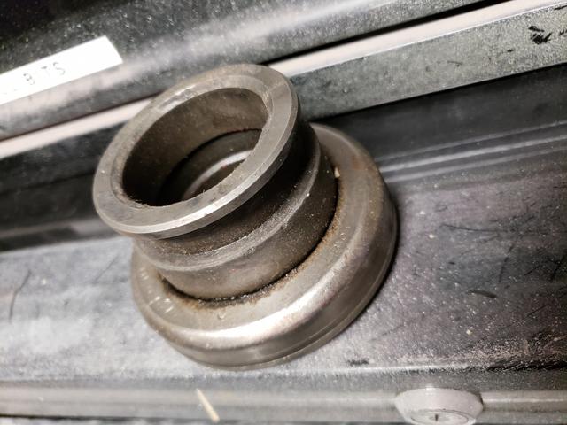

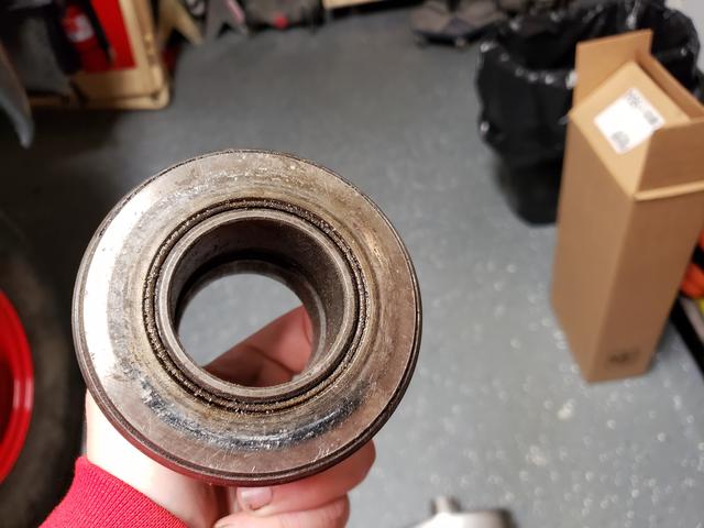

Took the lower cover off to access the clutch, and I guess I never installed the throw out bearing, cause it wasn’t there, hmmm... must locate this.

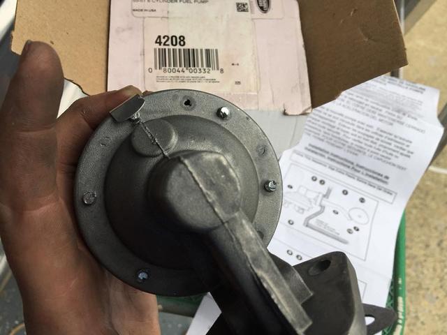

Opened the box my fuel pump came in from DC, it had a hole in the top.... I emailed the, about it. The original fuel pump (with glass bottom bulb didn’t have a hole.

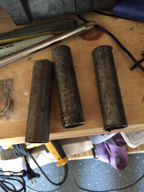

Made my spacers for the engine mounts. I’ve installed the rear two, but stripped the grade 8 nut for the front when I realized I had no threads left on the grade 8 bolt and it wouldn’t click on torque. A new bolt(shorter) and nut have been purchased.

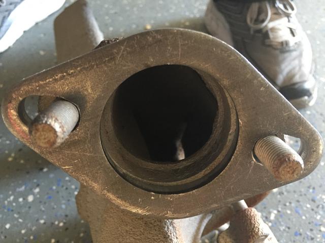

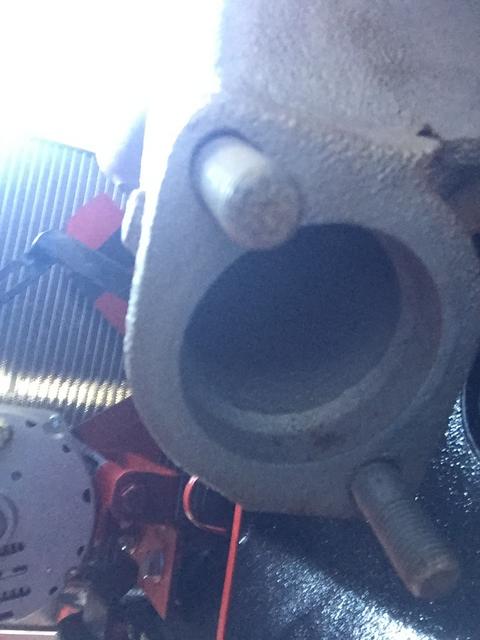

Need to fit a exhaust flange adapter to my manifold.
Cut the flange off.
Wallowed the holes to fit.
Welded the tube on the flange. Just need a flat gasket now.

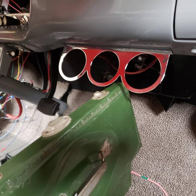

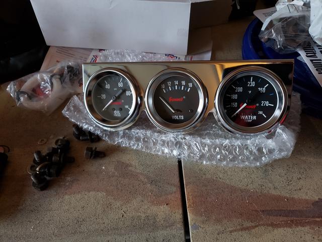

I have been debating how I am going to instal the radio and gauge pod, it’s gojng to happen but I am not cutting my dash open. I will figure it out. We are beyond a factory correct anything here.

A week ago I posted about needing a exhaust adapter for the exhaust manifold. Muffler shop helped with this. I had purchased the flange piece, but they helped fit it so I can bolt on and put on a off the shelf sort of exhaust until I can afford to do a nice one.

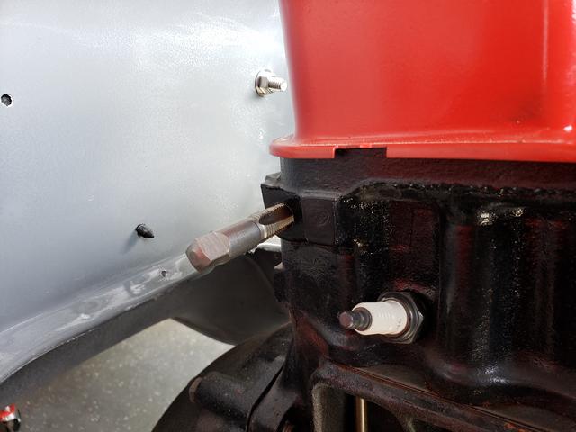

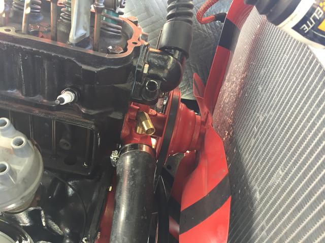

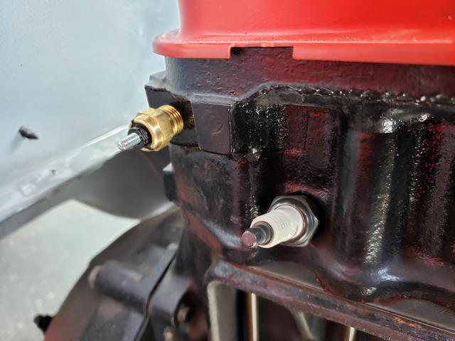

I got the sensor situation figured out with the help of you guys on FB.
Had to tap the head with the 1/4NPT for the coolant sensor.
Coolant temp sensor and oil sensor installed.

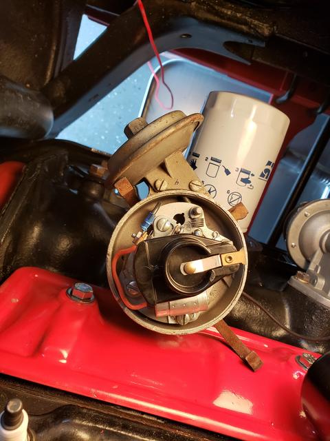

Then realized I couldn’t find my distributor hold down. When I took apart the engines, the distributor was held down by a claw. Well, the box I had distributor stored in was busted out and I lost the claw. But with help from Pat Weller and Richard Freer I just need to put two bolts in there to hold it down.

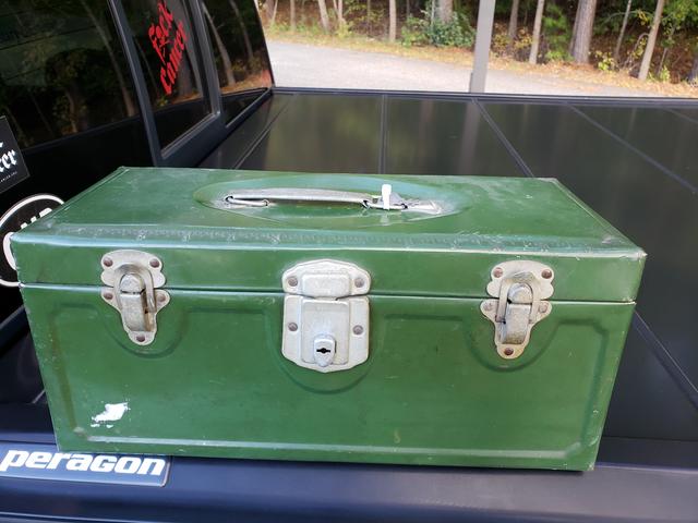

I want to build a center console in the truck now and kind of thought about using an old tool box or tackle box. Tool boxes are too big. This one was given to me by my old NJ neighbor Bill. Just too long. :cry: so I’m looking around for a tackle box. It will hide my radio and a cup holder and gauges.Image

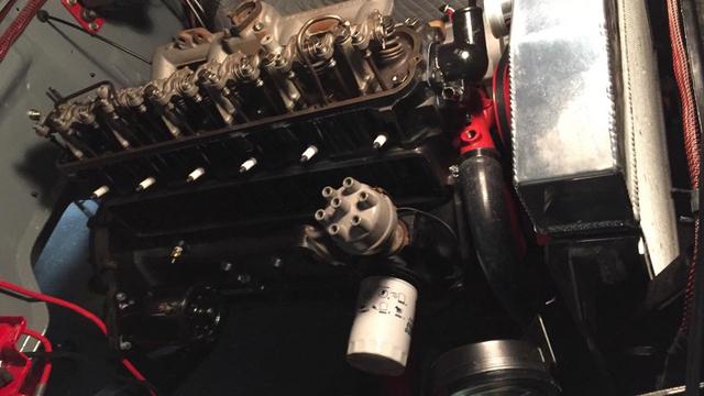

But by the time I got home it was dark and gloomy so I decided to find something to keep me busy but not sitting on my couch.
Old distributor cap.
New.
Setting in the engine properly
Cables hooked in their place.
So I need to check the vacuum on the diaphragm. It was good when disassembled but it’s been a few years.

Also look at this: found my throw out bearing.... ImageImage
gonna order a whole new clutch kit for the truck. I was going to reuse the old one as it looked good, but dang it’s rusted now after sitting three years.

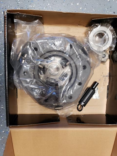

After last nights chat help, I located a clutch kit with the 10” disc, 1 3/8 diameter 10 spline.
Got the pressure plate and throw out bearing as well.
The other items I completed were torquing down the motor mounts with this homemade spacers in between like it should have.
Found a tool/tackle box at an antique shop for cheap and it fits right in the gap on the center low hump.
With the gauge cluster mounted (it’s yonna get painted eventually), it’s lid clears no problem.

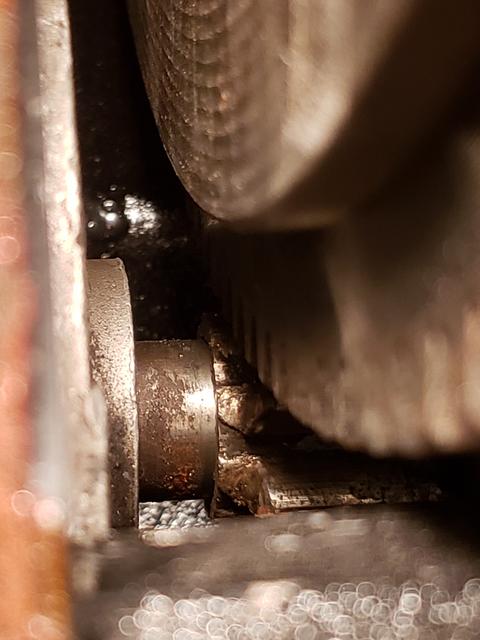

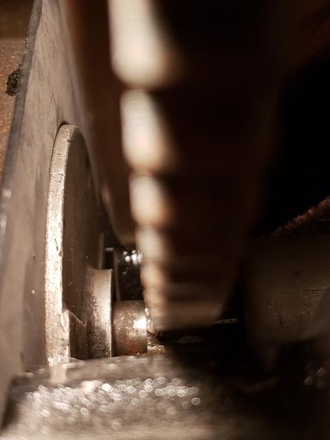

Next two photos of are the flywheel and my starter. The clicking I am hearing is the flywheel touching the starter gear.
If I spin the bendix the starter gear turns to engage.
Is this right? In a dead state it is barely engaged.

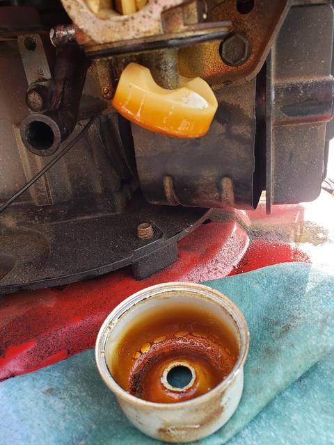

Instead of working on that, I brought this Troy built back to life.
Someone left gasoline in it for a few years.
This vacuum mulched said it could handle acorns but it’s very inefficient. Took a long time to clean my yard. Will bring it back to work tomorrow .
