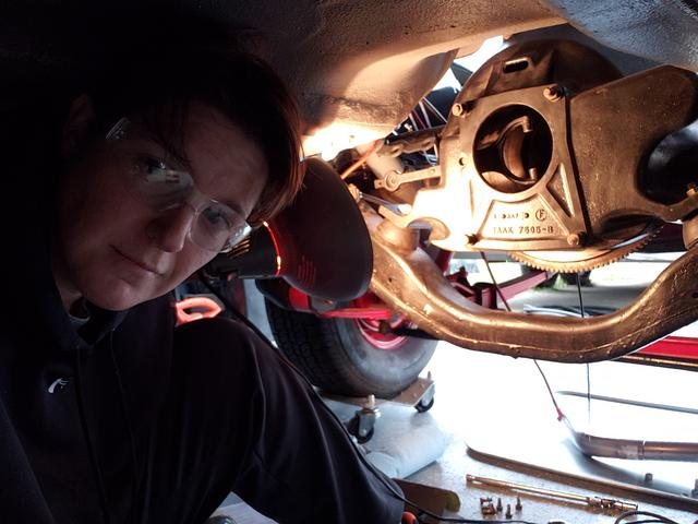

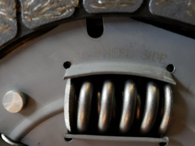

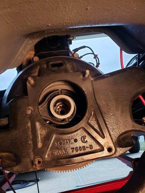

Yesterday after leaving work- after I told myself I would take the day off,,,, I got home and started working on the clutch.
Not a lot of room in here, but I could sit up okay.
Thankfully my camera has zoom! I can’t read the yellow print when it’s this tiny. I have a hard time with yellow print period.

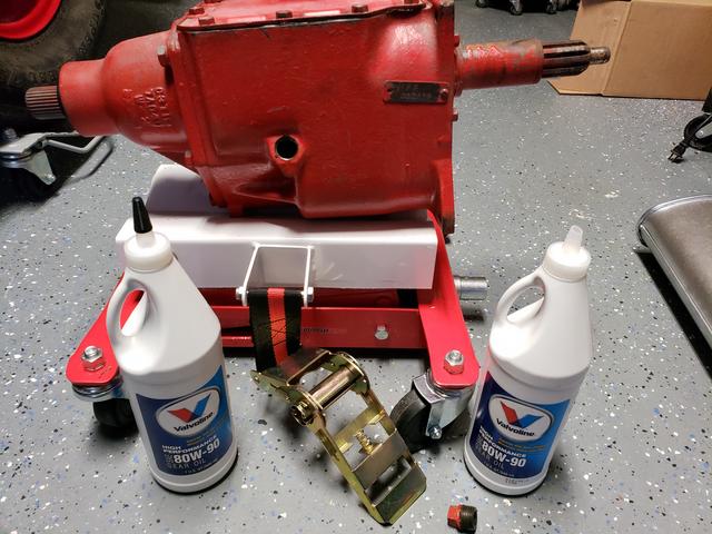

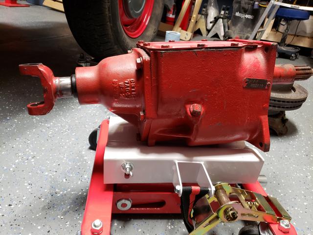

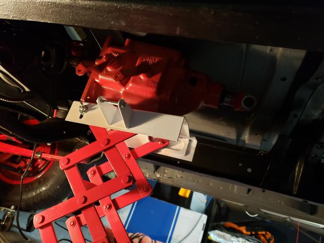

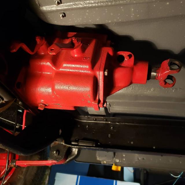

Transmission time.
Oops... I guess I shoulda put the slip yoke in there.
Positioned ready to go.

Oh and I started wondering if I out loctite on the flywheel to crankshaft bolts over a year ago.... :shock: :oops: I can’t remember.....I’m sure I did... maybe....

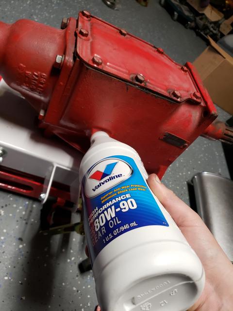

That’s a nice shiny looking trans. Why did you go with 80w90?
Posts: 1487
Re: my shipwrecked '63
Well, after many google searches and reading other forums about which oil to use, (90w), the off the shelf availability is hard to get here. I use 80w90 in the rear end, and 80w90 is similar in viscosity.
80viscosity at low ambient temp and 90 at 214*(100c) temp.
In a lot of the gear boxes and hydraulic systems I’ve worked on in the CG we used 80w90 when straight 90 not around. (Maybe insert a smiley of I don’t know it’s what I’ve found” kind...
I’m not sure I’m going to be hammering gears much. It’s pretty thick stuff.

Thanks, That makes sense and is good to know. I went with 50w per my 61 manual and it was a pain to locate and was expensive. I’ll be switching next time.

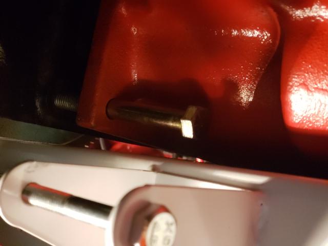

Grabbed a few longer bolts from the bolt bin in the garage and threaded them on the Bell housing lower holes. Using them as alignment dowels worked great! It took like 5 minutes to get the transmission in that way.
Tightened all the bolts . This transmission has been out of the truck since October 2015. A full three years!
New U-joints and the shaft is installed.
Having a transmission jack and using those two longer 7/16-14 x3” bolts made this a simple job.
Onward!

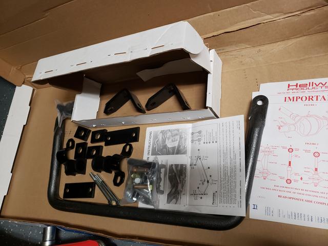

My front sway bar I ordered in Sept finally showed up. It’s a helwig for a bronco 2.

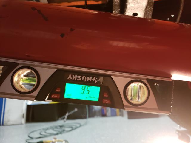

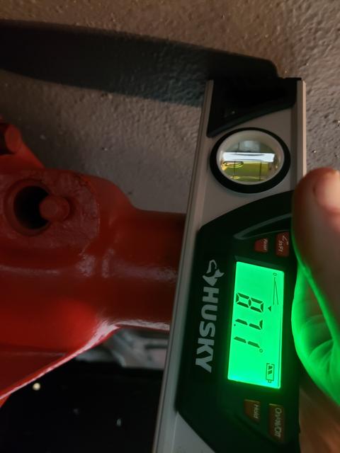

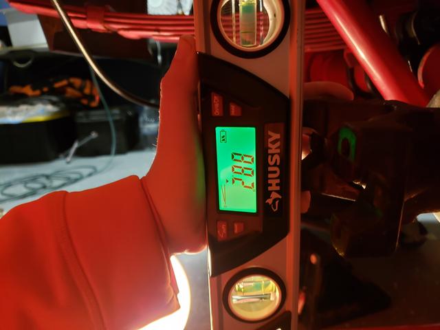

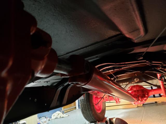

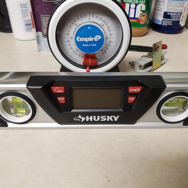

I did get to the garage and measure the driveshaft pinion angle.

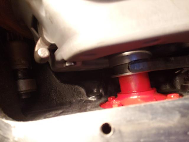

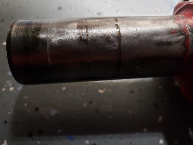

My slip yoke only goes in the transmission by about an inch. White Mark is where the oil seal is.

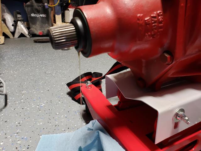

I had to drain the transmission because it was leaking on the rear. I took the housing off and put a thin bead of oil resistant Zealand around the edge. Put back on and put 1qt of oil in, I need to buy more,
I hopped the clutch linkage to the z-bar up and cycled the clutch a few times. Works good. It’s still though cause it’s a three finger clutch pressure plate.
Ordered this helwig sway bar for a bronco2 two months ago, I’d finally showed up. It’s heavy, but dang it seems so small. Hope it fits. Following Uncle skips thread on this for the front.

Conclusion... I am going to measure the driveshaft again, the slip yoke and look at a replacement driveshaft with a deeper insert of the slip yoke. That 1” inset make me nervous,

it looks by the grooves in the yoke you might need a new yoke as well.it can cause the tailshaft seal to leak.
unibody madness
Posts: 2147
Post by unibody madness »
April you can have the yoke trued at the drive line place. Are you doing your measurements with the assembled truck on the ground? If so bounce on your bumper to make sure your springs are set and not hung up on your shackles, or sway bars.
