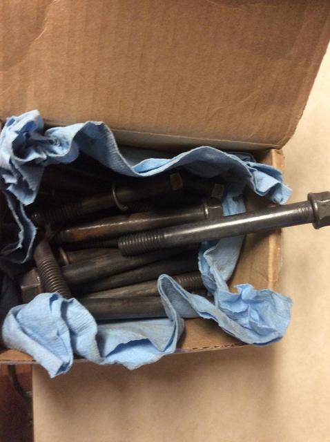

The 223 headbolts are headed your way
They came out perfect & look good
Should be there Wednesday
Hope they work for you

Head bolts Pat sent got here. I’m off a few days this week and will get in my garage working on the 223.
On the return address of the box, Pat wrote “save the 223”. Perfect!

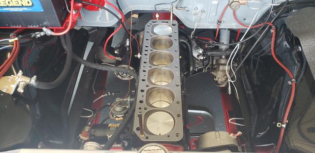

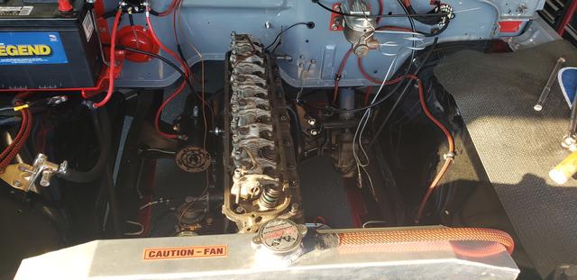

So mistakes have been made on my part. So many mistakes.
I am gonna take a whole step back here and say this- I was real wrong
my engine is from a 60. The truck is a 63. The book I use for this build is for a 63. They are not the same...
The arp bolts are the ones I used . ARP sent me an overnight package of the order I’d been waiting months for. It arrived on Friday. Pat had sent me a box of bolts from a truck he has in the stash. (pat sent the 223 bolts for a 63- I used the rocker rail bolts he sent though)
The engine with a 7/16-14 head bolt is what I have in my truck. I didn’t realize there was a difference till I got Pats box of bolts and I took them out to start my project. The ones he sent are 1/2”.
Standing confused at wtf just happened, I started reading on the website for Headbolts.com and on forums- that they had different head bolts (I knew the heads were similar but with different valve cover attachment). They have different torque specs. No wonder I stretched the dang bolts in March! I was putting 105 ft pounds to a bolt that should only be torqued to 75.
So, I have the arp bolts in the head, and Pat’s rocker arm bolts, rocker arm oil tube and keepers in the head.
I got two 7/16-14 x 5 inch bolts and cut the heads off. Chopped a flat head slot in the end and used them as guide pins for putting the head on and keeping the gasket alignment straight.

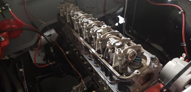

Tuesday I was off. We get “stand down” time before underway now. Back in the days I started this career, we got 1 day off per month gone. It’s different now- command discretion- but in this case- more time off!
I spent my day setting valve lash. I made some notes for which valve is in which position so I can easily check which stroke I’m on when I set my distributor. It helped already as I went back through my notes on here and didn’t see where I put locative on my flywheel bolts and I just had to check. So transmission came out, checked flywheel (glad I did) installed flywheel bolts one at a time again with locative this time, installed my clutch, put transmission back in etc. spent all day doing this.
Lots of heavy rain, thunder/lightning today too. It was getting too steamy and actually lightning was danger close so I closed up shop for the day around 5pm.
Took the dry shipwreck and out some JB weld in his body cavity where I will tap for a 1/4-20.
What I’m thinking for air cleaner wing but.

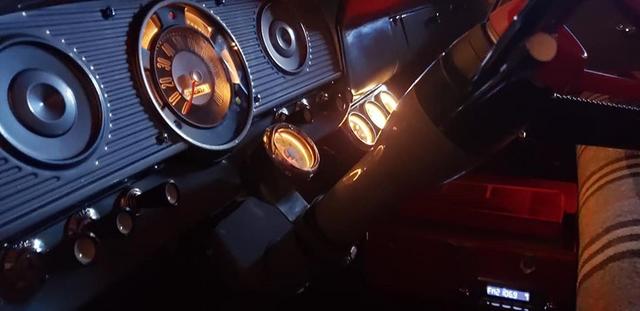

I took the dash panel apart back in summer for something... no idea what.
Wired it back together, and see that my rear emergency flashers don’t work, And I had disconnected the rear white lights I installed, but don’t know why I disconnected them.
The radio works, the lights, gauges, tach all work.
Horn doesn’t.
Need to figure that out. I’m about ready to start the truck. I guess I’m scared to because of all the hassle I’ve had this year with it.

Don't let an antifreeze drip worry you
After coming up to temp one time
Gaskets can seal up some
- Posts: 1488
Re: my shipwrecked '63

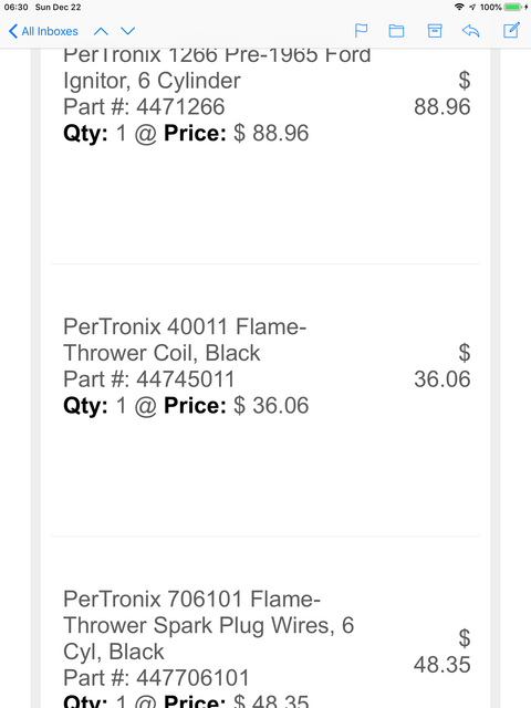

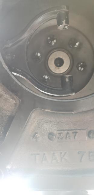

Struggling to get spark. Haven’t had too much time to work on the truck as I have been doing a kitchen update in the house.
Went ahead and got a PerTronix set up ordered to eliminate the points. I hope I got the right stuff.
