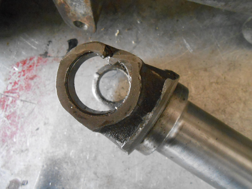

Well Merry Christmas to me....yesterday, my truck broke down on the local interstate. Had to have it towed home....finally. It's hard to find someone to tow a vehicle on Christmas eve. Anyway, the bracket that attaches to the frame that the clutch Z bar rotates on broke. I got on the interstate and when to shift to 5th gear and the "nub" that the Z bar rotates on sheared off. It was a loud pop....and then....no clutch. Anyway, I've found one on ebay from a '65 that will work, just waiting for the seller to accept my offer. In the meantime I will probably try to repair the one on my truck. And I realize that there is a grease fitting on the Z bar which has never been greased in the seven years that I have owned the truck....and probably in many years prior. So...maintenance IS important! Find those grease fittings and squirt grease....lol. Anyway, if this is the worst that happens, then I'm going to be okay. Everyone have a great Christmas and a Happy and Safe New Year....and 2022, incidentally sounds like "2020 too"...lol.
Z bar bracket fixed (welded) and I'm on the road again. I ordered another from the interwebs and it will be here later this week. All is good....Happy New Year to everyone....stay safe!

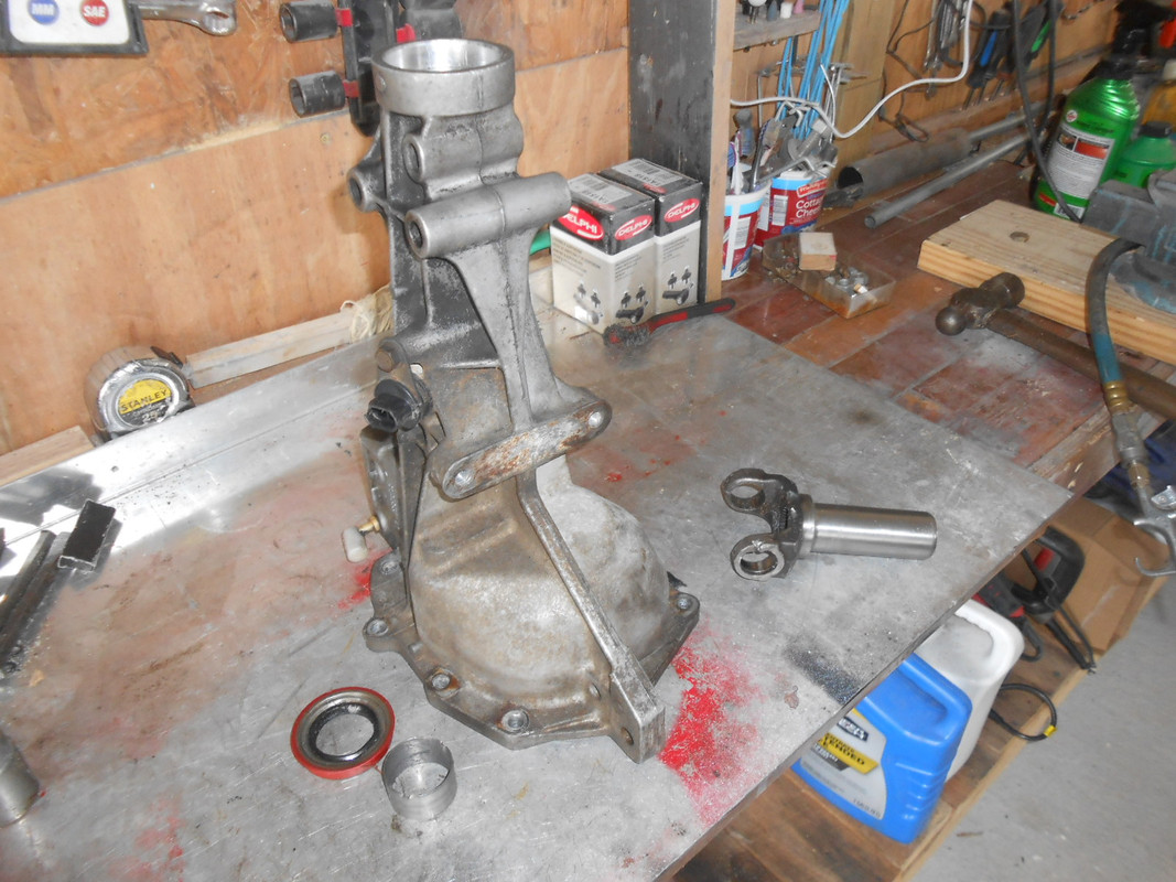

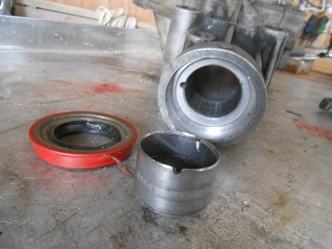

Dealing with a slight "roar" in the driveline at 55-60 mph. I have determined that the tailshaft bushing in my T-5 was worn. One of the
"signs" is fluid leaking, even after replacing the seal. So I have the tailshaft and the driveshaft at the driveline mechanic. He was hoping to have it finished today...IF the bushing came in. Undoubtedly, it didn't come in. Hopefully tomorrow.

New bushing and seal in the tailshaft, but it is still leaking. A drip at a time...I've read that these tranny's are notorious for this. Anyway, it took care of the "roar" in the drivetrain. It is smooth. I might search later for a 302/AOD or a 351/AOD....right now all my $$$$ (vig) is going toward gasoline :? (thank you Biden)...
Went out and rechecked my tailshaft situation this evening....it is NOT leaking. There was a small "wet" spot on the underside of the tailshaft at the end...but no puddle at all on the floor. Now to go get a "gasoline loan." Btw, I heard that Biden was in the hospital.....he couldn't stop Putin (pooting)... I'll be here all week.

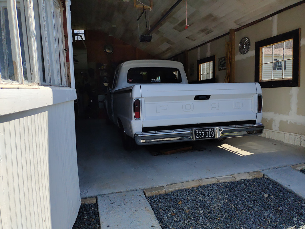

Spring has sprung! Got the truck out yesterday and ran some errands....also took some pics. It was a beautiful day so I took some time in the garage and "piddled around", lol.

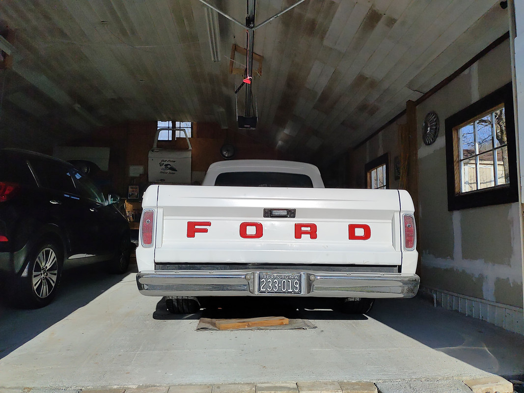

Here's my tailgate "before"...
And "after"...

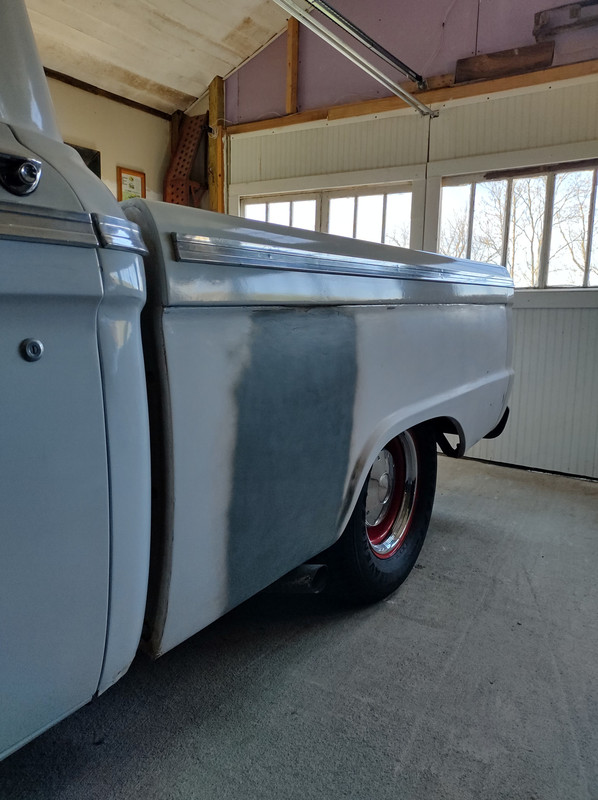

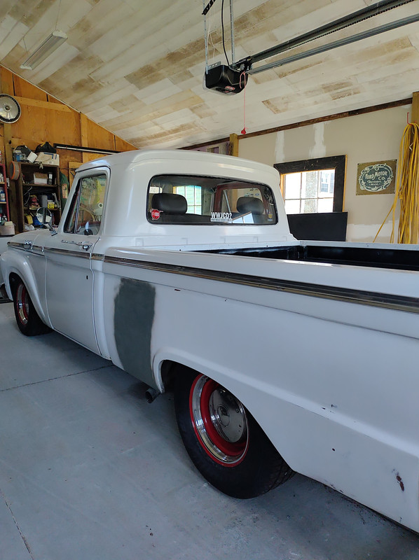

My plan over the next few weeks is to rework the bedsides. I rushed to get them painted and now the paint has "shrunk" and I have scratch marks, etc. showing up. Novice mistake....I knew better. Now to fix it right.

Started on the bedside repair yesterday. Forgot to take pics, but here's the result so far...
I am going to shoot some hi-build primer on this area of the bed and let it shrink for a week or so. Then shoot some more white on it.
It is definitely not a "show truck" by any means, but I want it to look better than the "bubba painted it in the backyard" truck. No offense to the bubba's out there...

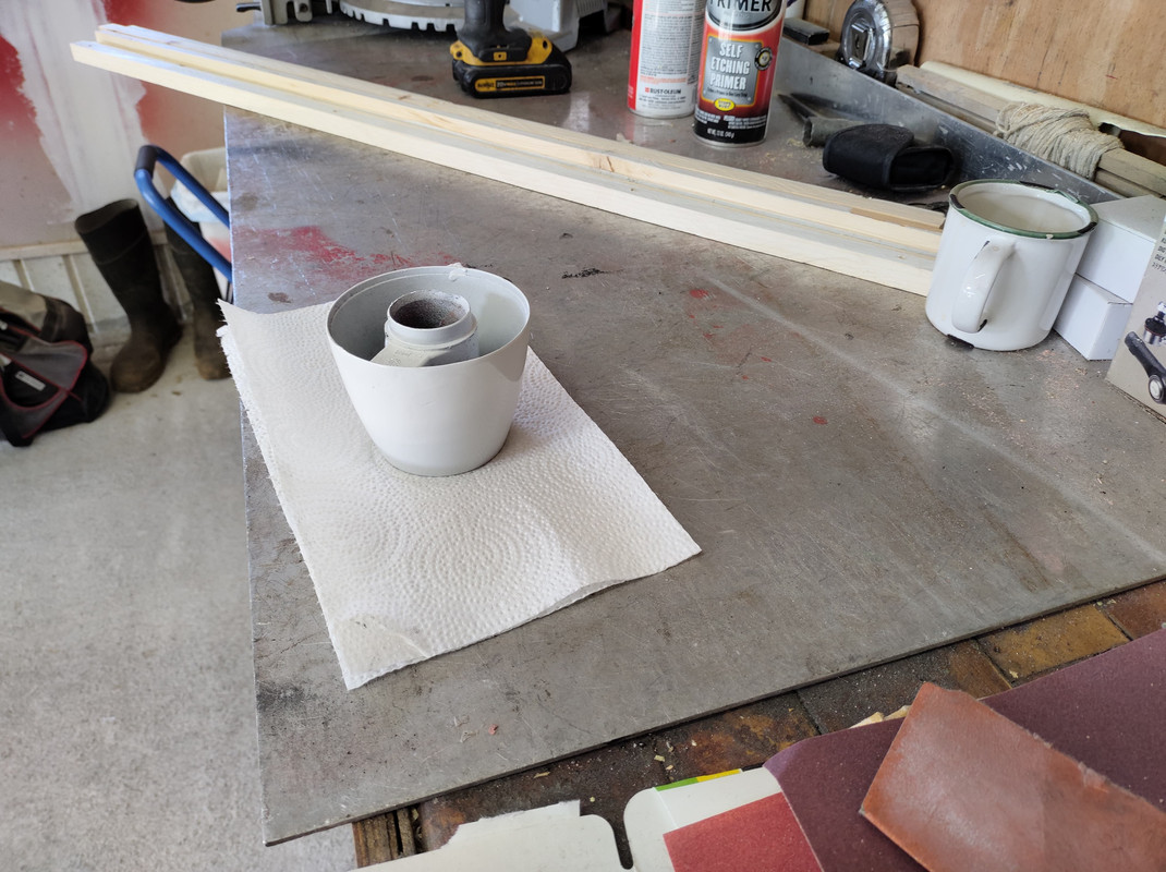

I recently became aware that my turn signal did not cancel when making right turns. Since regular driving requires said turns, and I use my signals, unlike the majority of people driving out there, I needed to find out why it was not working correctly. I found the plastic cam had the right turn arm broken off. This was the same plastic cam that I replaced about 5-6 years ago. It was brittle...anyway, I ordered a new cam from LMC truck and I ordered the wrong one. So while I had the steering column apart I decided to fix....read "modify" the 'collar' since I have the T-5 floor shift. Here's some pics...
The Mess...
The "Collar" after removing the bung (I don't know what else to call it, lol) from the side of the collar. I should have taken more pics, but I removed it with my 4 1/2" grinder. Sadly it is potmetal, so I couldn't weld the opening up. I used a secret method to fill the hole.
...and pics of the column after I put it all back together. It looks much better....it's small stuff, but it makes a big difference to me, lol.
I did order a new entire switch from National Parts...so I'll have to take the wheel off again....anyway...stay tuned....

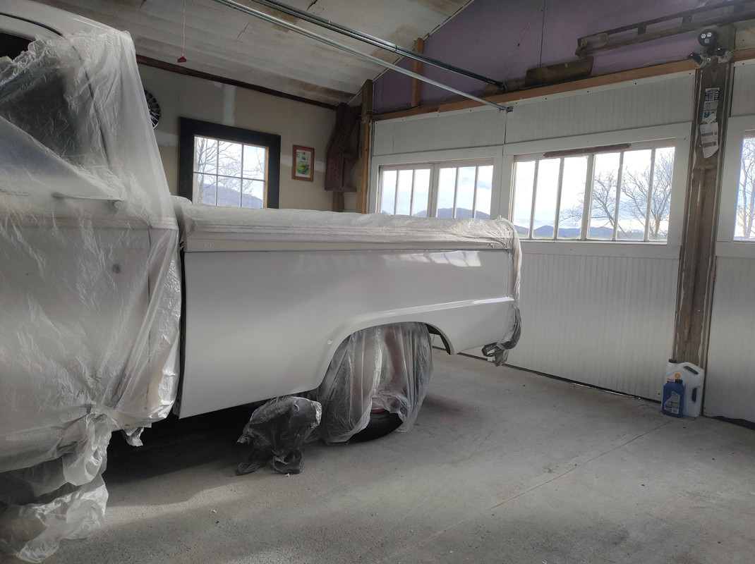

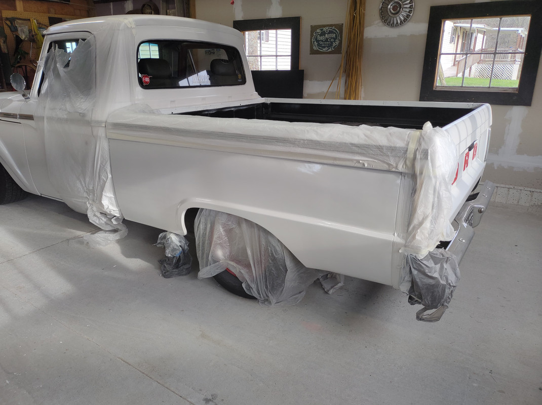

Bed side repaint this afternoon...the first coat...
I shot the second coat on and with the lighting I couldn't see how heavy I was shooting. Got a "line" or sag in the paint....grrrrrr.
I will let it dry overnight and see if I can sand it out with some 30000000 grit sandpaper and reshoot.
"Sags" are my signature. That way I know there is enough paint on the panel so I shouldn't have to worry about rust coming back through :D :D
