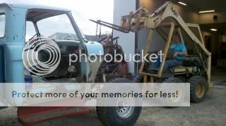

Well, I finally got the courage to post a build on here......
Drove my 'Blue Thunder into the shop this morning
This is what it looked like at 5 pm.... My mom (she's 87) asked me why I ripped up my truck
My plans ?
Out with the 223, in with 300 with headers & 4bbl intake & c6 auto trans
Dual brake master cylinder
Rebuild steering box
Refurbish interior
New wood in bed floor
New paint
Not going for car show quality.... Just make it a nice running farm truck to use

Is your engine hoist heavy duty enough for that engine. :lol:
Kevin

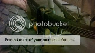

Re: Slick4x4 rebuild of a farm truck
Rear leafs disassembled , cleaned , wiped with oil & put back together
Took out bottom 4 leafs
(They are straight & only used when you have a very heavy load)
I installed a 3" block wich gave me about 1 3/4" lift
I re-arched the fronts years ago & they are about 2" above stock
New u-bolts and shackle bushings also

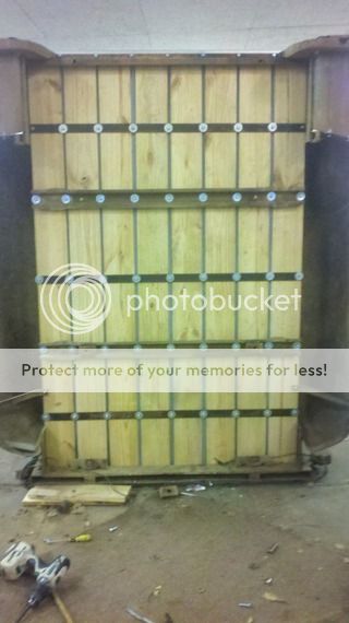

Out with the bad.... In with the new
Using treated lumber... 1x6 boards
They measure 3/4" thick ( which is the same)
But only 5 1/2" wide (the original truck bed are 6")
But doesn't really matter, the tin rails cover the gap anyway
Wood , New bolts & washers.... Got it all at Lowes for $60
Bed floor done ....
Rebuilding the bed I decided to "make it better than factory"
At least in my opinion....
Where the row of bolts that just had washers, I made a strap
Out of 1 1/2" by 3/16 ... and bolted it to the underside... Much
More support for just a small addition

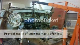

Setting the 390 in...
Fabricated some engine mounts out of parts & pieces collected over years
Transmission mount needs fab too
Going to have to shorten the driveshaft between trans & transfer case

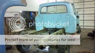

Seeing if things are gonna line up ...
Way to go Pat! Bet you will not have any trouble keeping up with the gang
on those road trips with that FE between the rails. Probably more like keeping
tires with tread on it now. HeeHee! :cheers: :steering: Keep up the good work!

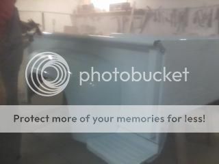

Crappy pic ... Cheap cell phone....
Layed down some paint....
Kinda rusty at it.... Had an issue with the fender :cussing:
Fixed it ...kinda.... I have to keep reminding myself ITS A FARM TRUCK
That looks a bit better....
Rattle can Ford blue.....
