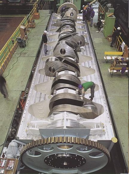

- world-biggest-ship-engine-i9.jpg (25.24 KiB) Viewed 2135 times

WOWIZER!
Mercules,
I'm guessing we're looking at a crankshaft for a 10-cylinder engine that will go in a LARGE BOAT?!
BarnieTrk
Mercules,
BarnieTrk
- Posts: 5441
- Location: Monroe, Louisiana
Re: What's the bigest Motor I can get?
SHIP not Boat
