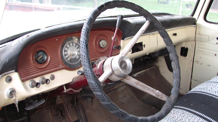

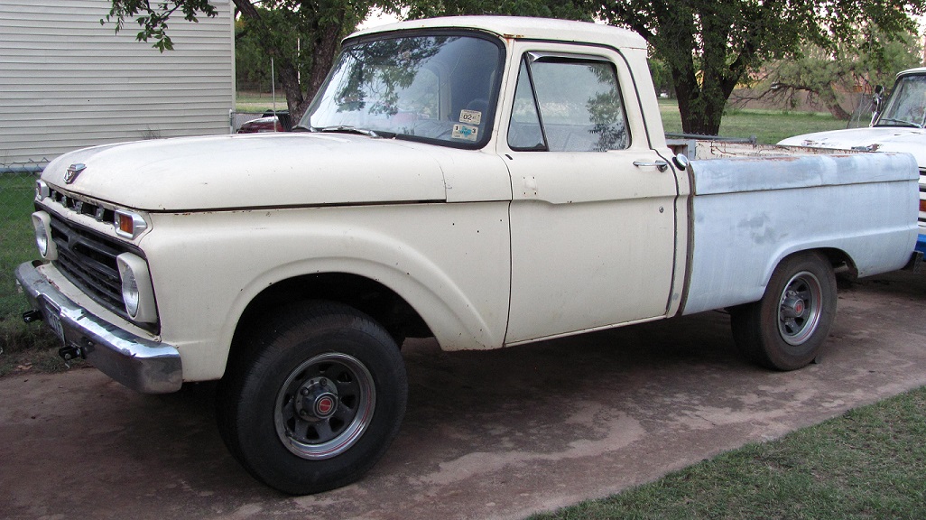

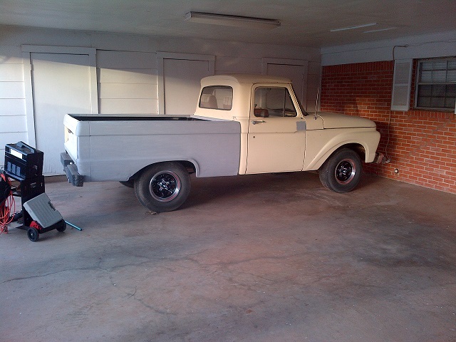

I bought this 65' off of Ebay in December of 2013. It had a 315w and a c6 trans that came with it. The truck was in pretty decent shape. Had little rust, mainly in the floor but nothing that small patch panels couldn't fix. It had been wrecked at some point and both front fenders, grill, (the wrong year) along with a different hood had been replaced. The frame is fine however. It was hit up high. Here are some pics of when I got it and what I've done to it over the last two years.

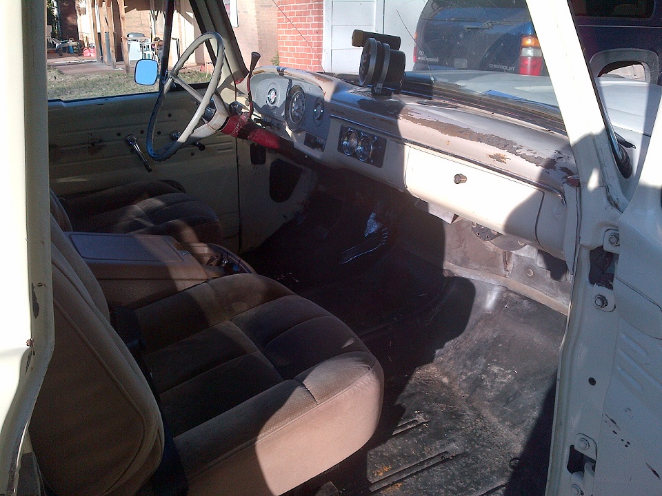

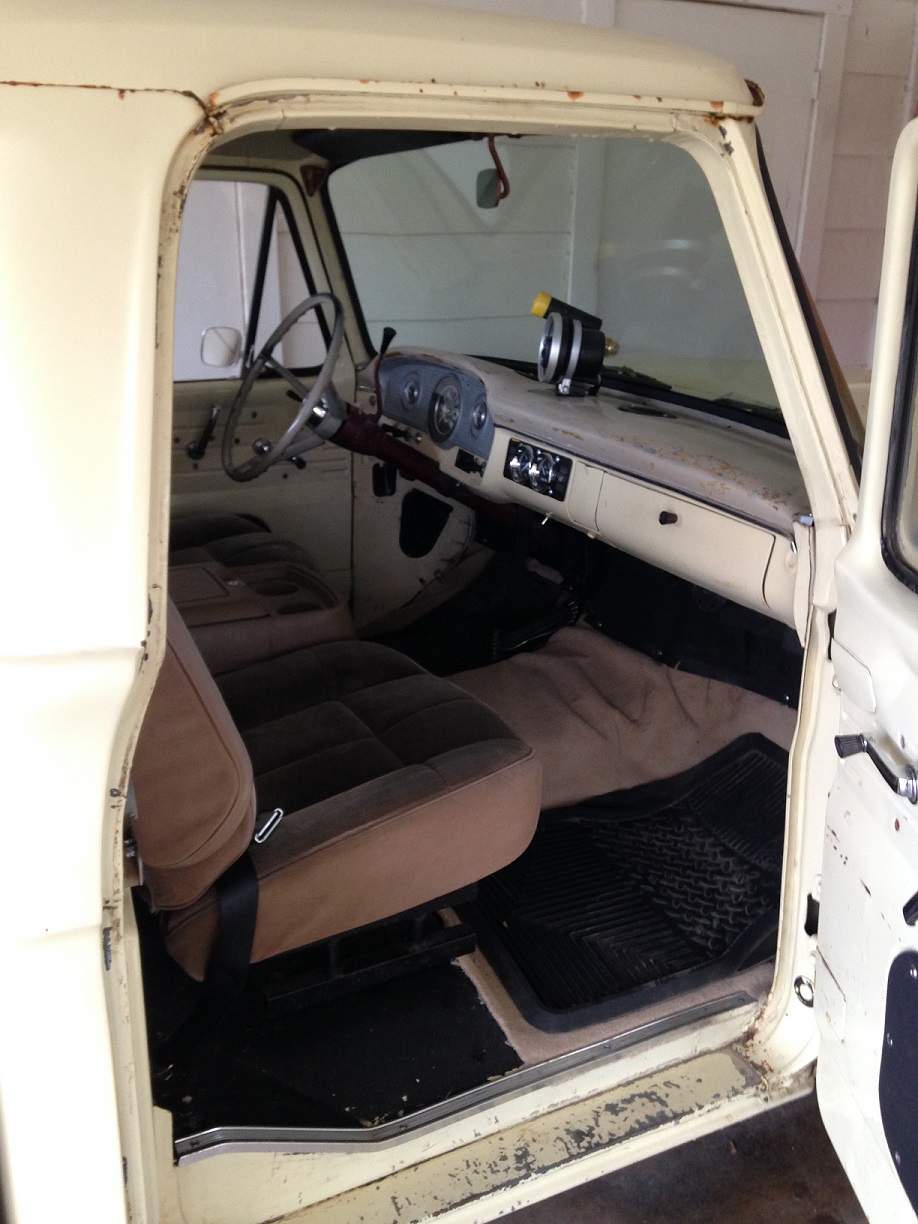

here is the interior. notice the cut out radio hole and the compass just in case you get lost.

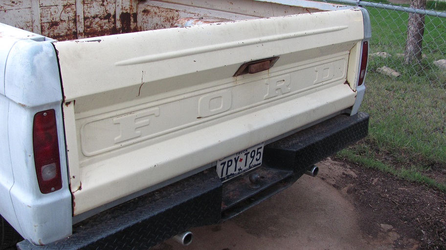

Tail gate and bed are in decent shape. Minus the 23 holes drilled in the top of the bed rails. That heavy duty bumper will have to go

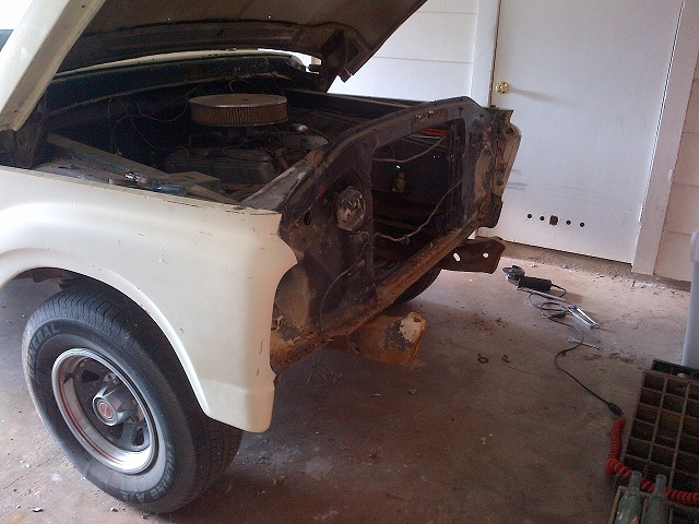

I found a 65' grill on Ebay. taking out the old one here, beating core support back into shape where fenders actually fit the bumper and grill. that's a 289 and c4 that i was going to rebuild for it. plans change.........

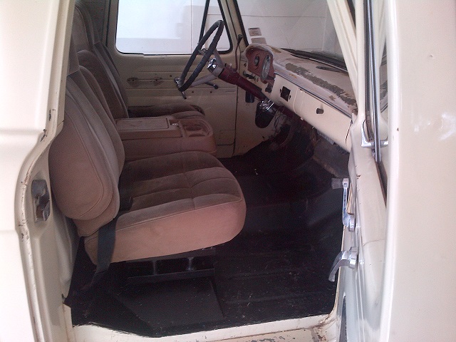

Here I had ripped out the old rubber floor, the rotten headliner and crusty dash pad. I found some 86' For Lariat seats and console in the local wrecking yard. POR-15'd the floor and deloused the rest of the inside.

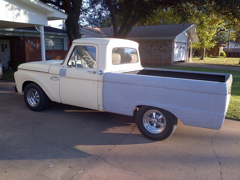

Here I was filling in all the holes in the bed along with the holes drilled for at least three different side mirrors it had. re-primered the bed sides, laid POR-15 inside the bed and tried some spider caps on the Ford wheels.

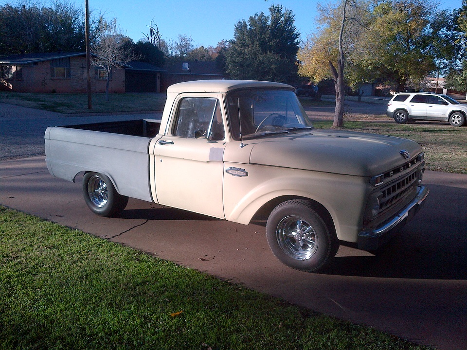

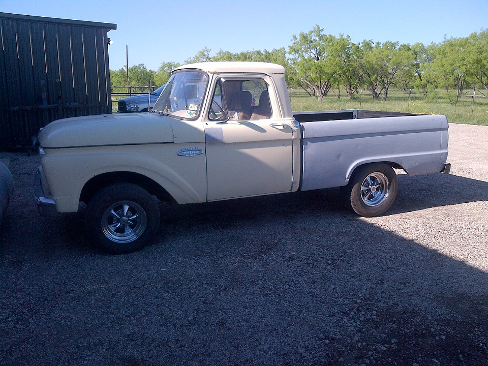

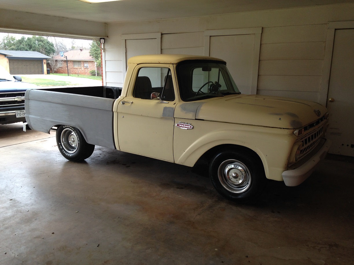

I had moved the truck out to the shop and replaced everything on the brakes and rebuild the front end. Somebody came by the shop selling these Cragar S/T's and tires. Glad I bought then. Still deciding on that motor.

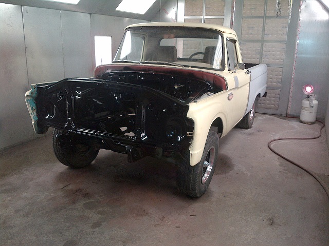

Before the wheels and tires and the mechanical, I soda blasted the engine compartment and painted it with AEU PPG Black

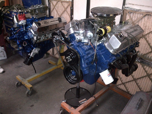

Finally decided on a power train. found a 460 and tranny on Craigslist. tore it down, had a gaulded cylinder. but it was repairable. It's bored .060, has a polished crank, resurfaced block, decked D3VE heads, Flat top pistons for a 9.2 to 1 comp. ratio, Crane RV camshaft, Edelbrock performer RPM intake, Crane roller rockers, Hedman headers, Holley 850 DP carb, MSD Distributor along with a C6 with a 2200 stall converter. Thats my brothers 521 stroker BBF next to it. It's in his 69' Mustang now. Makes over 600 HP : )

After getting it running, all the bugs worked out and building an exhuast system, I've been driving it to work 24 miles round trip. Has done great so far. passes everything on the road but a gas station. Rear bumper came off, planning on a roll pan when it comes time for paint and bodywork.

interior is livable for now. New rubber floor and headliner along with some sound deadening this winter. I love the seats. very comfortable. will be a tan vinyl with the inside painted Azure Blue.

Looks good. I like your solution the the hack job on dash wit the gauges.

super wheels and tires, that stance looks good.

i decided to sell the Cragars and tires I had and go with some steel wheels with hubcaps and trim rings. I like this better. Also got the bumpers and grill painted. Added new carpet and headliner to interior.

Really digging the steelies with the caps

Liked the cragars but the steelies give it a classic good look.
