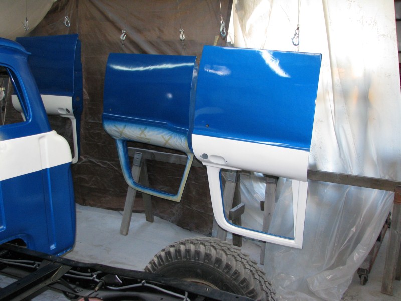

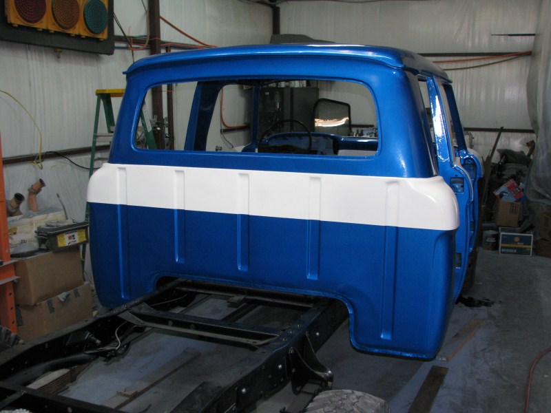

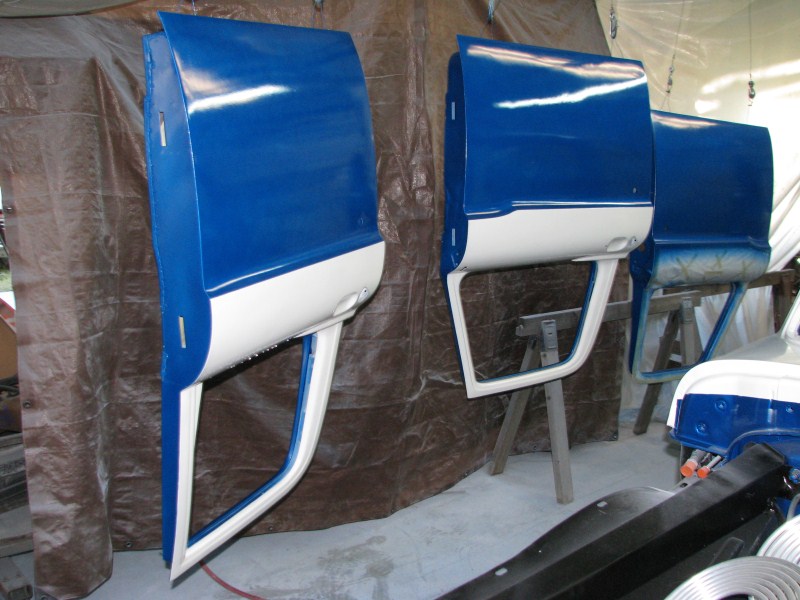

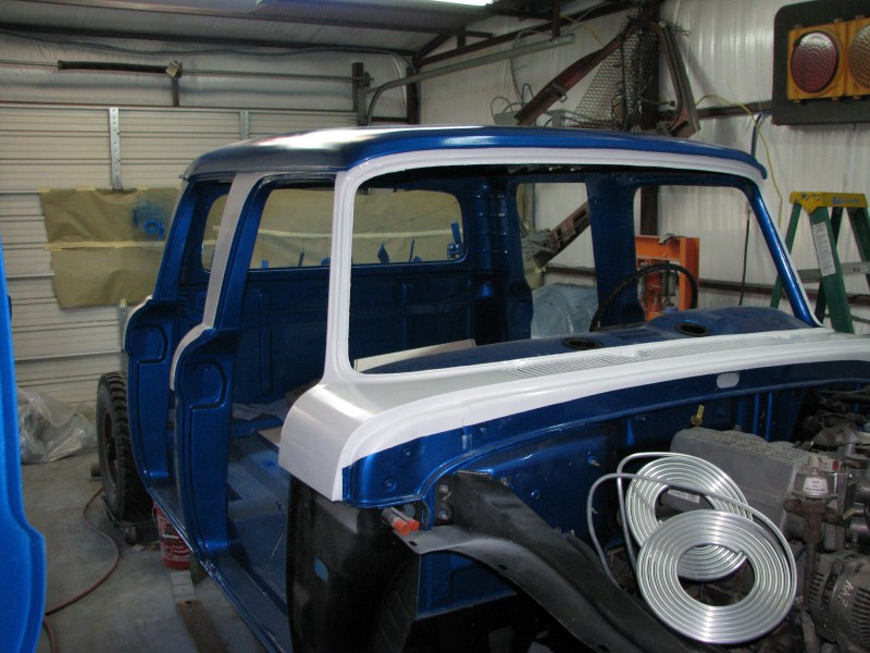

Finally done with paint. For the most part. Thanks again Gary...

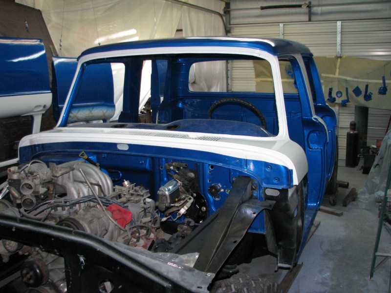

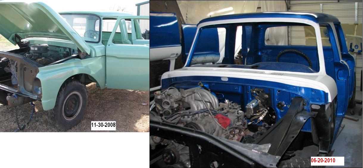

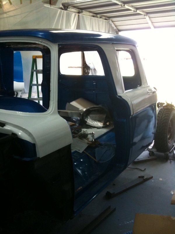

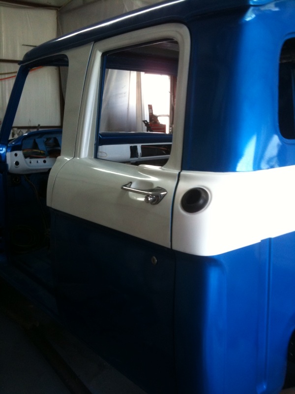

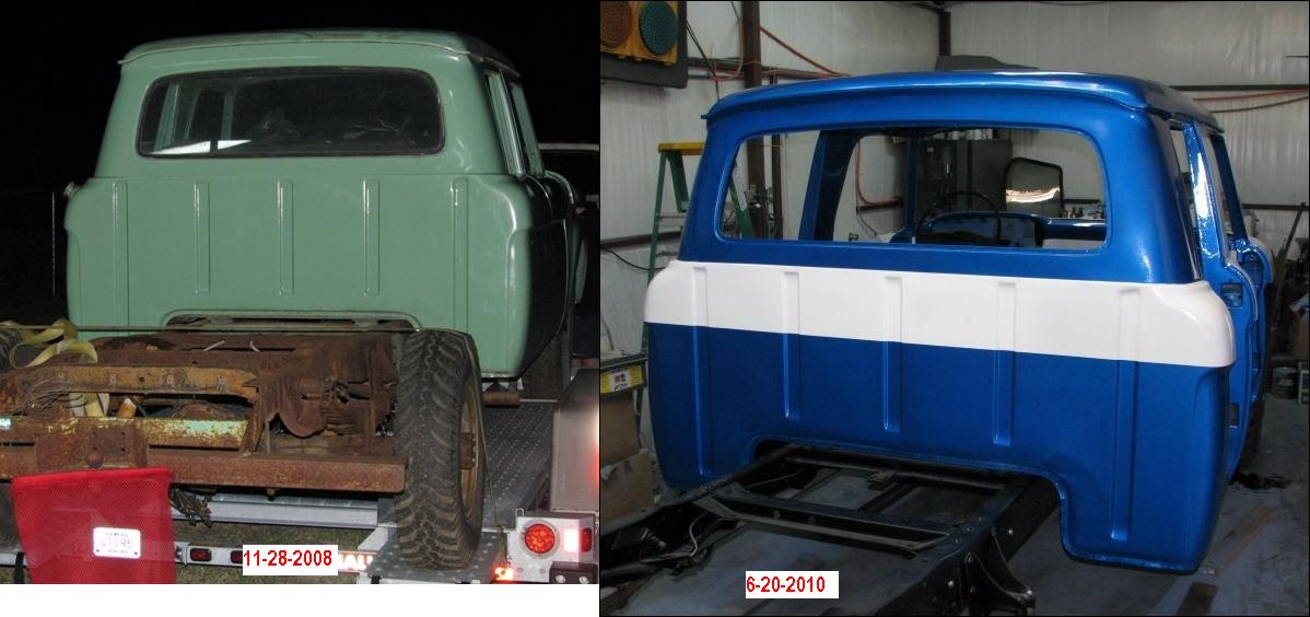

Since I was getting tired of looking back at orginals pics then the new ones I created the following 2 pics. enjoy
#1
#2
Posts: 5441

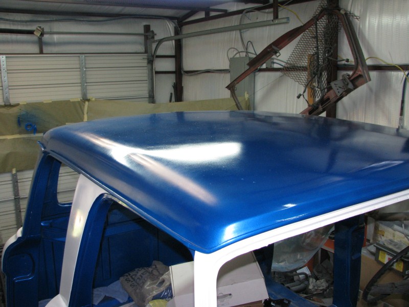

Guys if we do that it will need to be later in the year when the temps are in the 65-75 degree zone. Shooting base/clear in 100 degree temps is "Challenging" at best. Got a lot of fine sanding with 1500 to get some of the surfaces slick. Clear wants to dry way too fast and is a bit of a problem when it does. Even used the slow dry reducer and it was flashing fast. Once it is cut and buffed it will be fine. I couldn't see the pics either Chris. Will check on it at home and see. TR
crew pics
Pics finally came through tonight, Chris. Love the contrast pics. Gone that far in less than 2 years, dang near like eating an elephant, one bite at a time. Glad to help buddy, cuz stuff like that is always a good time with good friends. We definitely need to try for cooler weather to paint the rest of it, don't ya think? I seriously do! Lol! TR old.gif

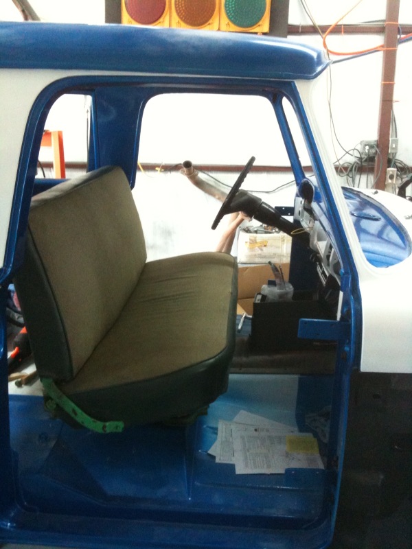

Got the shifter in the mail yesterday so I had to test fit it and of course I needed a seat to fully do the test fit. I really need to rebuild these ugly green seats but for now they will just get a cover. Good thing is I have a long 3 day weekend. :twisted: Goal is to fire it up but I will most likly get close to that goal.
This door has seal and locking hardware installed, even got the electric lock installed.
See what I mean about the green seat.... Felt good to sit in the seat again after all this time.
