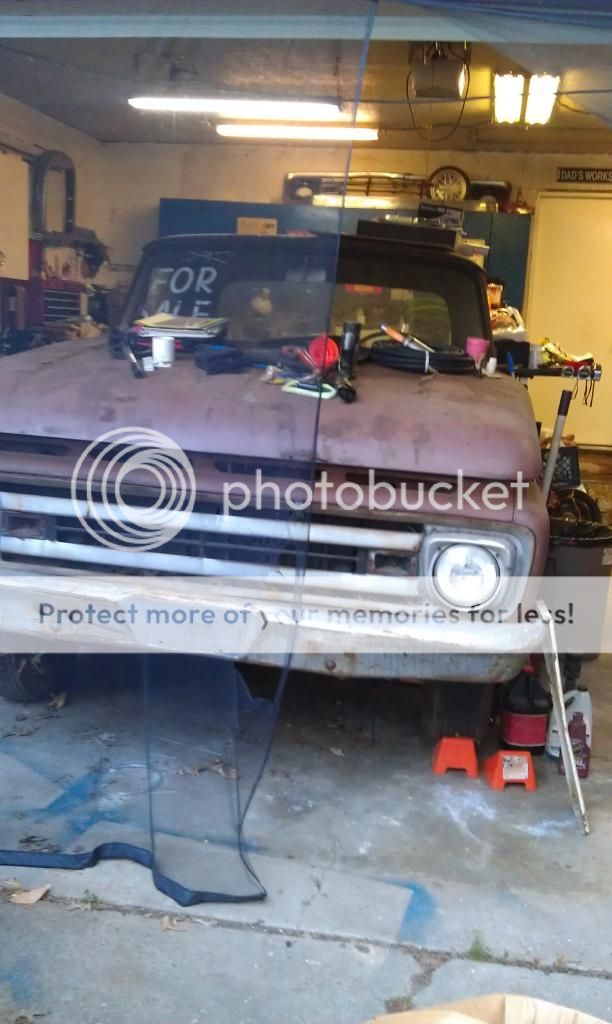

LOL they will be slow at first thats an older shot of the truck before I made the mistake of hiding it in the garage soooooooooooooo now I have to find it again . I hope to start pulling uni from uni chassis by next weekend and just listed the Vic on craigslist for selling off the parts I dont want . The Vic was a 2 owner low milage cream puff when I got it :D.

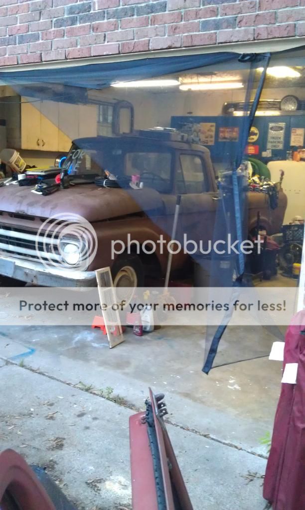

I get worried when the truck has been hidden that long in the garage and you didn't even get the FOR SALE wiped off the window yet ;)
It will be fun to see some progress.
Posts: 1394
Location: Louisville,Ky
Re: Yes another Crownvic/Uni 88 and 62
Post by rickairmedic »
Yeah I guess its about time I scrape that off the windshield :D. Geeeesh I had to break out the razor scraper on it they painted it on the windshield :shock: .

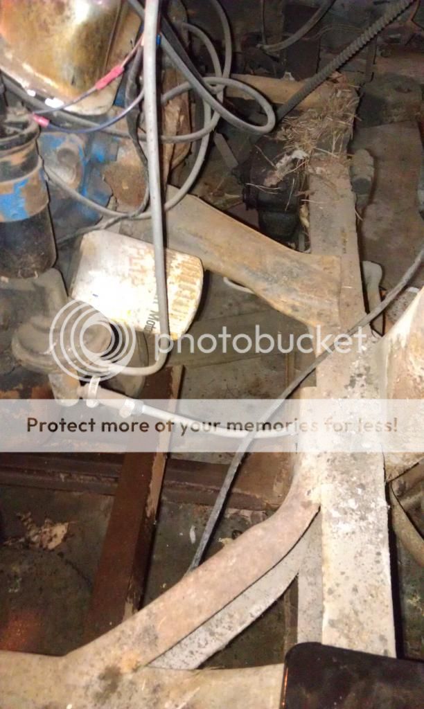

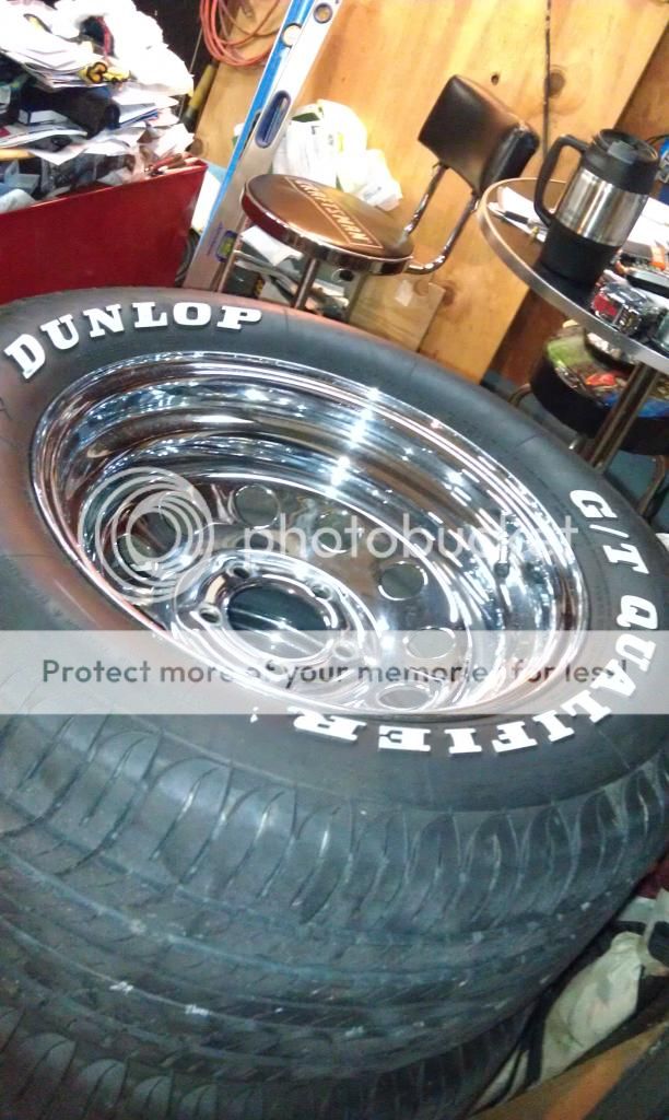

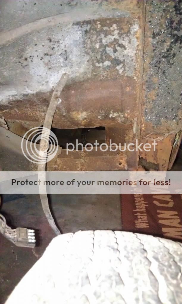

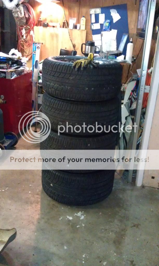

Well neighbor helped me lift the front clip off tonight and I also went and picked up some wheels and tires :D . Rims are Marsh racing technologies 15 X 8 and 15 X 10 with 265/50/15's for fronts and 295/50/15's for the backs . I made sure to get a couple decent shots of the front cab mounts ROFLMAO and also one of the um uh engine mounts :D.
