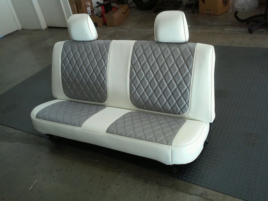

got the seat back. Dave Damitz upholstery in Tucson did it for me, ended up with 4" foam on the bottom and 1" foam for the back. Plus he uses about 1/2" in the cover for the pattern. originally I had wanted 50's style diner metal flake vinyl, but found out that doesn't hold up very well. so, I used boat vinyl instead which should last well. I'm really happy with it.

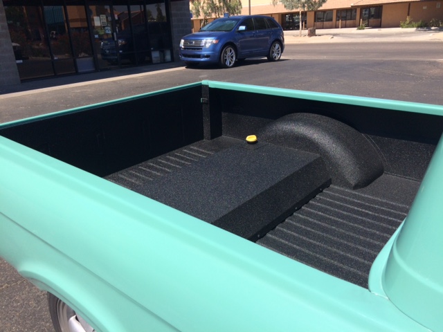

line-x bedliner. came out great. 150 miles on it now, drives great.
The cab has zero foot room. that is really the only thing I'd change, but I really can't see much way to gain any more room. I've got the pedals at one end, and the seat at the extreme other end. I'm not a tall guy, maybe someday I'll cut the footwell out and move it forward about a foot.

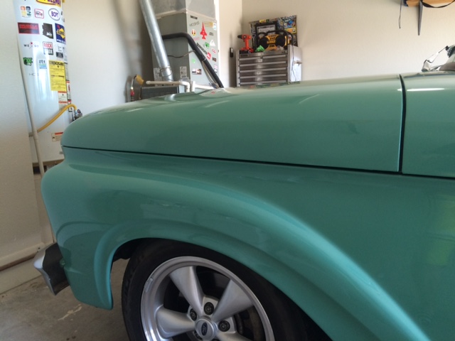

worked on the hood fit quite a bit. it's really nice now, totally happy with it. I guess my original hinges are in pretty good shape after all.
