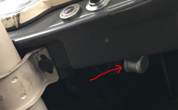

Thanks all for the help.
Which one is the turn signal flasher?
or
Dave

The bottom picture is a flasher. The top picture is a condenser.

ThinLizzy13 wrote:The bottom picture is a flasher. The top picture is a condenser.
There doesn't appear to be anything connected to the condenser, and I don't see it on the wiring diagram. Probably a left-over from something? This used to be a military truck.
Dave
