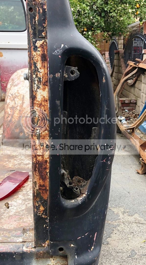

At some point before I owned this truck, it was hit in the right rear tail light.
The repair was not very good. The light isn't straight, it's slightly tilted to the right and the outside edge is bulged out.
This has always bugged me. Today I was digging around in the shed and came up with this :)
If it's not windy this weekend I'll cut the damaged 1/4 end off the bed and weld in the replacement piece.
