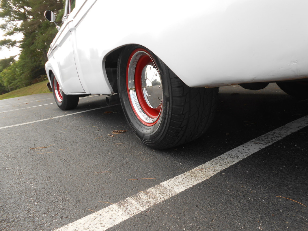

I'm running steelies that I purchased from Summit a few years ago. I forgot what the backspacing is, but with the 275/60-15 tires I had about 1 1/2" of clearance on each side. I want to keep my wheels. The '77 axle is 5" wider than my stock '64 axle....66" verses 61". That was the measurement from the outside of the drum to the other drum. Sooo....I'll kinda keep my eyes open for either another axle or a "chunk" for my original axle.

I think that the '77 Dana 44 axle would have fit under my truck, but I would have to change my wheels. I like my wheels. I don't want to change my wheels. It would make me sad to not have those wheels on my truck....
So I will keep my feelers out for another Ford 9" with the gear ratio that I so desire....it's out there.
Stay tuned...
