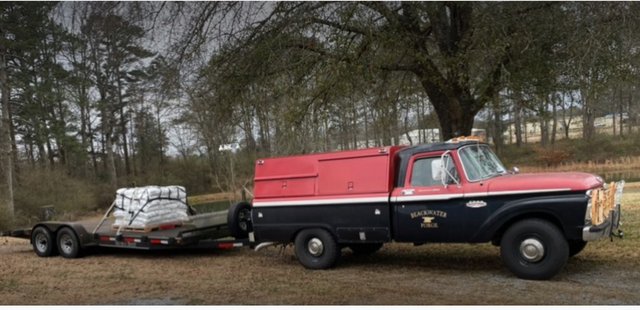

Re: How Much Tongue Weight Can The Frame Handle?
]This skid is 2600 lbs.
Trailer is about 2-2500 lbs
Probably 6-700 lbs young weight.
I have had 4000 lbs on this trailer with zero issues.
F-250 extra leaves in the rear.
Cummins 4BT Borg Warner 4-speed with Watson O/U/D
Tried to add photo but it wouldn’t let me
here ya go
