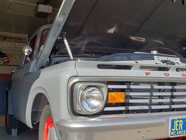

Shipwrecked is looking good! Hope you can overcome the engine knock soon. I like the hood kit, would you recommend it for others?

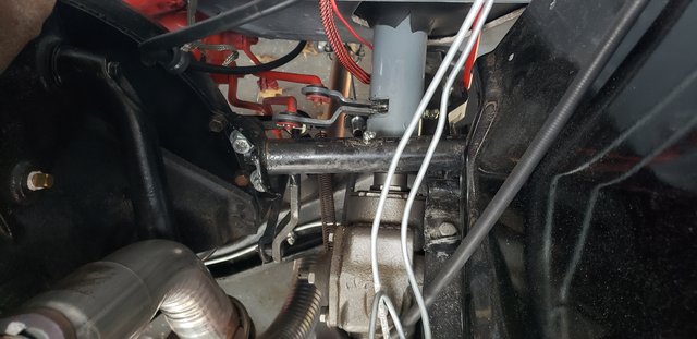

Im pretty sure I have my transmission linkage backwards.
When I put it in 2... it goes to Reverse. When I put it in 3, it is 1.

Pretty cool that you finally got to move it under its own power! That shift linkage can be a bear to adjust. I just watched your video and I’m not sure if I missed it, but it looked like you didn’t have the vac gauge hooked up? It can be a good insight into if your issue is a valve/rocker issue or point towards your bottoms end. I’d do that before dropping the pan .02.

Today I am going to figure out these shift links.
My last attempt at this, I found that my shifting pattern was completely backwards. So= I will see if i can hook those rods up the other way.

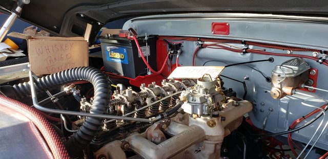

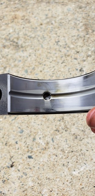

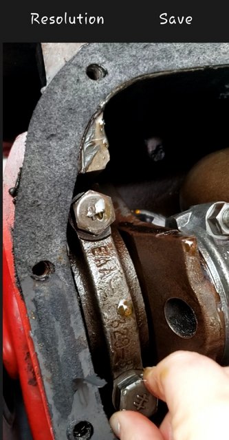

Pulled the oil pan. Started inspecting all the rod caps and then found the forward crank cap finger tight.
Whiskey tango foxtrot!
Way back like two years ago, remember the exhaust valve seized due to the oil tube slipping and the valve didn’t get lubricated? My buddy Jim had pulled the cap off #1 piston, but I didn’t know he pulled the #1crank cap too! I never torqued it again. I know for a fact I torqued it when I assembled the engine in 2017!!!
The engine just wasn’t working right since that exhaust valve and subsequent cylinder head bolt fiasco.
Here’s what I’m gonna do... tongue it back down. Put the pan back on. Put some oil in it. Run a compression test and a leak down test. Go from there.

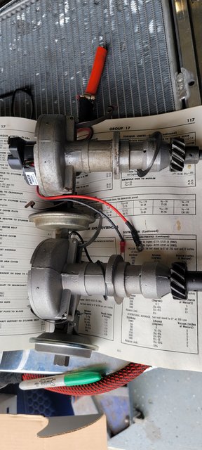

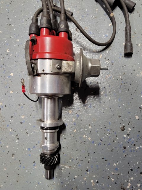

Found the 300 distributor I got from that dude up in Fredericksburg. Don’t know if it’s any good, but will check it out.
I bought a new 223 distributor just to try this first.(with my pertronix)
Will check the gap with a feeler gauge cause I just don’t trust that plastic piece they sent. I don’t have the right feel.

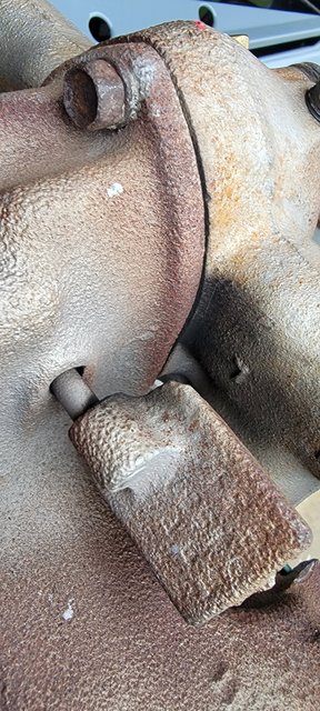

Did I have a vacuum leak that is causing my loss of power...possible,

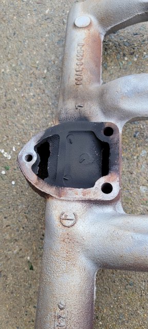

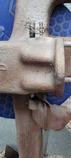

Is my flapper in the exhaust causing issues. Probably. (The shaft is there, flapper there, but the spring is gone, and I wired it open. reconsidering my exhaust manifold. My Jeep has a similar set up, and they sell replacement systems. I can probably adapt that Jeep style to this f100.

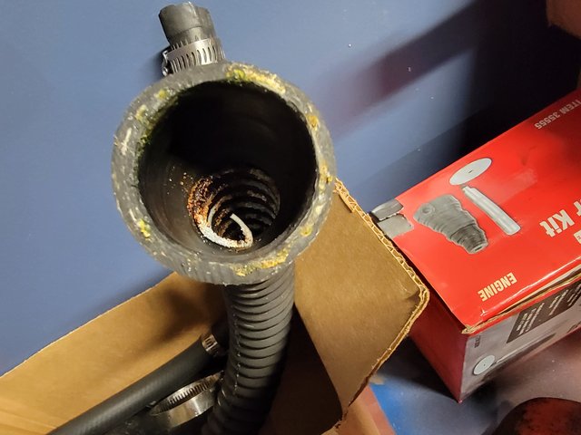

Am a week away from sailing a shakedown (wtf- I’ve only been home 6 weeks) so I was cleaning the garage up for a professional foundation company to come and fix a void I have under my garage. I got tinkering on the truck too.
I drained my gas tank. Souls have done this months ago. Sure smells like turned fuel.
Of course I made a giant mess.

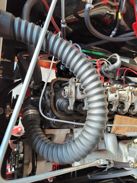

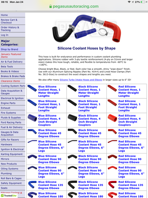

I knew the flexi hose was supposed to be temporary, but it’s lasted longer than any relationship I’ve ever had. BTW, head had that rusty stuff... goo... I only ran green coolant in there, which makes me wonder where it came from. Maybe the engine passages. Either way, I’m leaning toward a cleanout again.

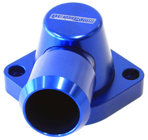

The thermostat housing is clocked towards driver side. The radiator is a 63 replacement which is on the passenger side. I am looking into options.
I did find some swivel styles for Ford- doesn’t say if it will fit a 223. I guess I’m not sure if the bolt patterns are the same.
Also been looking at custom silicon radiator hoses over at Pegasus.https://www.pegasusautoracing.com/advca ... eoQAvD_BwE

Not sure if you've shipped out yet but its hard to keep the gunk out of cooling systems that contain large pieces of cast iron. Driving them helps but it takes lots of cleaning when you rebuild a 50-60 year old engine that has already been rusting inside for that long! Anyway, I like the silicone hoses and notice they have red which could be very complimentary to your engine compartment. Best wishes on your deployment, looking forward to a safe return for you!

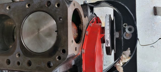

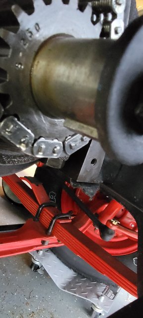

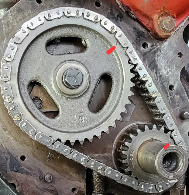

spent time in the garage with my ass side to the rain with the garage door open.
I am bringing it back to basics to take notes, document what i am doing and figure out why i had this weird ticking and loss of power.

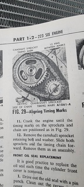

I took the harmonic balancer off. I must have dented the shit out of this timing chain cover when I was assembling the engine 5 years ago.
(remember I haven't been able to drive this much {a few times up the street and back} in the last few years)
I was in a little hurry 5 years ago. I remember assembling parts to this engine at night in New Jersey before I had to pack the truck onto my trailer and move to Virginia.
I spent some time beating the dent back out, and resealed it.
checked my timing. its right.
looking at my damper,
the keyway is what I would see on the photo from the tech pub. However, if I were to put that on my crank, the keyway is about 180 out.
There is only one way to put the crank sprocket on because it has it's own keyway.
Something just doesn't look right here compared to the photo in the pub. but the pub could be generic for a ford just to show timing.
There is a pointer on the timing chain cover. Does not match up with the damper.
I had that damper rebuilt by Damper Doctor a few years ago. It has had maybe 2 hours tops of run time on it since 5 years ago.

so looking around ford truck enthusiasts sight, and i found this photo.
The crank key is in the same position as mine- timing same as mine.
Maybe mine is not wrong?
I don't believe the damper slipped either. It was redone by Damper Doctors and i checked old photos of when it was received back 6 years ago- looks the same now except paint wore off.

I decided to take the head off.
#3 has a nice pool of oil. on the gasket too- it had a lot of oil in that exhaust valve corner.
a while back I had purchased a replacement 223 distributor. It needed it! I took the old one, press back and forth on the shaft and sure enough- clunk clunk clunk!
Switched all my pertronix over after this photo.
It was easier to install in the engine that the old worn out one! Like lightning fast compared to the old one.
I had Damper Doctor do the rebuild on this damper. it had all the timing marks covered up with paint and I never saw them.
But- now that i sanded them off- you can see them. The keyway installed and I put the damper on. When it is at the TDC on the damper stamps, the #1 is actually at bottom.
I put the MSD Sticker on this and at 0, I am at TDC.
see what I see?
Also- what should I do about that dang Heat Riser? The stud it has is so worn out that I can not put a new spring on it.
I just wired it in position to shove all exhaust down to the exhaust pipe.
see what I see?
