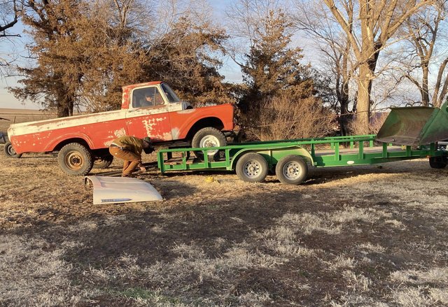

Well …
This one won’t get finished by me :?
But I sold it to a nice young energetic fellow from Texas
It was a good start
And I will be glad to see it finished
Just have too many things on my plate
And no reason for it to just sit
I didn’t lose any money :2cents:
Can direct my energy into other projects :mrgreen:
