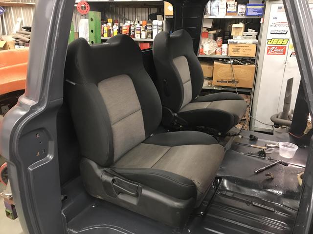

Ok this is long overdue. Picked this up at a local scrapyard in 2017. Had been looking for something to make a daily driver out of and a friend found this one. It's a 63 wrong bed (or what was left of one!) 223/3 speed that someone brush painted with some unbelievably tough orange paint. The drivetrain was removed along with the front suspension and sold. A Mustang II front suspension has been installed, the frame boxed, and a truck-arm rear suspension fabricated. A 351W/T-5 have been rebuilt and set in the frame. The rust repair on the cab is completed and it is in epoxy primer. I picked up a pair of bucket seats at a swap meet years ago and finished up the brackets for them this weekend. Waiting for seat belts to arrive so any extra plates/etc. that need to be installed can be completed then I'll shoot the cab bottom with undercoating and get it on the frame. I don't have too many photos and the frame is in a buddy's barn so after it gets back home I'll get some.

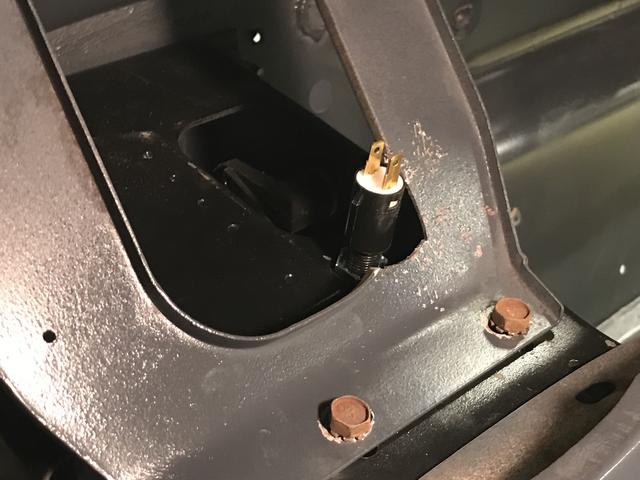

Thank you for the all the kind words! It’s still a 10 footer and that was the original plan although the bottom side I did/do want to be nicely finished. All the cab work has been necessary because it was missing most everything from the seat risers down! Completed a few little projects yesterday and today. Installed a plunger-style brake light switch (still need to dress up the area that was cut out of the brace:

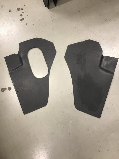

Had some scrap pieces of ABS and wanted to make kick panels so got them cut out and fitted. Still have to cut the hole for the “floor-level air conditioner unit” on the passenger side, but they turned out better than I was expecting:
<a href="https://postimages.org/" target="_blank"><img src="https://i.postimg.cc/gktLR9z0/E688-D4-E ... 476-D7.jpg" alt="E688-D4-EC-381-B-4-D15-B85-A-6319-BAF476-D7"/></a>

Brake light switch

Kick panels

Looking good, i have to come over and see how you did the brakelight switch. I have to do something similar. I assume the brake pedal hits the front of that switch the way it is mounted? Previous owner has a switch mounted with some god-awful bracket that was screwed to the firewall.

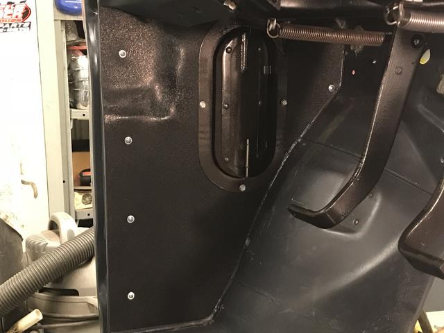

Still piddling around with small projects, waiting for a warm dry day to "undercoat" the cab so it can go back on the frame for some mock-ups. Cleaned up and replaced the seal on the driver's side fresh air vent and finished up the kick panel on that side. I'm pleased with how it turned out, hopefully the passenger side will look the same. Started cleaning out the heater box and the heater core looks pretty good but want to have it tested before putting it all back together. I was very surprised that there are no replacement heater cores available for 61-64's. IF I am mistaken, please let me know of a source!
Here's the kick panel and vent installed. The bolt place only had plated screws so these will be blasted and black phosphate coated at final assembly.

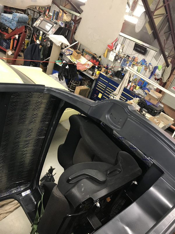

Not a lot of progress to post lately, this work thing been getting in the way, but thankful for my job. Started putting sound deadner in the cab. Using Rattletrap, made by Fat Mat. It appears to be very good at getting rid of the “tin can” sound inside the cab. It is easy to work with and I’d recommend it if you are wanting a queit interior.
Still have about half left to do but you can barely see it behind the seats and on the roof.
This was going to be a seatbelt test but I couldn’t find a volunteer.

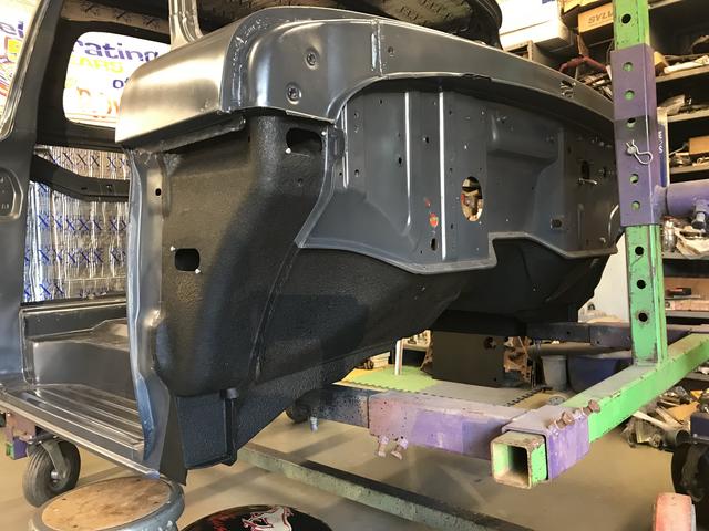

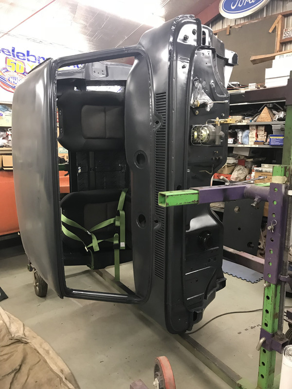

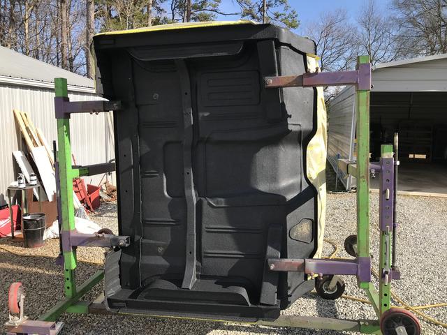

Blessed with a beautiful day here. Taped the cab up last night hoping for decent weather today to spray a rubberized coating on the bottom side. Pulled the rotisserie outside after church and applied two quarts of coating. Very pleased with the texture and coverage. Hopefully it’ll be tough.
Bought a cheap schutz gun and sprayed this
Here’s the underside
A corner shot

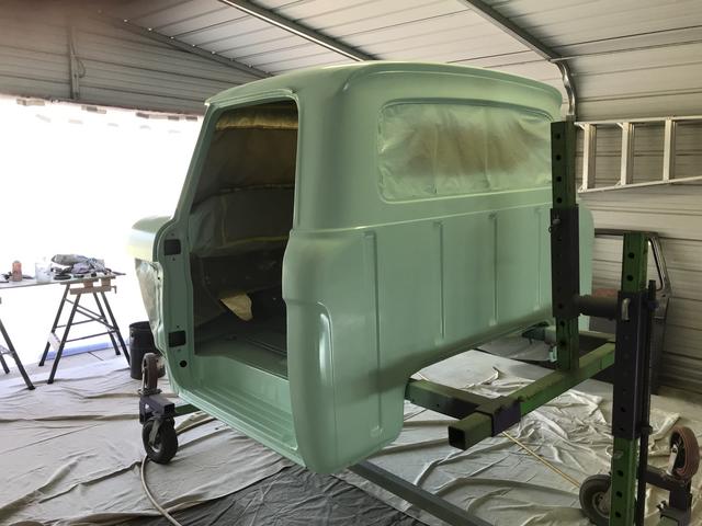

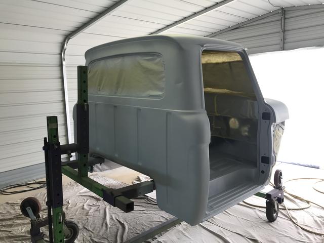

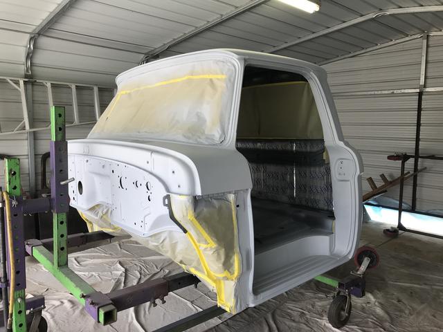

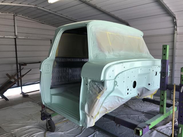

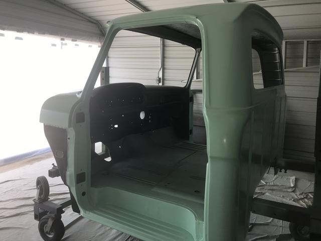

Well the stars finally aligned the end of last week and made a little progress Friday and Saturday.
Put a coat of light colored sealer on it early Friday morning:
Saturday morning the color went on. It is a fleet color from Delfleet just called "green". I really liked to sample chip but looking in the can I had some doubts!
After it started going on, it was exactly what I had seen in my dreams :D The bad part at that time was the dream had it as "suede" so flat clear was purchased with the paint and I was torn about grabbing that can of leftover gloss sitting in the garage! There wasn't any real bodywork done on this cab so I knew the flat would have to be used but dang it looked good wet!!!
After the flat and unmasking. The flat isn't real flat so it still came out with a little gloss.
