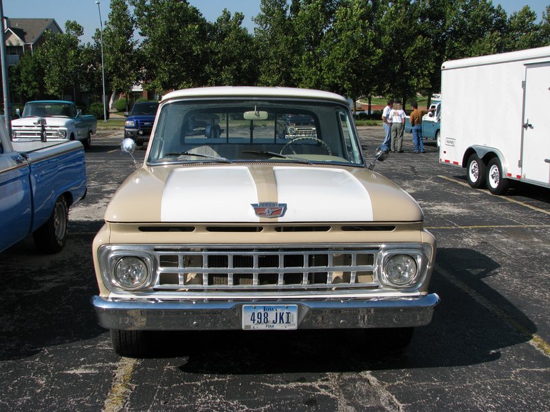

I removed the upper valence on my 65 and put in one from a 63 and I put the turn signals in the headlights. I bought them at a Goodguys event but I am sure you can get them about anywhere............Kid

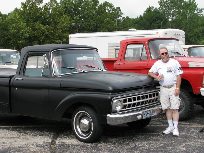

this is Gerry (casey65) s truck and him
this is Kid's truck with the signals IN the headlights... look close and you can see em
