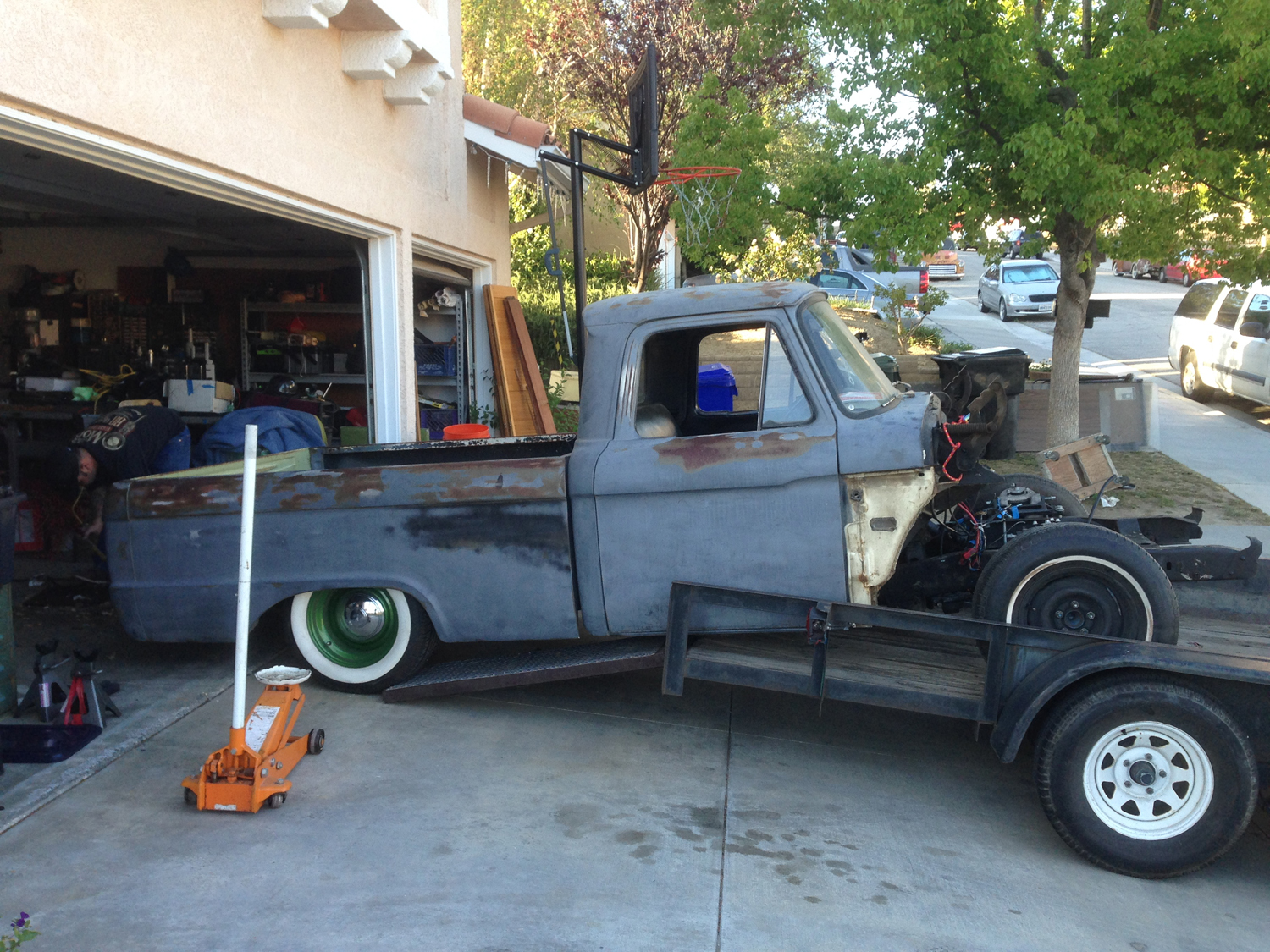

302 in the back of the pickup - Needs to be in the front!!!

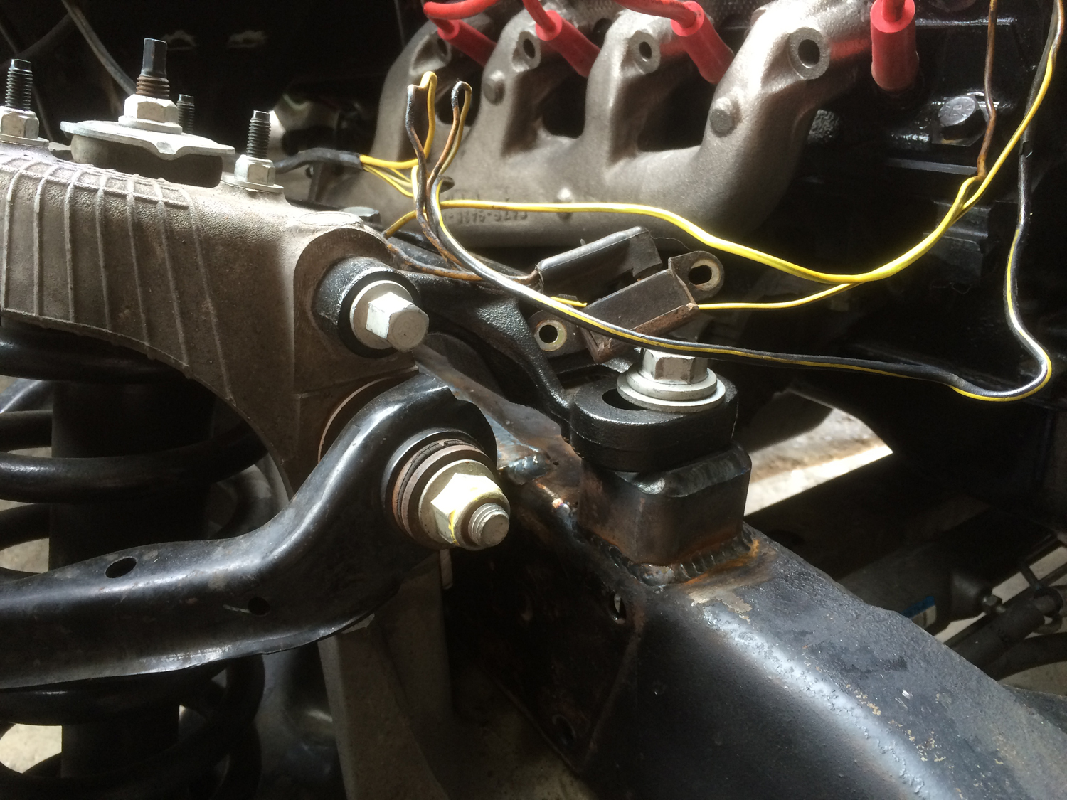

Empty engine bay. Notice the white trans mount - it was made out of an old floor jack handle. wha.gif

Spacers welded in for front suspension - Awesome welds!!! Angle iron added to strength under the brackets.

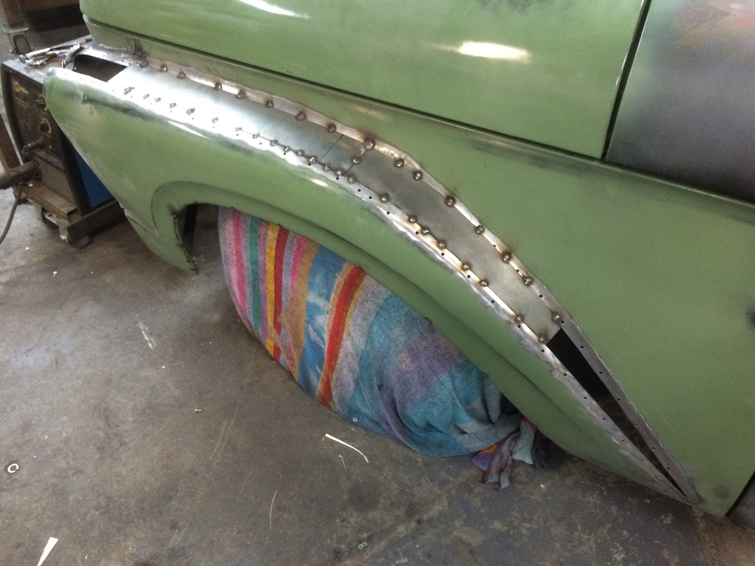

December 2015 - Got the stance right. Cut the front fenders for turning room. Added @ 2.5 inches of space.

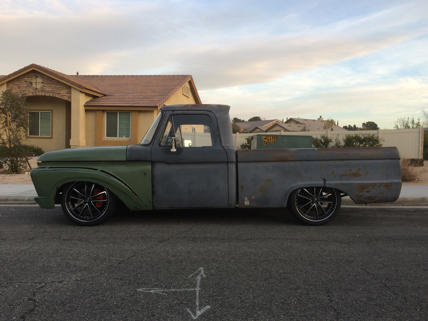

Got the rims and tires mounted - 245/35-20”. Running the stock 9” right now with 2” wheel spacers to match lug nuts on the Crown Vic front end. Eventually, I’ll install 8.8 rear axle.

Side View

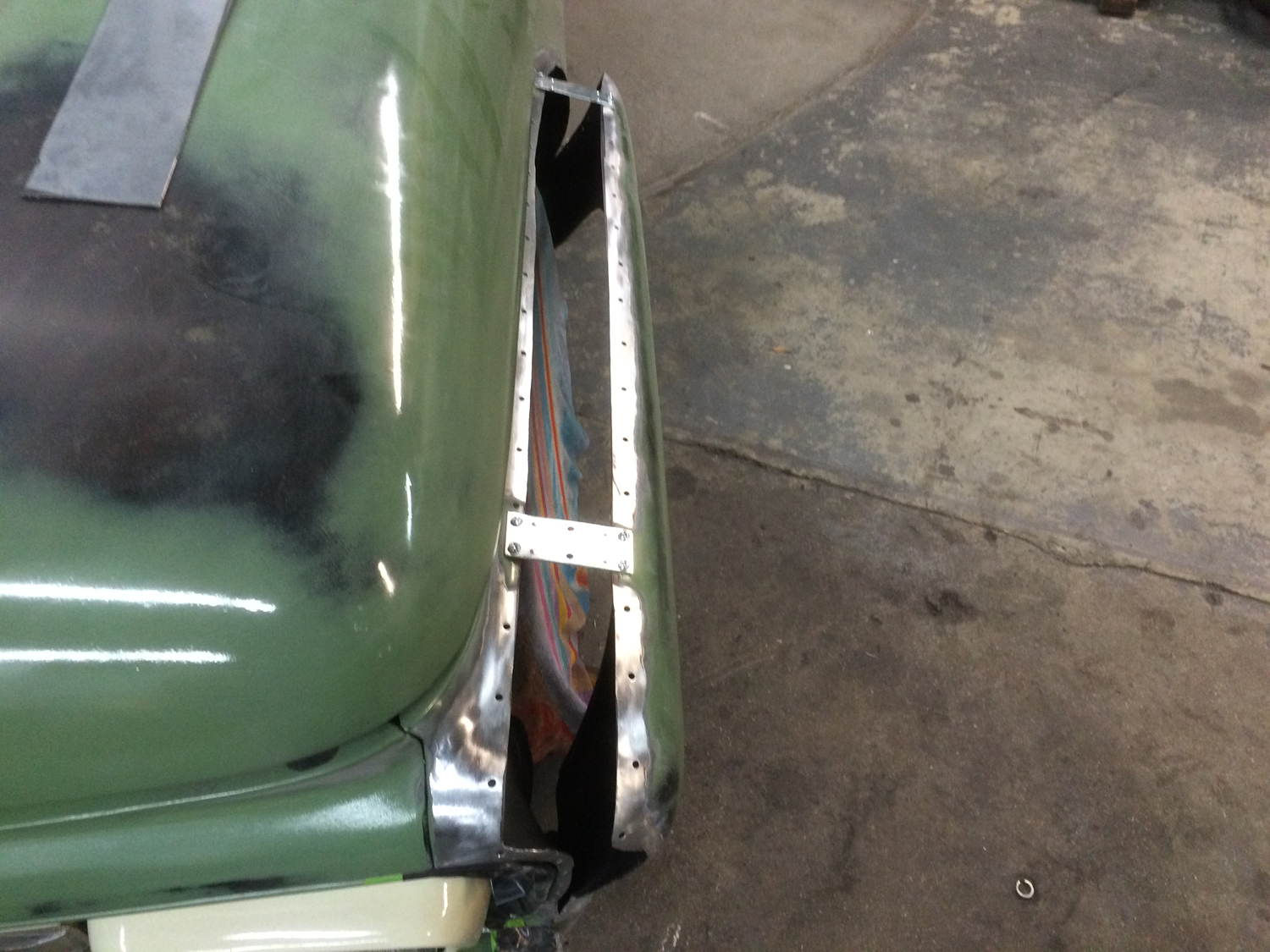

Welding up the openings at my friend’s motorcycle shop.

Post by surfcanada »
Top view
Welding pieces in
surfcanada
Posts: 56
Joined: April 21, 2015, 3:16 pm
Location: SoCal USA
Re: 1964 Shortbed "Rust-O-Mod" Build
Welding done
surfcanada
Posts: 56
Location: SoCal USA
Front view of weld
